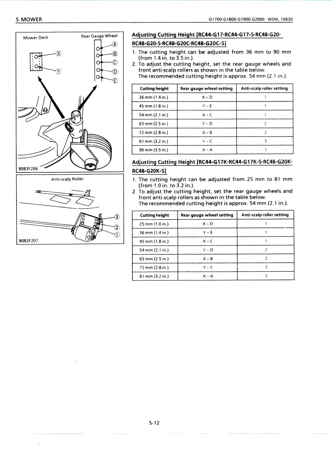

   / G1800 Deck #4
The adjustments are on the brackets that hold the anti-scalp rollers and two rear corner wheels onto the deck, There are multiple bolt holes for the rollers, and a shaft with various keeper-pin holes for the rear deck wheels on mine.
I've never seen a G-series Kubota deck without similar adjustments, but I'm no expert..
Originally, each deck had a decal showing a table of which combination of bolt holes and pin settings would give you a certain blade height adjustment.
That may be long gone if your deck is "weathered."
(I assume the owner's manual is gone, too?)

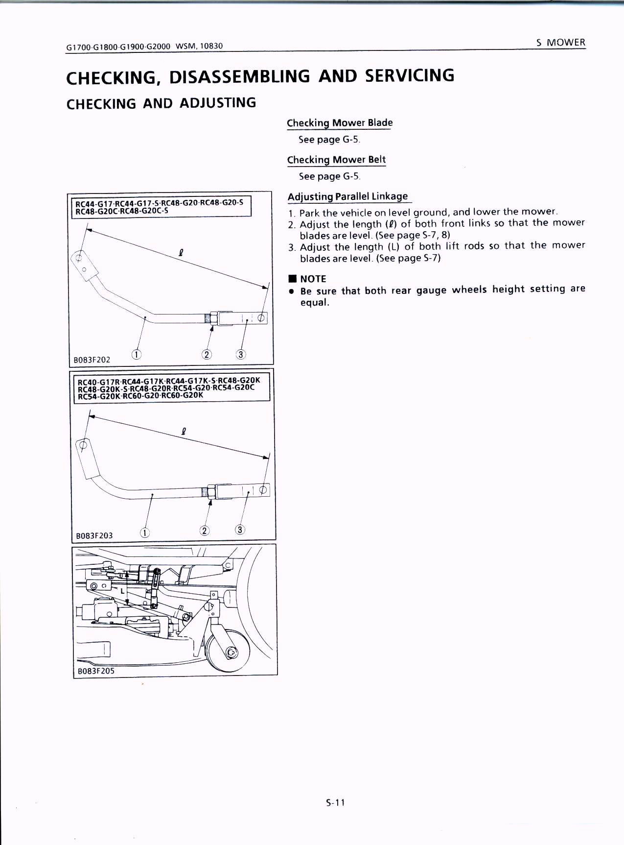

   / G1800 Deck #7
My Owner's Manual for the mower shows nothing about the deck since there are several deck options. The decks probably all have dedicated manuals. However, I also have the Maint. Man'l and it shows the deck adjustments for all decks. Here are the two pages for adjusting the 48" deck.

that's great jinman - thanks. I may ask you another question this weekend once I get in front of the mower and look at the deck and the diagram you provided.
