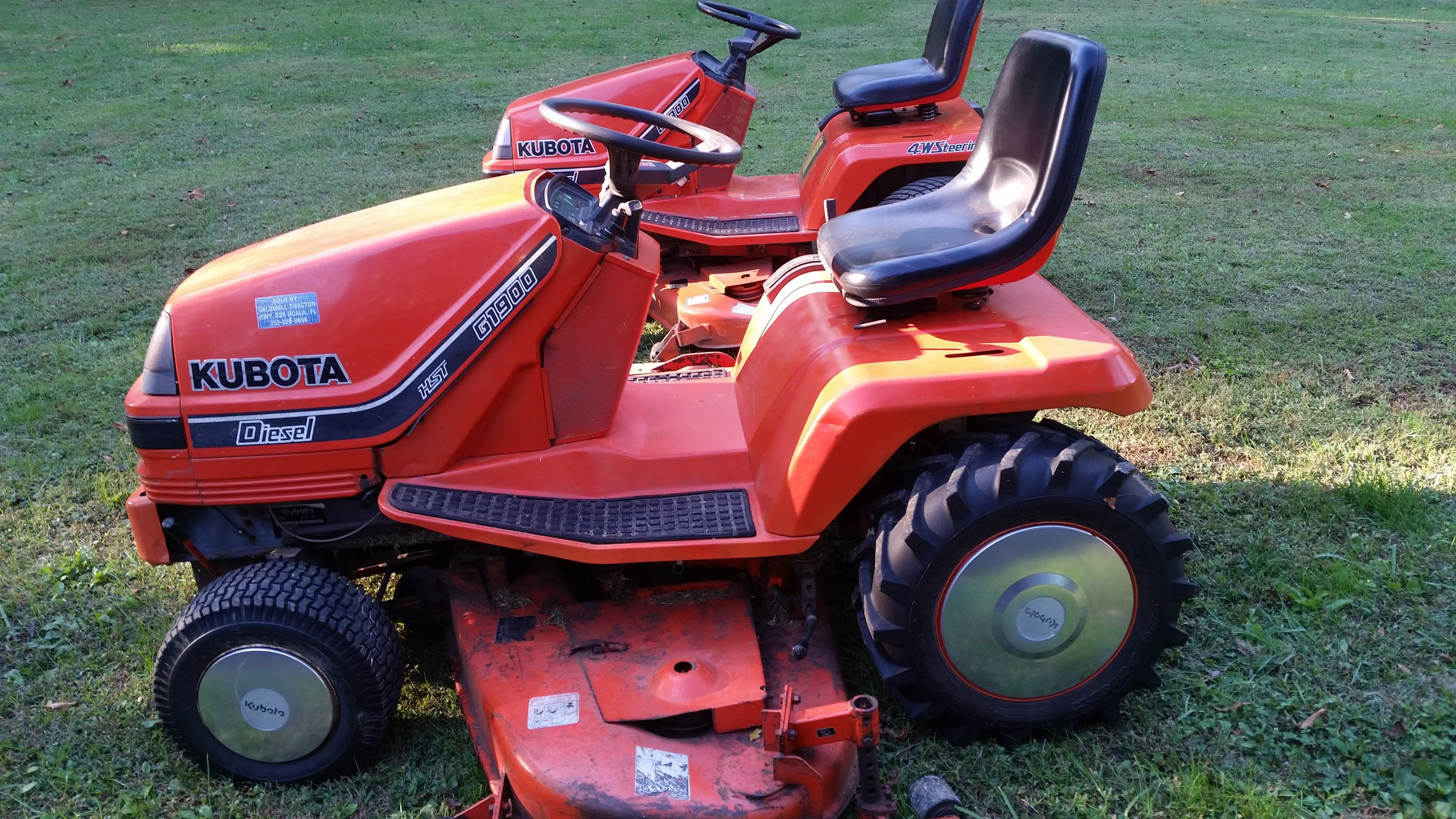

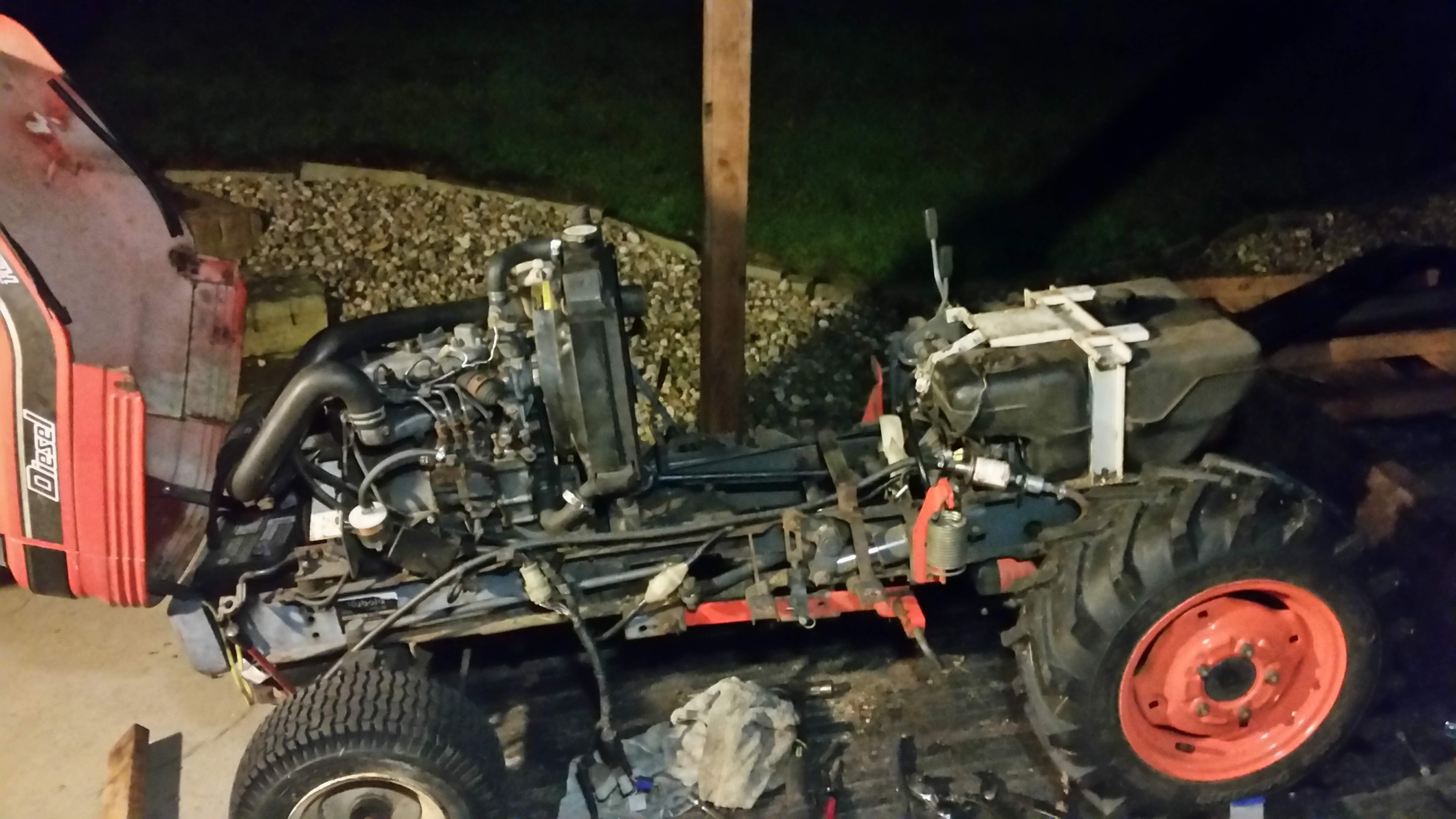

I recently bought what I thought would be a parts mower and it ended up being a much nicer machine than I thought (bought sight unseen off CL and had it shipped). I then nursed it back to health so now I have TWO mowers, and a new to me BX. I had a recent thread where I talked about my wife not being thrilled with this arrangement. Here's a pic of the mower when I had it stripped down to replace the steering box. Another if it after some attention and paint.
Obviously, I'm in the "it's worth the work" camp when it comes to these mowers. View attachment 444476View attachment 444477

On another note, are those ag tires on backwards, or do you know something I don't?
   / G1900 PTO shaft and other questions for new buy #5
I don't remember how much SUDT was when I bought it last spring. I remember it was enough to make me notice how much cheaper the Tractor Supply/Rural King "equivalents" were. Anything I know about hydraulic fluid I've learned from this forum. Do a search for "SUDT" and you'll have an evening's worth of reading.
I don't know anything about the ag tires so maybe they're on backwards? Guys at the tire shop put them on another machine so I copied what they did. It can't be MY fault! :) Are they backwards?

Typically the front of "V" is toward the front of the tractor where the wheel touches the ground.
Like a duck foot, walking forward. That way the wedge of the "V" bites into the ground. Switch around the rear wheels and that should take care of it.
