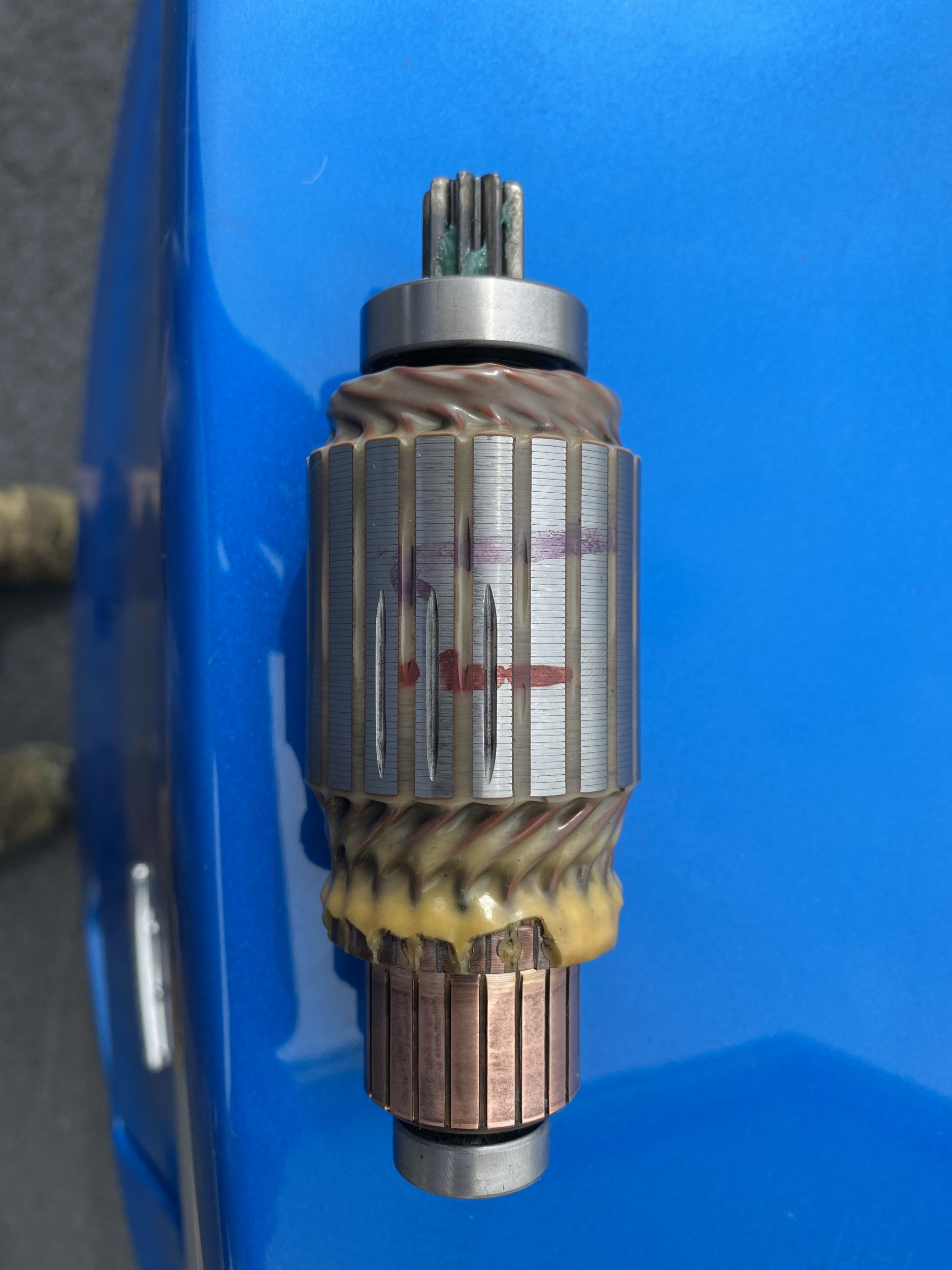

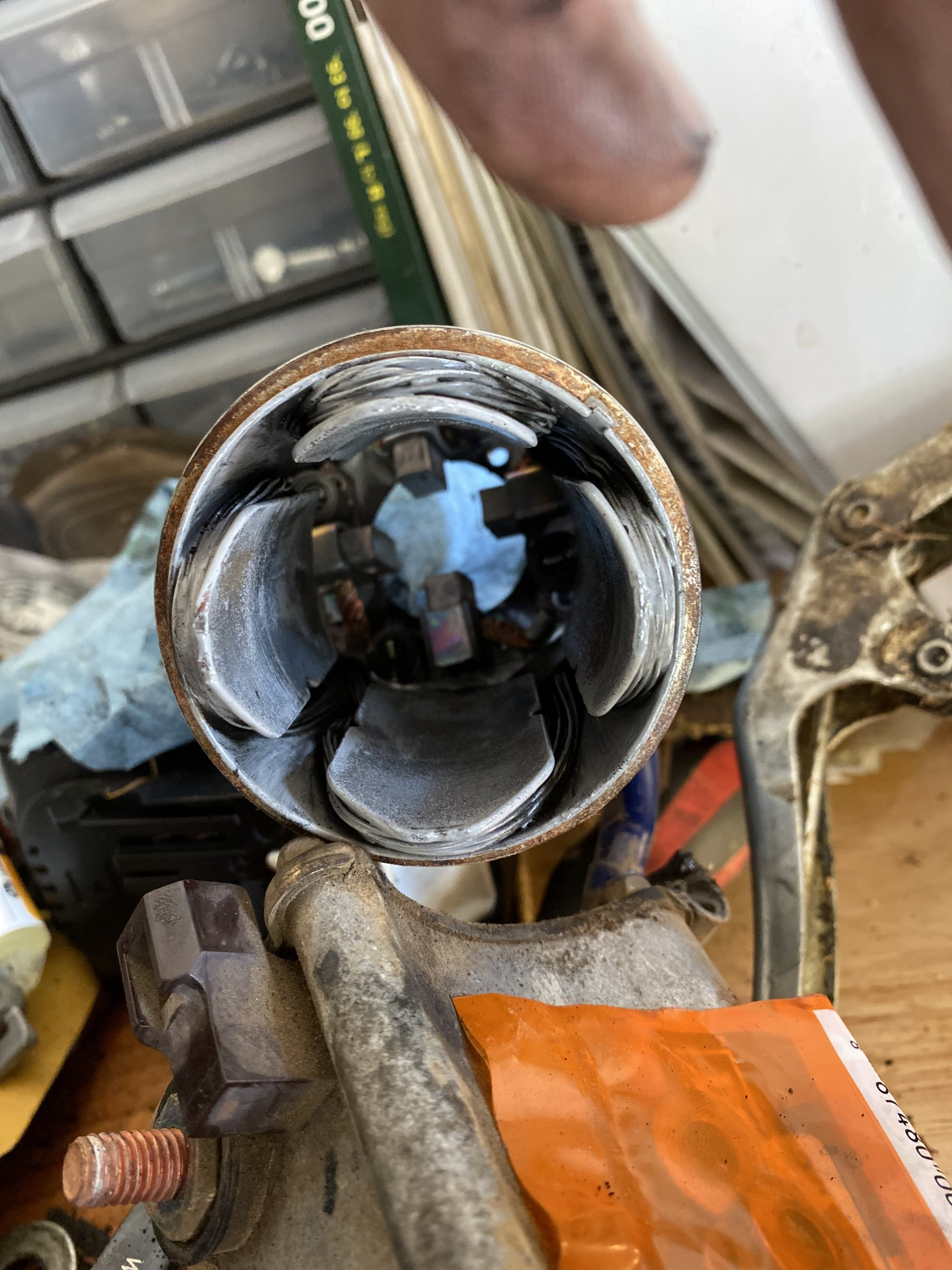

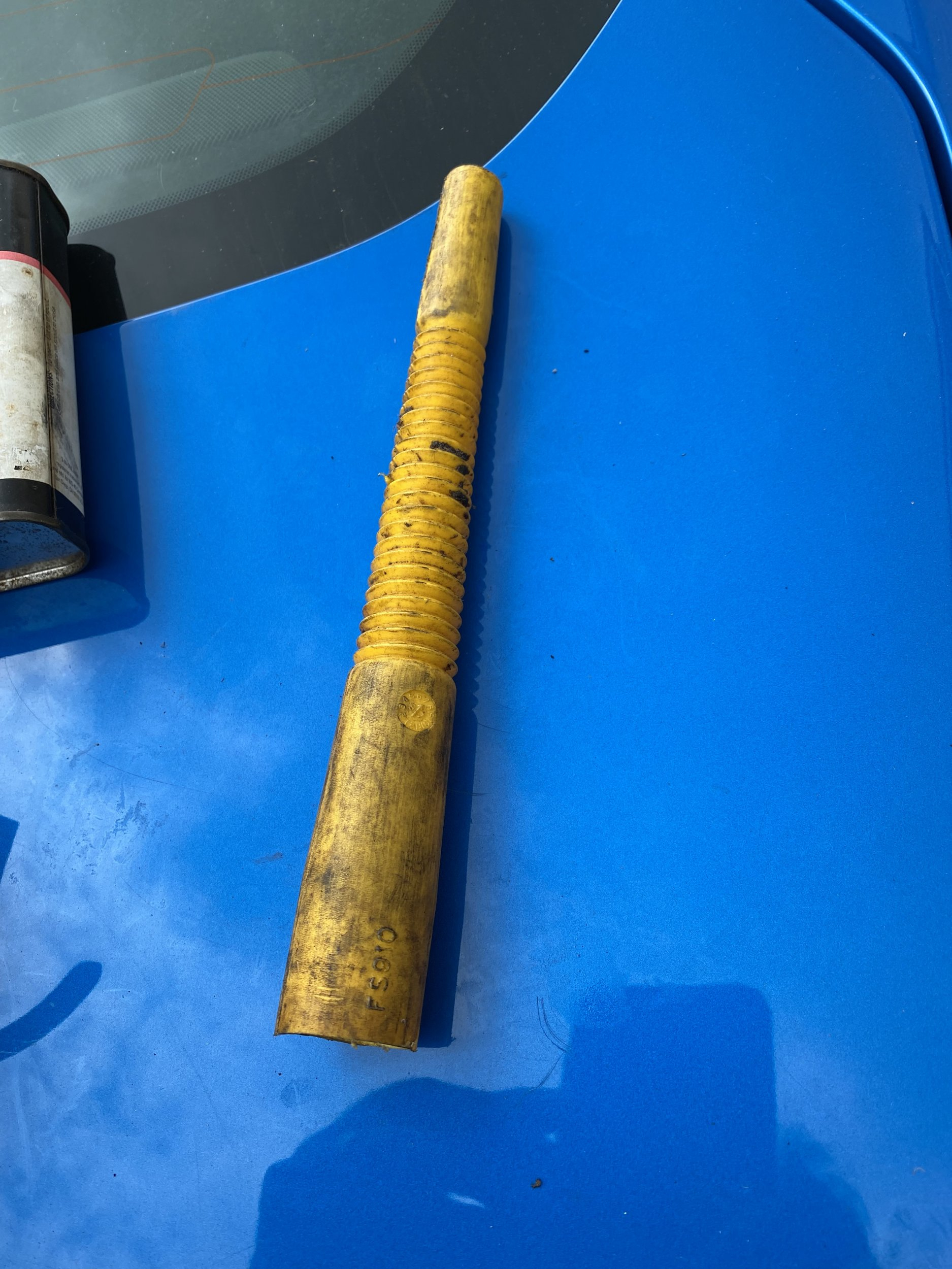

I tore the starter down today (armature side). It had some dirt and grime on most of the surfaces, which I cleaned. I lightly sanded the brushes and the copper body, as well as the interior field coils (2nd picture), which were a bit pitted. I pushed in some more grease into the bearings, and put a light coat of oil on rotating surfaces.
The only challenge (besides losing a dam screw for the top of it...aaarrgghh) was getting the armature back in the brushes, which are spring loaded. After flailing for a bit, I found that a gas can spout worked great (after I cut the lip off, 3rd picture) to push apart the brushes and let me push the copper body in.
I reinstalled it and it seems to work....3 for 3 in my test start ups. Time will tell if I solved the issue for good:) If this does not solve it I will get into the solenoid side next.
