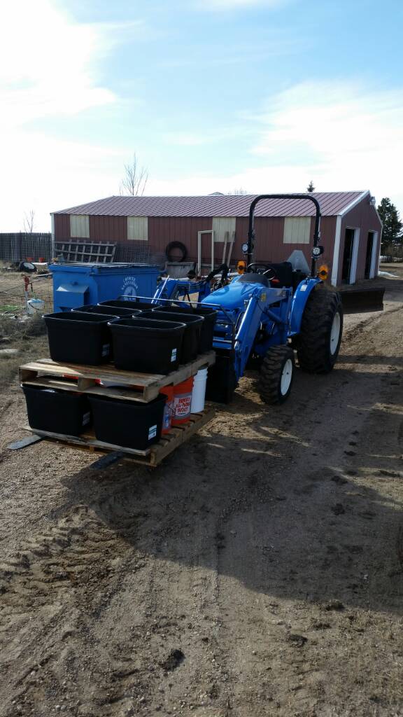

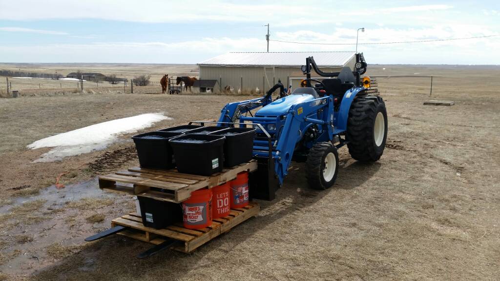

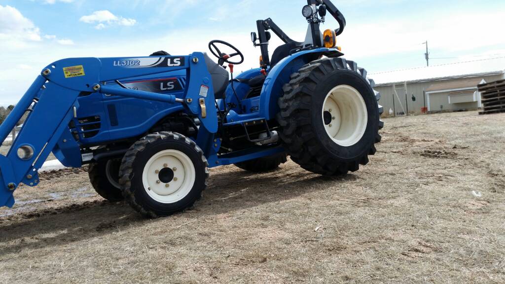

So I did a test today. See the attached pictures.
uploadfromtaptalk1456001876133.jpguploadfromtaptalk1456001889211.jpguploadfromtaptalk1456001898572.jpg
Basically there are 8 x 5gal buckets filled to the top with water and 6 x10gal tubs of water. I'm thinking this all adds up to about 850lb total, not counting the pallet forks. Water is about 8.3lb/gal, right?
The tractor had no trouble lifting the load but that rear left tire is clean off the ground.
I hear you guys loud and clear on rear ballast... But... I have folks here telling me that filling the tires ruins the rims. Does it damage the tires or wheels?

If you put 900 to 1000 lbs on the 3 point hitch up close or a little less in the form of an implement that sticks out and load the tires you will be much safer In handling the weights you have in mind. , especially if you put your ROPS up. That a way if you do flip it over your chances for survival are somewhat better. Also as pointed out, your front axle will last a lot longer. Look at your photos. Not only is your front axle carrying the load up front but it is now carrying almost the entire weight of the tractor on the weakest axle of the tractor.

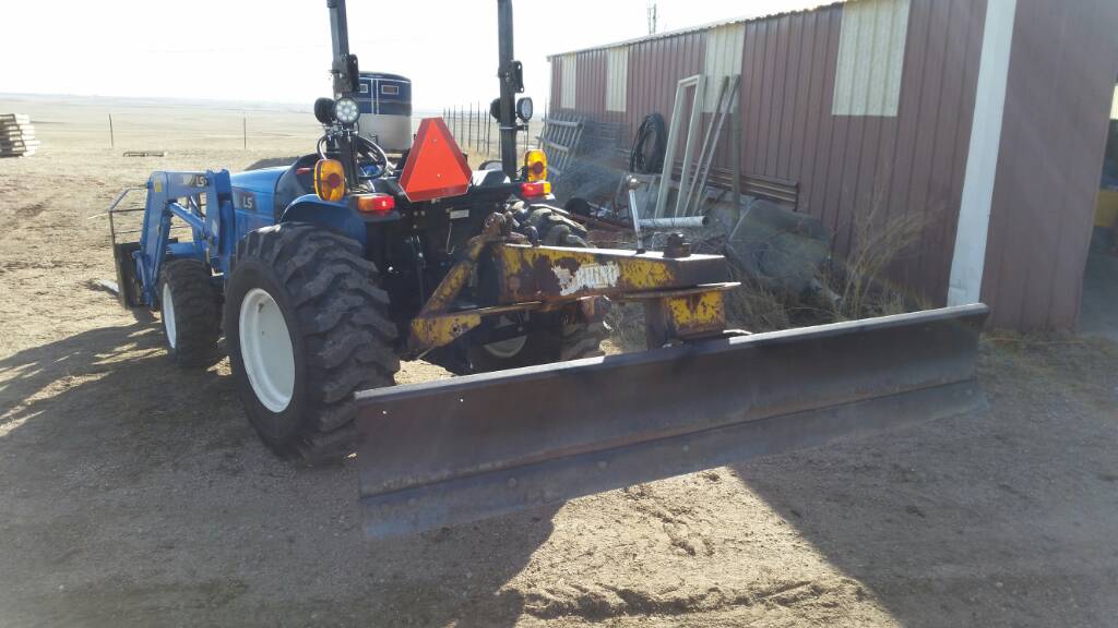

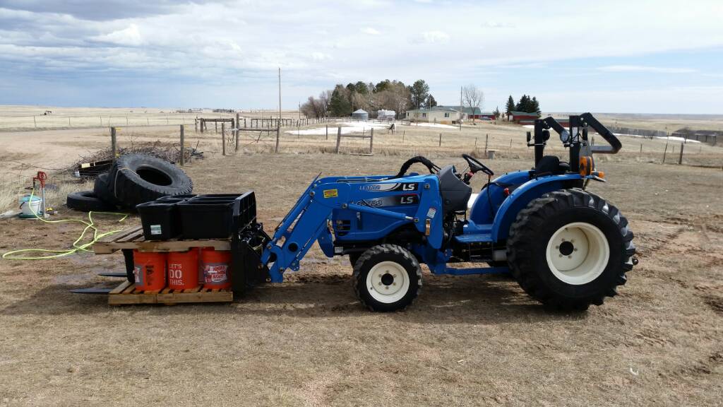

So I borrowed an old 3-pt back blade and retried my test.
So the water adds up to about 1,050 lb (125 gal) and the tractor is completely stable now that it has the rear weight from the blade. But the FEL won't lift the load any higher than you see in the picture. It just stops lifting. I couldn't even put the pallet on my flat bed trailer.
I dumped 160 lb off and I was able to lift the load as high as I wanted to. That put the weight about 870-900 lb.
So I guess the G3033 can lift 900 lb. And it's rated for 1600 lb at the pin. I'm a little disappointed but glad I know now.
I might still get the tires filled with Rim Guard but it seems that a 3pt mounted ballast gives me what I need for stability.
Any last thoughts? Do you think it can lift more? If so, how?
