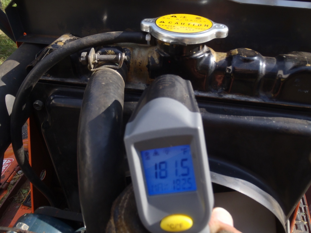

I've noticed the temperature gage has been steadily finding a higher max operating temperature over the past 2 years. Last week it overheated while The Plant Manager was cutting the not-too-long lawn on a not-too-hot day, so I decided to see what was causing the problem. After some testing with an IR temperature gage, I determined that the thermostat wasn't opening until the temp gage was touching the red mark, so I ordered a new thermostat & gasket.

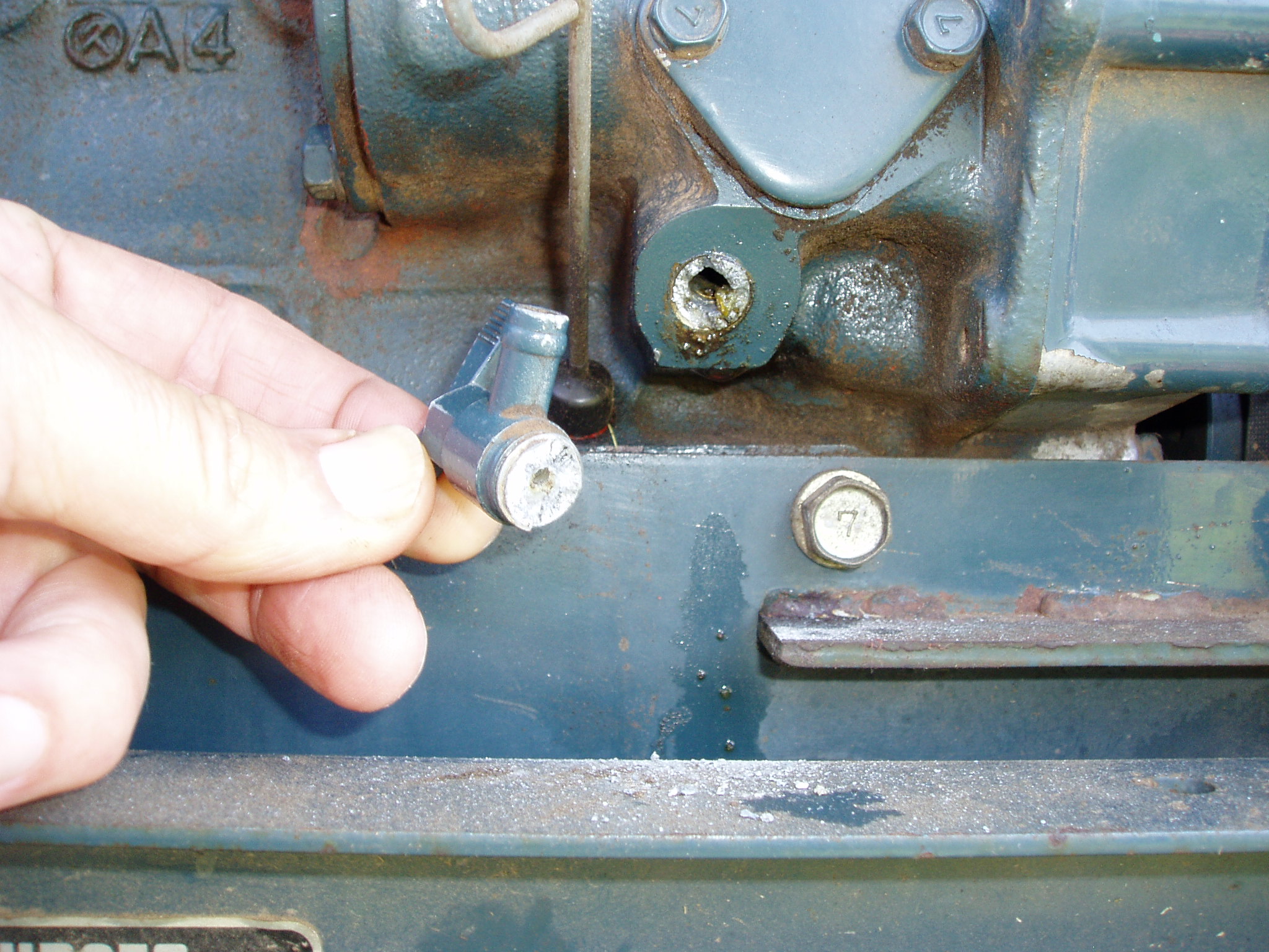

The old thermostat gasket was a paper composition type and had been RTV'd to seal it up. The new one is some kind of springy metal coated with a dark surface finish. Got it all put back together & it leaked like a sieve. Luckily, I had saved the old gasket, which was in almost new condition. Got everything back together, with some fresh RTV, ran it & it still ran too hot for my liking, even though the thermostat was now opening up at a lower temp. There's a coolant drain valve on the driver's left side of the engine, but when I opened it, nothing came out. I took the threaded plug out & tried to run a piece of wire up into the valve body, to snake out any obstructions, but the valve passage dead-ended. So I go out the twist drills and carefully started clearing the valve passage, starting with a 1/16" bit, in a hand chuck, and working up to 1/8". I kept getting grey, clay-like sludge in the drill flutes, but no coolant flowed out. So I decided to remove the port from the block with a wrench applied to the hex on the valve body. I was shocked that with just a little torque, the valve body sheared off, leaving the threaded hole in the block filled with the valve's threaded part:

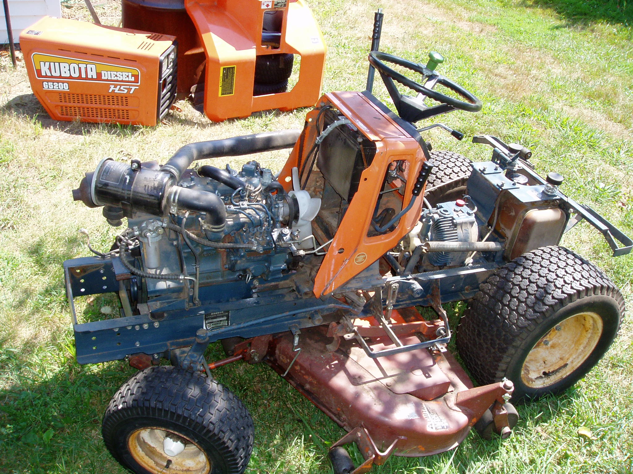

Ugh! Ordered the replacement valve (which I learned is call a "drain cock") from Messick's, which arrived within about 48 hours of placing the order - really amazing. In the meantime, I decided to take the radiator out, clean it & straighten out the fins that had been folded over by a close encounter with a spinning fan and various other dings that have happened before I bought it, a few years ago. Getting the radiator separated from the tractor proved to be a major job. Maybe there's an easier way, but I ended up taking the fiberglass deck off to get access to all the fasteners:

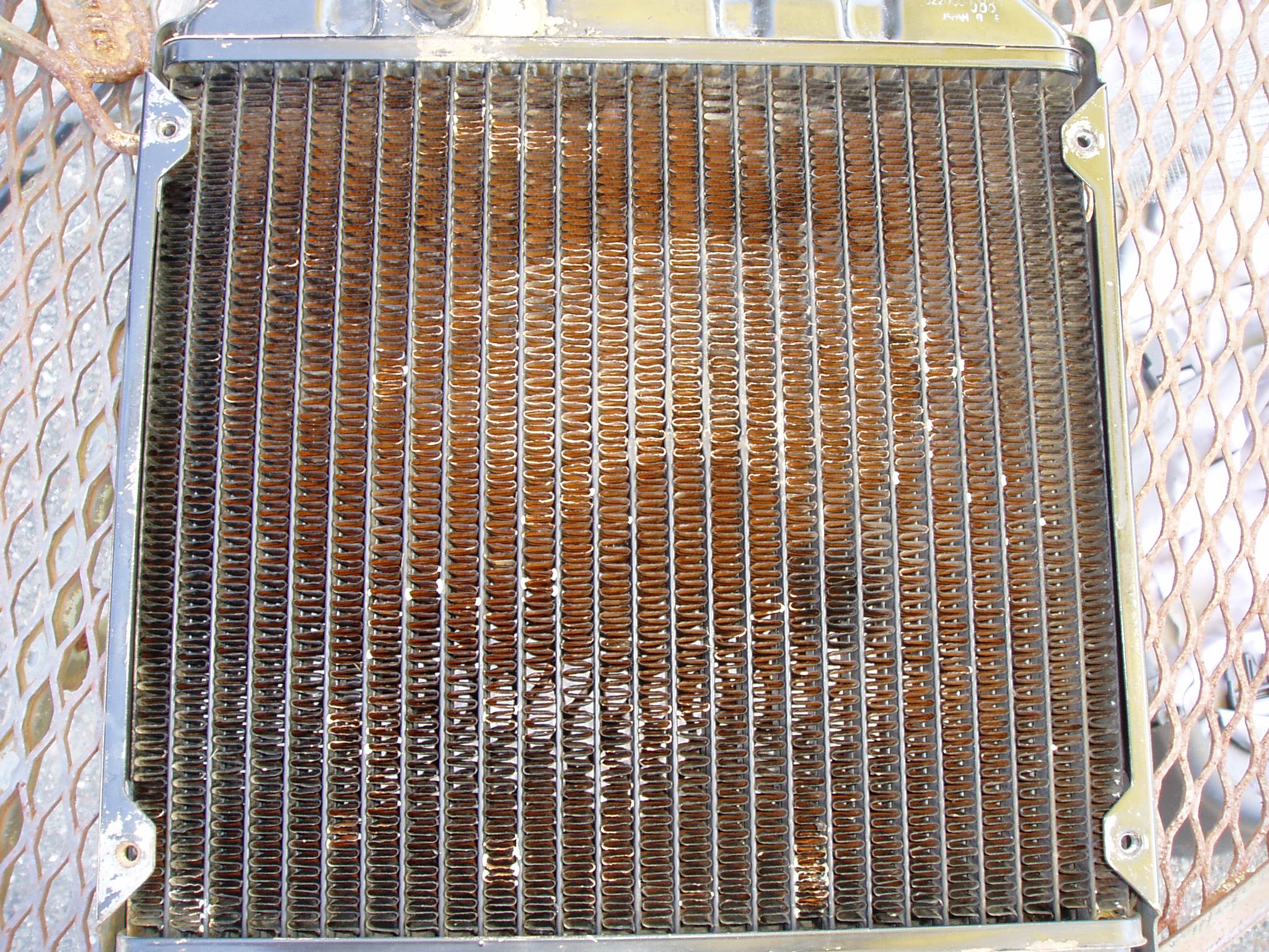

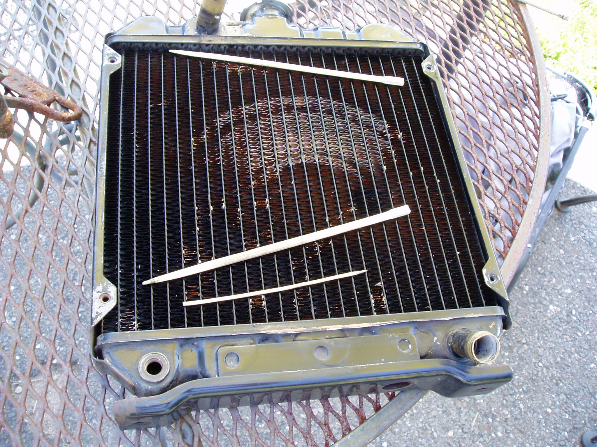

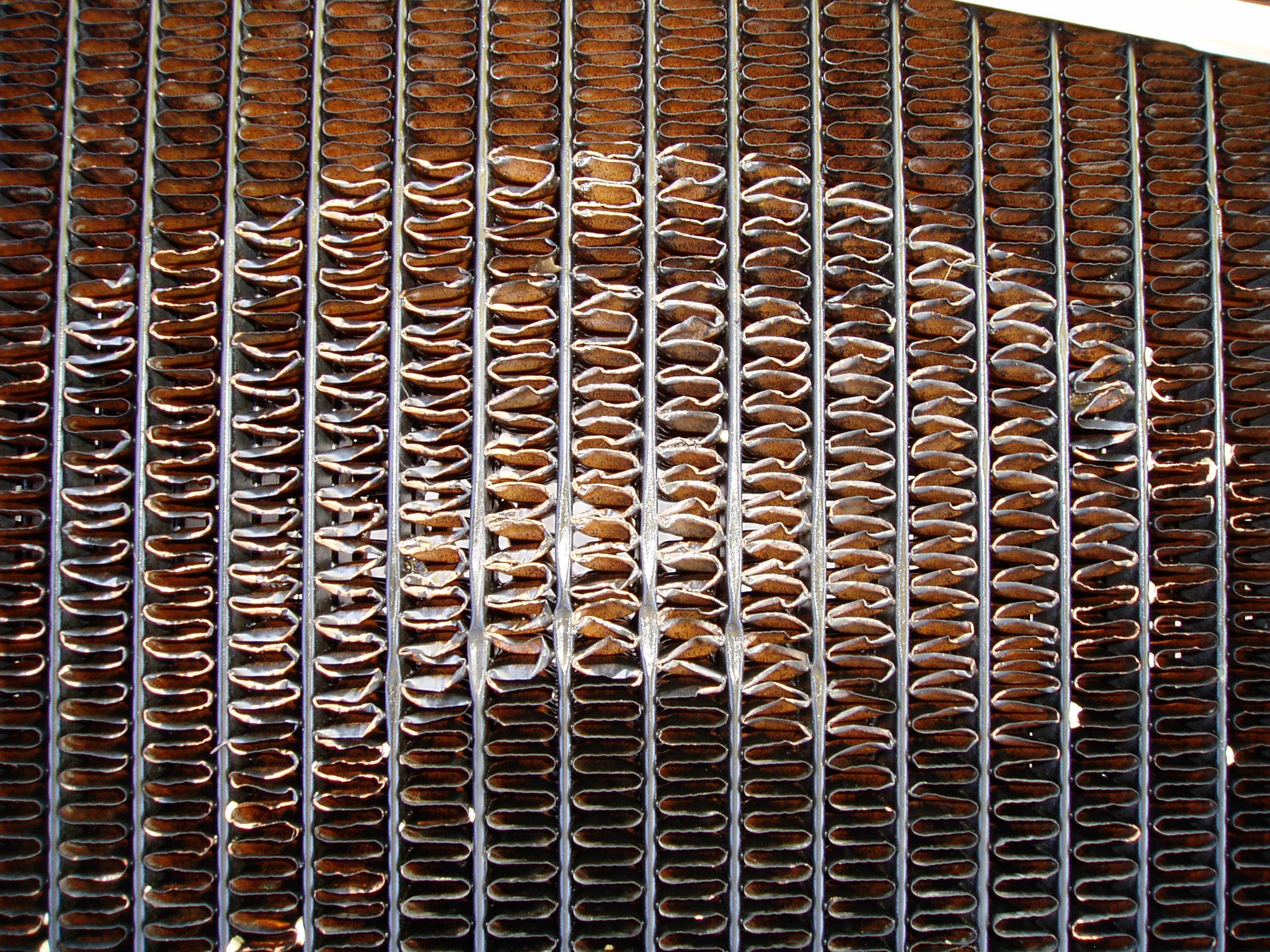

This gave me an opportunity to clear all the caked on dust & grass clippings from every nook & cranny with an air gun. With the radiator off, fin straightening could proceed. This was slow & steady (and tedious) work, but went without a hitch.
Before:
After:
Removing the piece of the valve body stuck in the block did not go so well. An easy-out just smeared the pot metal, or what ever that thing is made of. I ended up hand turning progressively larger bits until I started contacting the threads of the block. Then I had to use a hardened pick with a right angle bend to scrape the pot metal out of the threads, which took about 2 hours. That being done, the new valve was replaced and everything reassembled.

Good point about the gage accuracy. I did use my trusty HR IR meter to check the thermostat operation, and I'll try to correlate what it says vs. what the temp gage says.
-Jim

This is a bit higher than where the gage was reading during the heaviest cutting - it was consistently centered between the hash marks. Just before I shut it down, and right after I popped the hood I took some spot temps - engine was running at medium speed, unloaded. This one is the highest temp that I could find on the radiator:

I'm happy with the results - a big drop in operating temperature & no boiling over.
