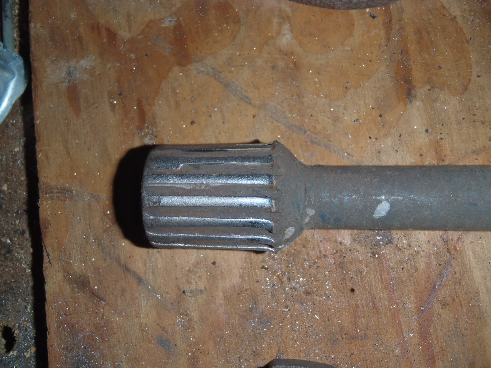

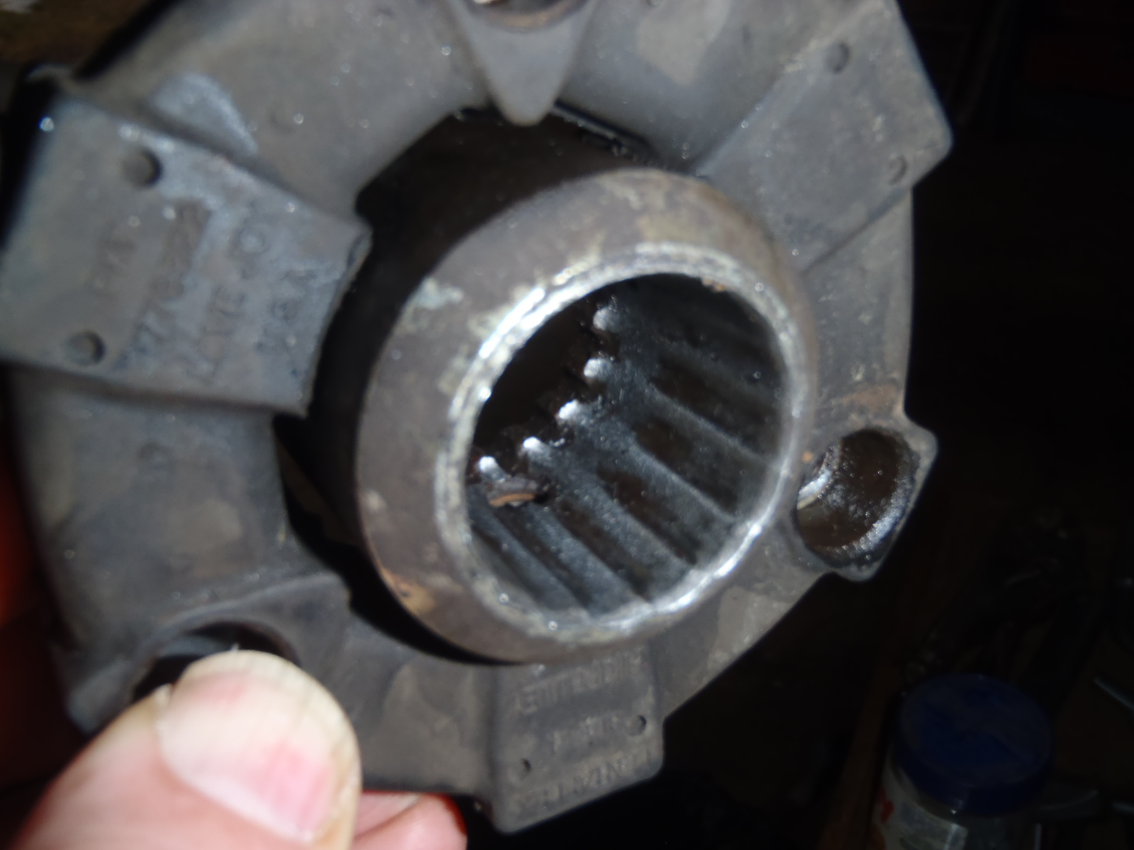

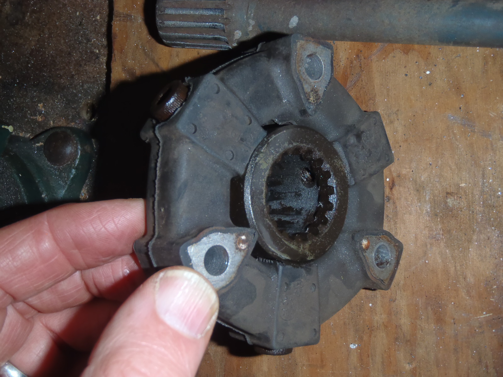

While driving our new-to-us G5200 around our field a few weeks ago there began a terrible screeching noise and the tractor stopped dead. Fearing the worst (an HST problem) I shut her down and towed her back to the garage, making sure to keep the rear wheels off the ground.
After some inspection and disassembly, here is what I found:
Prop shaft and Lovejoy coupling splines are toast.
The good news is that after a call to Messick's I found out that the parts are available and are not too expensive. Will update this when the new parts arrive.
