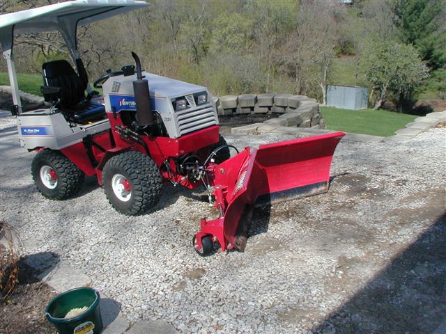

Henro and Others,
The concept of using caster wheels on a snow blade is proven. I use them on my front V-Blade, but they would also work on the rear just as well. These are actually accessory wheels sold by Steiner to replace the standard skid shoes.
See attached photo and 3 more in subsequent replies.
I have used them through 4 snow seasons without difficulty. No problem with freezing up at all. I do store the tractor and blade in a non-heated garage and not out in the snow.
I really like the V-Blade for snow clearing. In addition to standard front pushing and side casting I find the "arms open" inverted V very useful. It makes gathering and final cleanup in corners and tight areas a breeze.

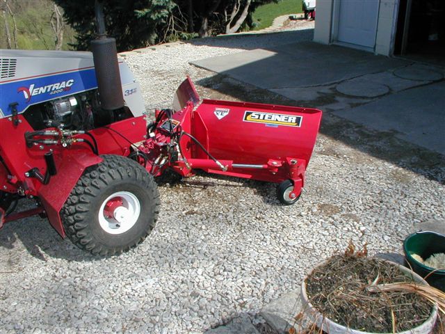

Another View

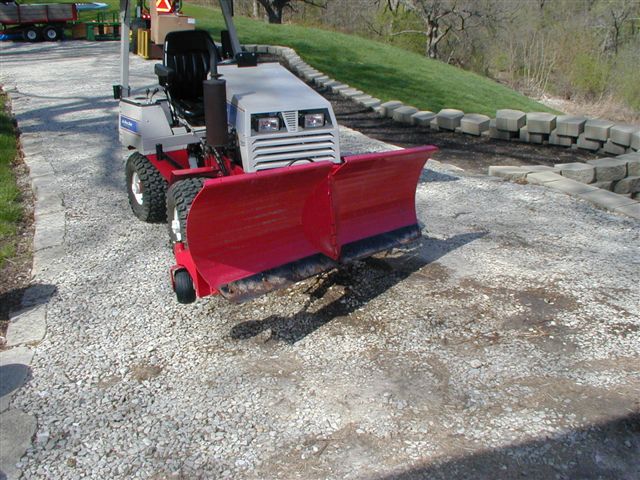

Standard angling for casting to one side.

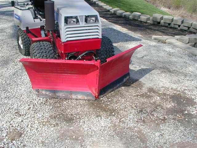

Standard V for opening pass.

   / Gage wheels on back blade for snow? #9
I would think guage wheels on a conventional backblade would be pretty hard on the wheels overall. What with the slush and gravel and ice build up and leading with the wheels pushing snow into an accumulated drift of hard snow and ice.
Sometimes I pull the snow and sometimes I use the blade as intended pushing the snow with the concave side of the blade. I'm pretty sure guage wheels, at least like the ones on my backblade (Woods I think) would either get flat spots in them after they locked up, bent or come up missing until spring.
I bought some skid shoes at TSC pretty cheap and made angle iron brackets that bolt on to the convex side of my backblade. They have an appropriate size piece of gaspipe welded to them for the skid shoes to slide into and I use washers for spacers. The shoes dig in and make small trenches in the gravel until the ground is frozen, but you need to rearrange the gravel at the end of winter anyway.
