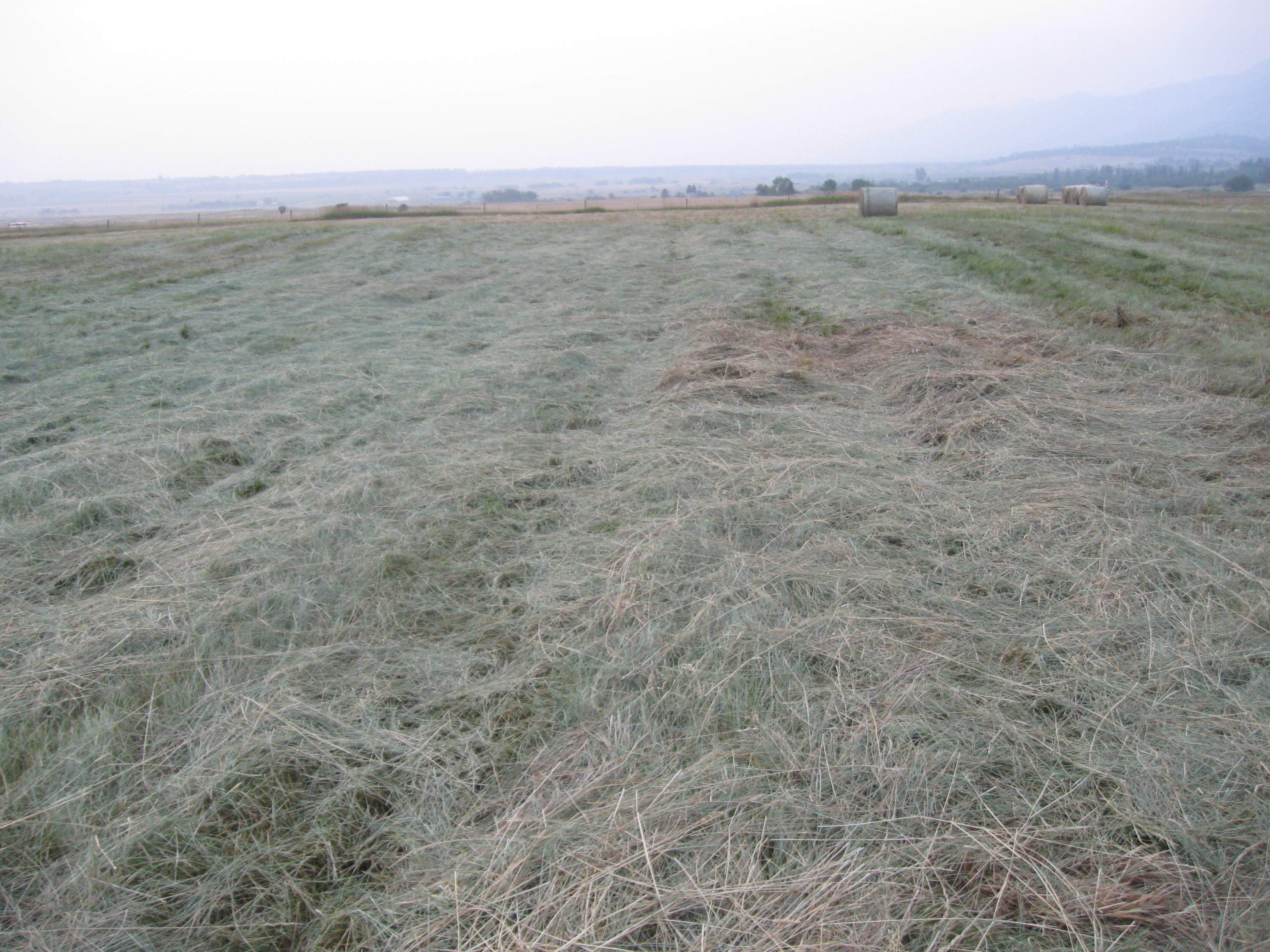

I recently purchased a Galfre drum mower (Model FR/G 190) and just completed haying. This is a first for me, never having done my own haying before. But that's another story.
There have been many comments about the requirement for a tedder to spread the cut grass out after mowing it with a drum mower. The implication was that if you buy a drum mower you need to also have a tedder to ted the cut grass. The Galfre has what they call their "Black Hole" conditioning system. It consists of some steel plates above the drum blade carrier that spin with the drum. It spreads the cut forage out behind the mower. Here's a picture below. All I needed to do was to rake this up and bale it, which I did. Some of the bales are in the background. I have to say that we are in the midst of a drought and my problem was the hay dried "too quickly". I had to bale in the early part of the day to have some moisture in the bale. So it's not a good test of whether the conditioning system speeds drying.
My conclusion is that the Galfre 190 with the "Black Hole" conditioning system does not require a tedder. (I have no personal connection to Galfre or Galfre dealers.)

With the hay spread out like that in Western Montana you don't need to ted. Just rake and you are good to go. Best time for me is to bale when the dew is coming off....or at night. If your tires get wet then quit baling...moisture meter helps. I'm in Eastern Washington and imagine weather is similar. Our problem is the weather can cause the hay to dry too fast when its spread out. Sometimes I cut early in the morning. Rake afternoon and I'm baling in the evening. Hay moisture is around 14%. Makes for some beautiful GREEN hay.

That was my point exactly. This drum mower does not require tedding because of the way it spreads out the cutting.
We are abnormally dry this year. In a normal year, most folks cut with moco's, then wait for a day, and rake and bale on the third day. Not this year! It so dry that people were baling the day after thy cut. It's so dry that there hardly any dew in the hay fields but the relative humidity is higher early in the morning. I like to bale so that I'm between 15- 20% moisture content but the hay in the windrows was more like 8-10%. The hay in the picture was cut the night before and mostly baled the next day.

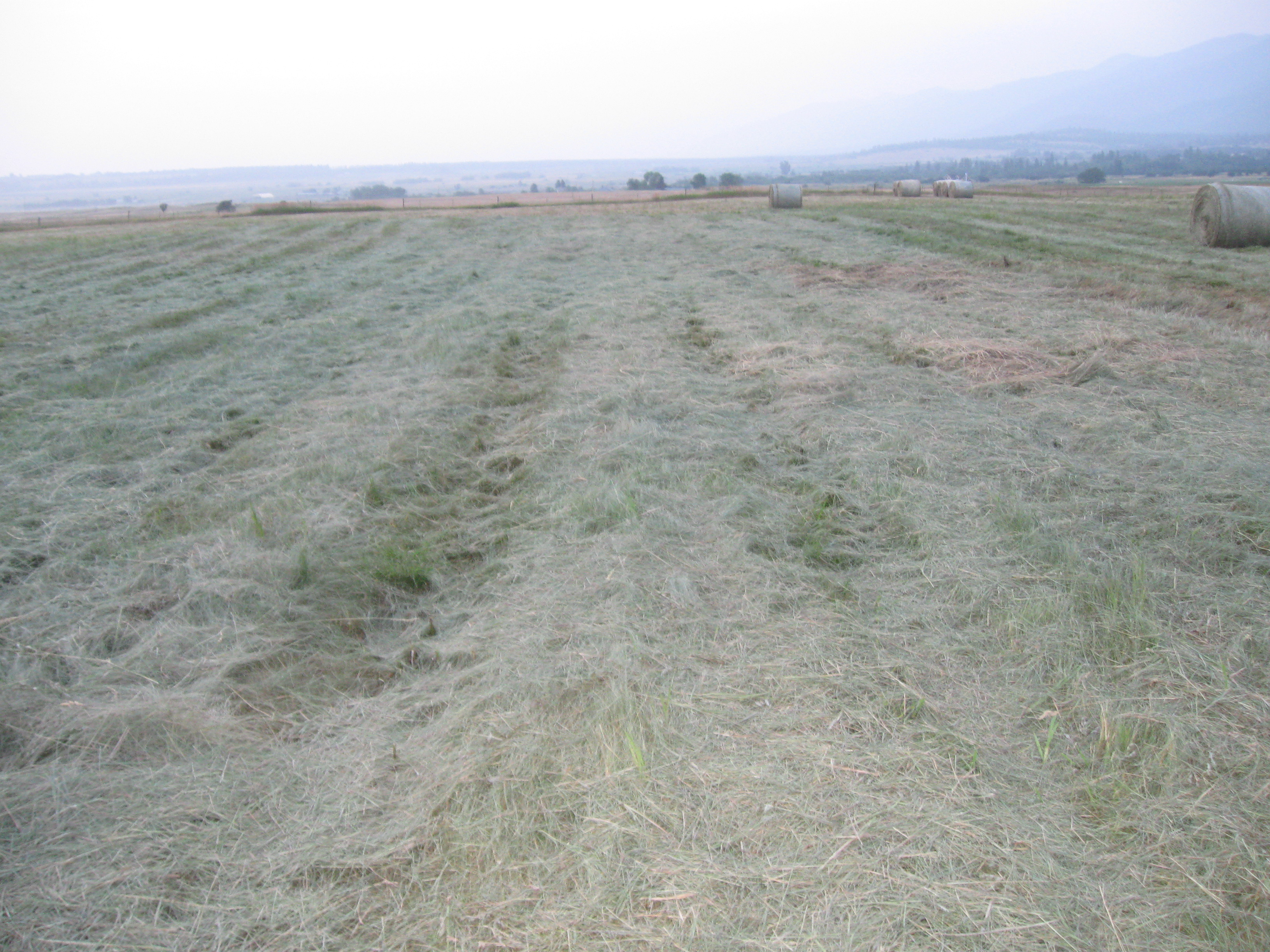

here's a picture of our windrows after mowing. I posted these in a thread back in2015.

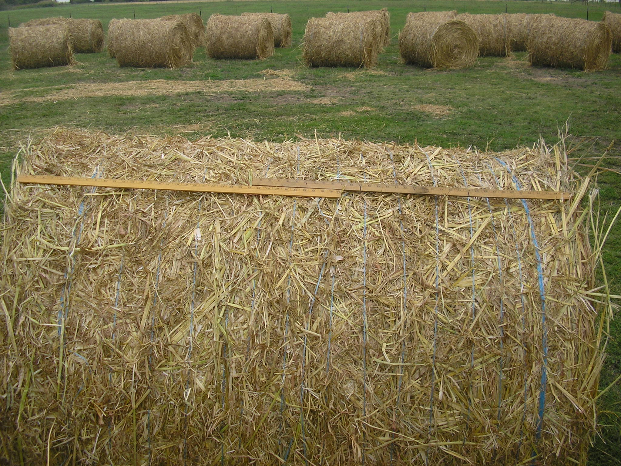

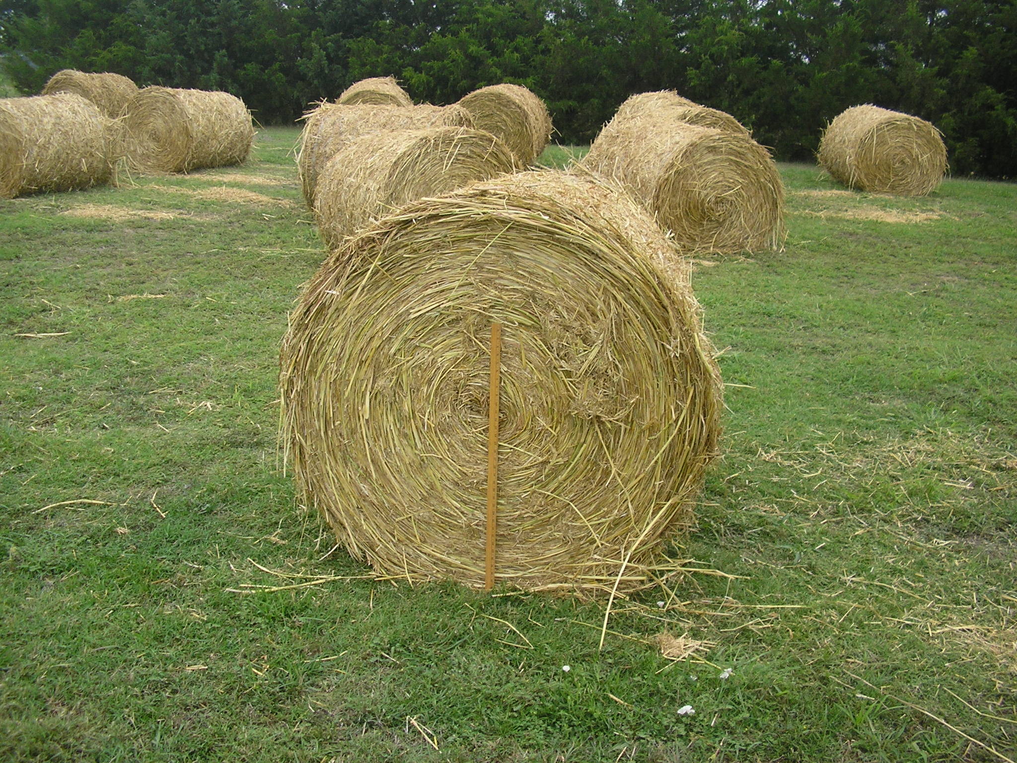

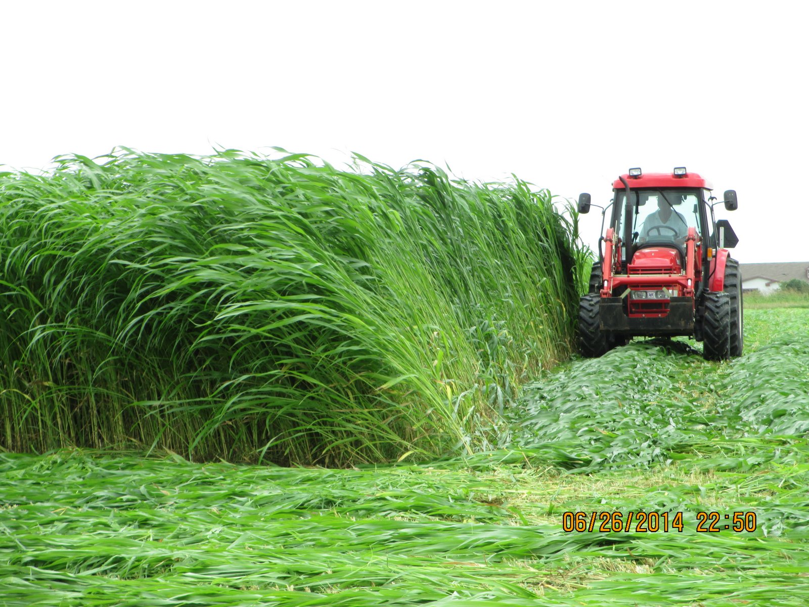

Here's mine previously posted:
The crop is Sorghum-Sudan Gotcha Plus. Mower is the Agrimaster 190 I bought from Small Farm Innovations many years ago. Today he has the 6 footer like mine, for $3875 as I recall. Even with this much crop to process, I still have a clean entrance into the uncut row so I don't have any holidays or over cut and on the other side, my tractor's tires aren't stomping on cut product. Also, note the square corner, no having to go back and clean up corners with a big X over the field.

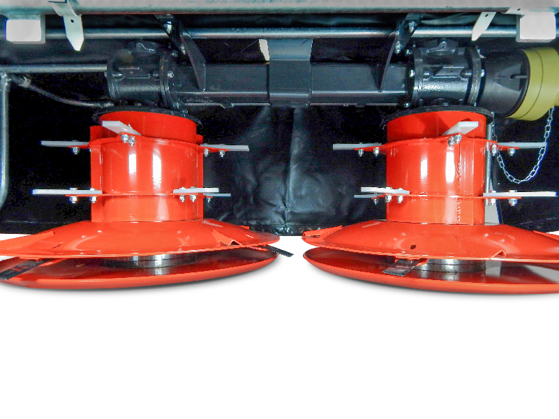

So, the white plastic pieces in this picture the are the conditioning tines?
How well do they condition the hay compared to a roller conditioner (such as the one on our current hay mower, a NH 479)?

Aczlan, that is correct. The white nylon pieces are in fact the conditioning tines. We have had great reviews and feedback from this design. They are durable and can be replaced unlike the Galfre design. You have the option of running the machine without them, and they truly work well. The difference is that this conditioning system due to its design, tends to impact and bend the materials being cut and then spreads the material out, all in one. Rather than other designs and models of conditioning systems. Other types being slightly more intensive, such as roller conditioners, or flail types etc.. Our design is similar to a flail type. With our system, it cuts, conditions, and fluffs by spreading out the bent and split materials. Feel free to contact us for more information and/or to help make the best decision for your operational needs. Thanks for the questions, and I hope this helps.
