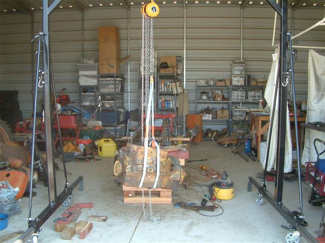

I have one. It's OK. Use it to remove engine from my 1951 Minneapolis Moline BF tractor that I'm restoring
I made 4 slide-in outriggers to stabilize the crane during movement.
   / Gantry crane - harbor freight ? #7
That looks like a different crane than HF. A previous model?
