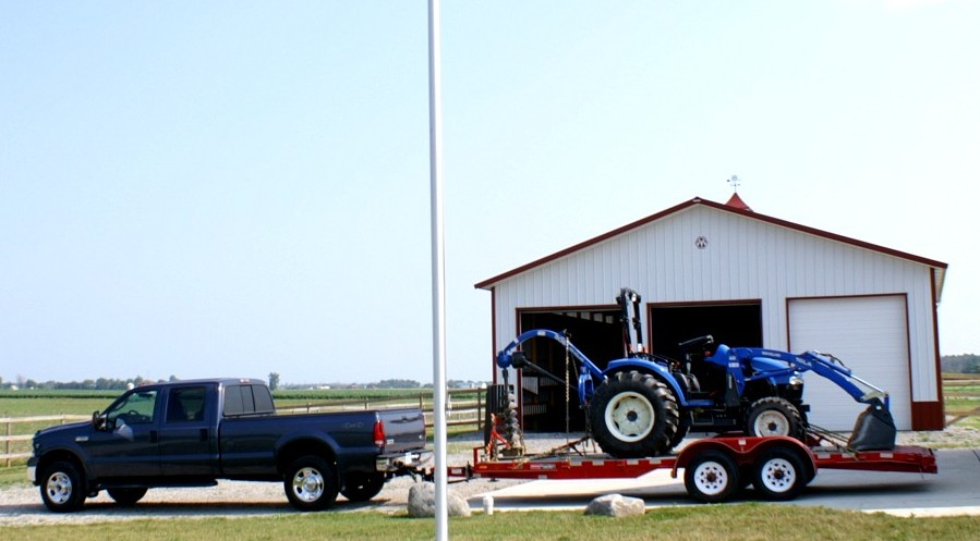

I am danger close to building my workshop / garage / barn.
Going to be 60 X 40 with 12 1/2' eave height.
Going to start with a slider on each side, centered. (the 60' length)
Thinking of going with a 10' door, so I would have room ot put a wing overhang on it later if desired while staying under the other roof.
Looks like my hoe will sneak under a 10' door if I lay down the hoe part, could stand it back up after I was through the door.
Anyone have some insight or reccomendations as too which way too go before I commit?

The barn that I have now has ten foot wide (9'6") by eight foot high doors on both sides of the endwall and a twelve foot wide by twelve foot high slider in the center. I wish the main door was as wide as the sixteen footer that my last barn had. That one was twelve foot high and I oftened wish that it was fourteen.
When it comes to barn doors, bigger is usually better.

My hoe is like yours and needs to be let down to get in and out. I've hit the boom on the top of the door 4 times now. I would raise the stinking side walls, it's a major PITA to lower it and wiggle it in and out.

Agree with the fellas. Higher sidewalls and gable end door if you can. I DID NOT do it that way and my door is 12' wide but only 8' high (because I extended the eaves down and out later on) - I have simply forgot what I was doing a few times and have hit the top of the darn door and the sides with equipment or loads on trailers. If I can, I will one day lift the whole darn barn up a couple more feet and move the door to the gable end. A huge hassle and my mistake was not planning for bigger equipment in the future when I built. I figured at that time I could not afford it but now, 10 years later, I'm regret not going at least 12' x 12'.

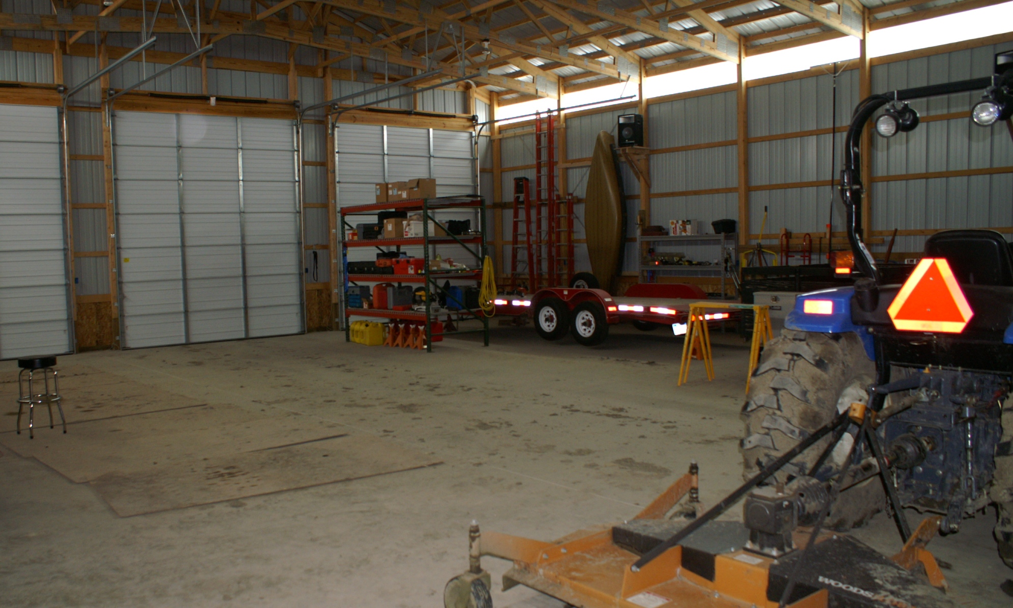

My 2 cents: 30x40x12 pole barn. Came with the place. Has 2 centered gable end sliders, 12' x ~ 11' wide (double door) each. 1 side door on a side wall. Side door is a problem with snow sliding off of the roof. I don't have bug problems, but I would suggest using the foam rubber closure strips under the metal to keep weather and mice down (we have issues with snow sneaking in, and sometimes rain in really windy storms). Brings up sealing the edges of the door openings for the same reasons.
I wouldn't have less than a 12' door. I don't need more than that, but I have a slide in camper that is 11' when on the truck. Taller side walls means a useful mezzanine height (put one along one wall, out of the main path, for all that junk you will want to keep, but don't need often). I wished my doors were off to one side. I don't worry much about keeping the center open, though I do keep it so I can for when I feel the need (which is only occasionally).
And I wished it were insulated for the cold (we don't hot so much -- and swamp coolers work here).
I would also frame out where your utility penetration points are in the floor (leave openings in the concrete, back fill with gravel). That will allow you to add/change/service anything that you have. And one last thing: cut your concrete seams versus molding them in. It was like heaven when I first had them. Wished I had done the apron I work on the same way. Creepers, carts, boxes, all roll so much nicer across cuts.

A cheap way to gain wall height if you have fixed length wall materials is to pour a ledge around the perimeter leaving out the doorways. I got an additional 8" height on my shop by putting a single course of CMU blocks on the perimeter edge. I put Two courses of blocks on my addition lean too to gain a bit more height and water resistance since it was against a hill. Anyway, the builder first dug and poured the wall footers and embeded rods to hold the blocks. Next a brick mason set all the blocks on the footers on which the 2x8 floor plate and 2x4 wall studs would sit and allowed to cure. The slab was poured inside the CMU block wall and the hollows in the blocks filled with concrete. J-bolts were installed in the CMU blocks when filling with concrete on which the wall plate would be bolted down. He used 9 foot 2x4 for the walls and when setting on the single course gave me 8" from the block x 1.5 for the 2x8 floor plate so I ended up with 9.5' interior wall height which allowed me to have 8' garage doors installed. This is high enough for my B26 TLB to enter with hoe in raised position but alas not nearly high enough for my LS to get in. This costs me a bit more than $1 per linear foot to install. It also pretty much water proofs the walls from any runoff AND gets the exterior siding up off the ground so it doesnt water stain from rain splashing it. A side benefit is that I can powerwash my shop and not get the interior siding watered too much. I used 3/8" plywood for the interior ceiling and walls which is good for putting hangers about anywhere I want for light duty stuff.
