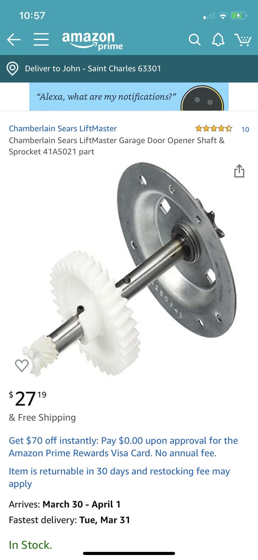

My son’s garage door opener wasn’t working right. It would open about half way then go back down. It was unreliable.
Looking at the unit it was clear the gear on top of the unit where the chain wraps around was wobbly/broke. So, we called a garage door company. They said $90 to come and $100 to repair. Parts extra.
We declined. I found the part on Amazon and got it 2 days later. The fix took 30 minutes max.
It was easy even for someone with zero knowledge of garage door openers.
The part picture is attached.

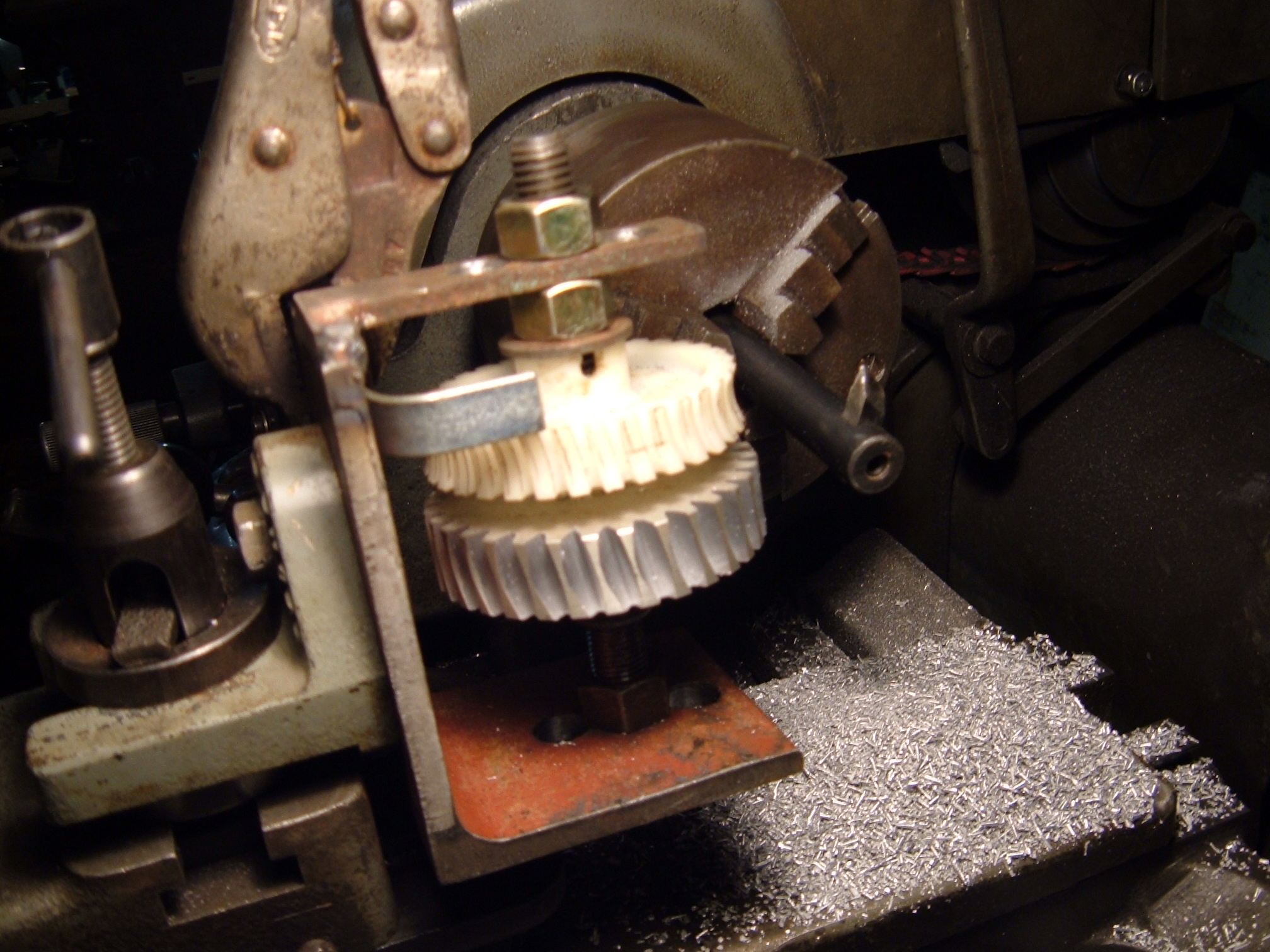

I had the same problem, but I didn't know if the parts would be available. So I made one out of aluminum.
