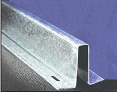

We had the same situation! we purchased a Genie direct drive homeowners door opener for it, and ripped down a long 2x4 to act as an "extension" piece to go from the end of the opener, down to the door, since there wasn't enough clearance between the door when it was open and the ceiling of the garage, the opener had to be set back further then normal. This does work for us, but it makes the door bounce when it first opens because regularly when the door opener begins to open a garage door in its usual mounting arrangement, the bracket that attaches the opener to the door is generally directly above the top of the garage door, so it first pulls upward on the door slightly, then once the door begins to open it pulls back on the door to pull it down the track. The problem we ran into with this set up was that after years of the opener pulling straight back on the door to try and open it, it weakened the metal of the door where the opener was attached to it and allowed the door to crack and sag in the middle. We corrected this problem by adding a door stiffing bracket at the top, which most garage door company's sell and most likely have in stock.
We actually have this set up on a 16' door.
I will be heading up to this garage later tonight, I will try and snap some pictures of it for you.
This is what a garage door stiffener looks like, it runs the length of the door at the top and screws directly to the door, really helped our situation a lot, should have been on it from day one
