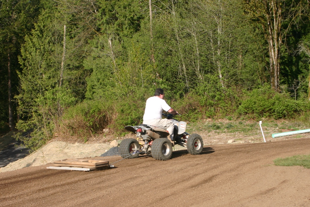

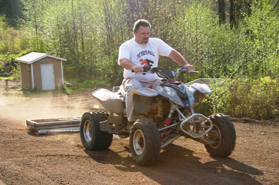

I did the Chain link fence which works well but it do not have enough weight when i was putting in my lawn.
So I took 2 pieces of 4 X 6 and lag bolted the fence under it. It work better but not as well as i wanted to. I added two 2 x 4's to the ouside of the 4 X 6's with JUST on bolt at each join. This made semi-flexible box with the chain lnke fence under it. That was almost perfect but it needed just a little more wieght, so i added 2 cement blocks in the center of the wood and it worked like a charm.:D
The pictures are of my last change to metal channel but the all wood one worked better.
