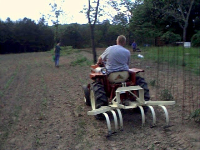

I use my garden tractor, 16hp. to cultivate my corn, about an acre. I also use it with the box blade to get under my sheds and barn for cleaning out purposes and I use the smooth disc harrows for covering seed when I sew a turnip patch or planting food plots. It does have its limits but by being small has its advantages.
