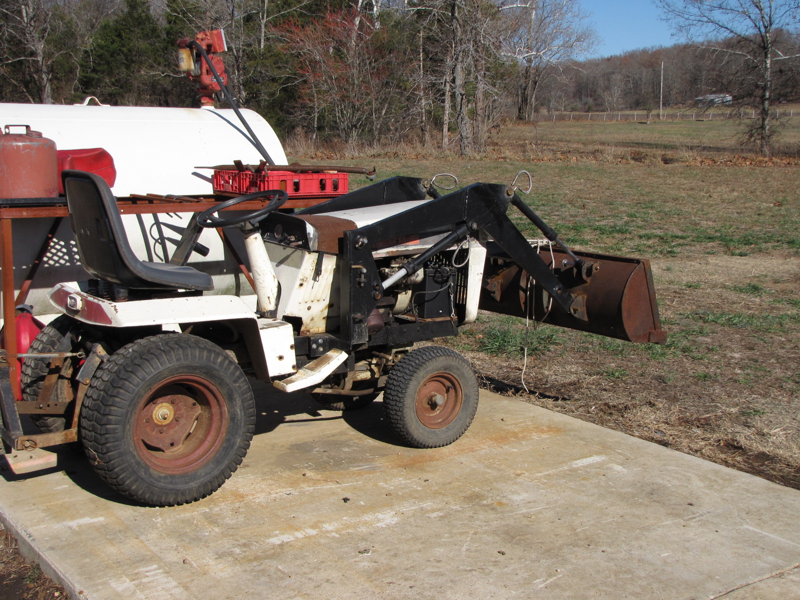

Here's my little mongrel:
526358d1509130368-grapple-project-open-source-2nd-murray-fel-jpg

   / garden tractor loader #8
This is one I made for my Bolens and ended up trading off before I got all the Hyds and pins cut. Your mower looks like it well be a little harder to put a loader on.
