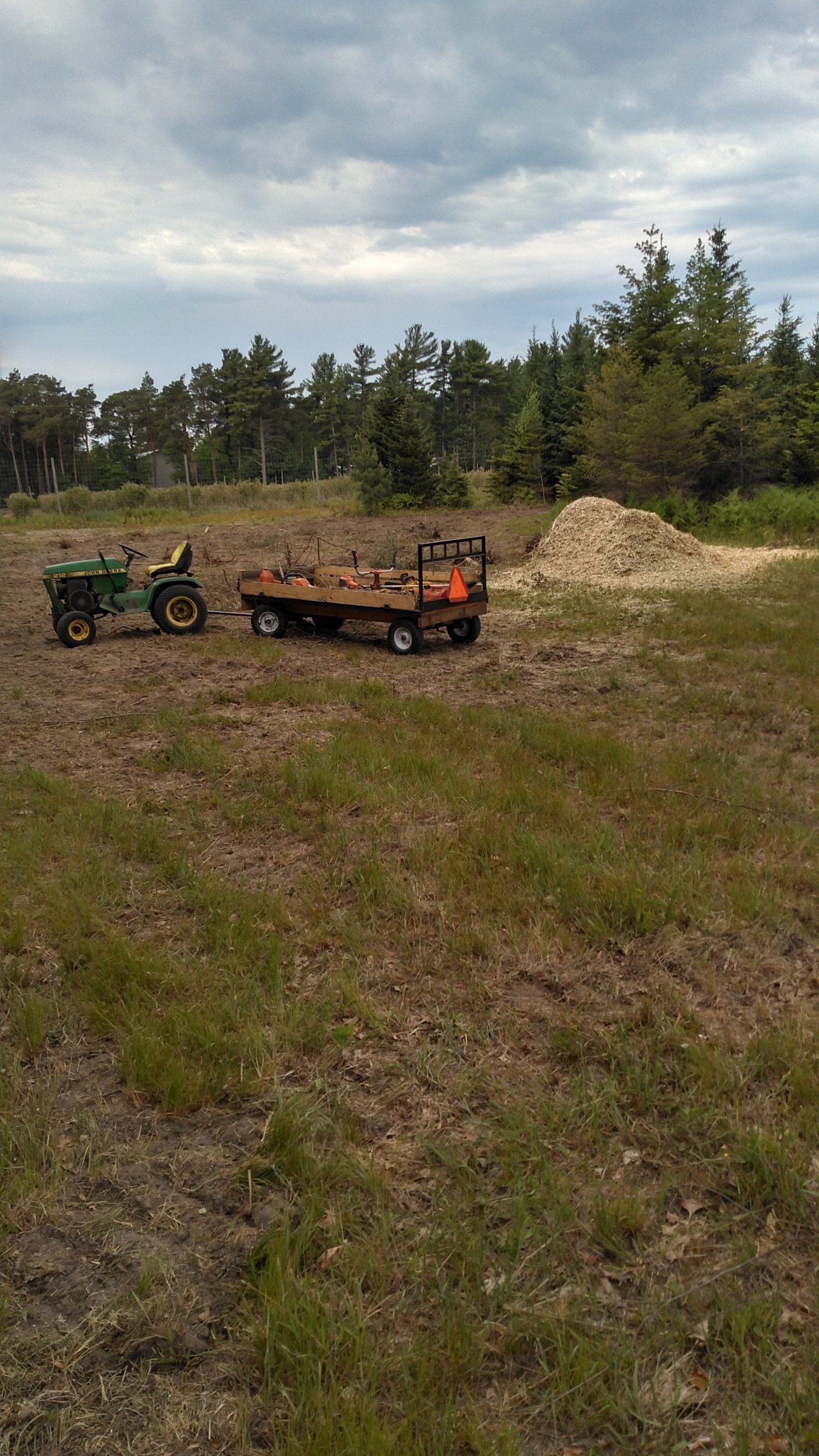

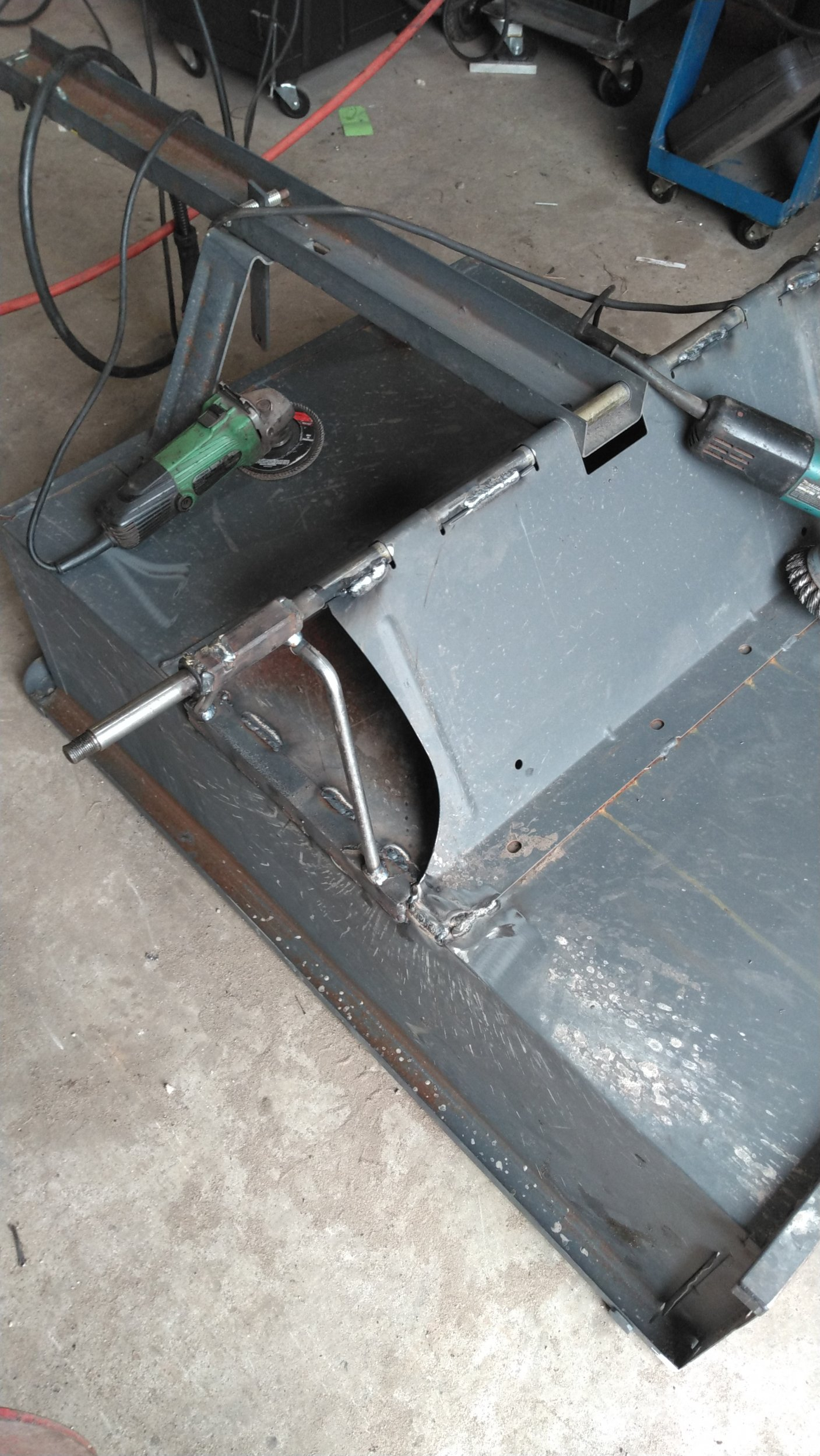

Had similar problem ended up reinforcing a cheap one, used the front wheel spindles and tires off an old scrap John Deere 112. I also built a mini haywagon using scrap steel and wood bought the running gear off northern tool 2k capacity use it for everything including selling pumpkins roadside. Only has front axle steering so it's not the easiest to back. Good luck.

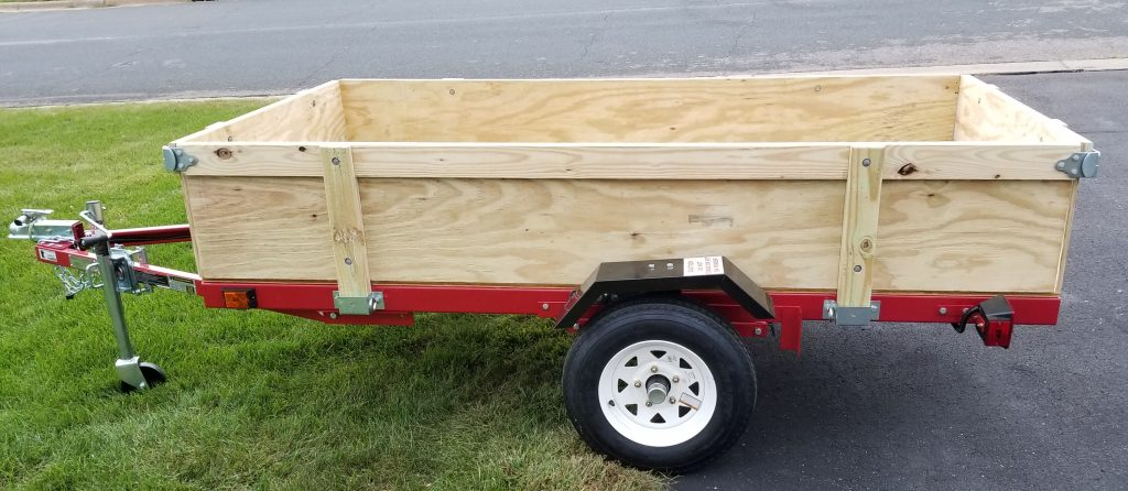

If you want tiny like the original garden tractor trailers, you could start with HF's 40"x48" chassis. But put a solid structure on it.
My watering rig weighs 2600 lbs starting out. This has served well for a decade now on very rough ground. Nothing has broken but I once bent the flimsy tongue backing up uphill. Strengthen the flimsy tongue, and maybe make a longer tongue if you are going to extend the length of the bed beyond the chassis. Then build up from there.

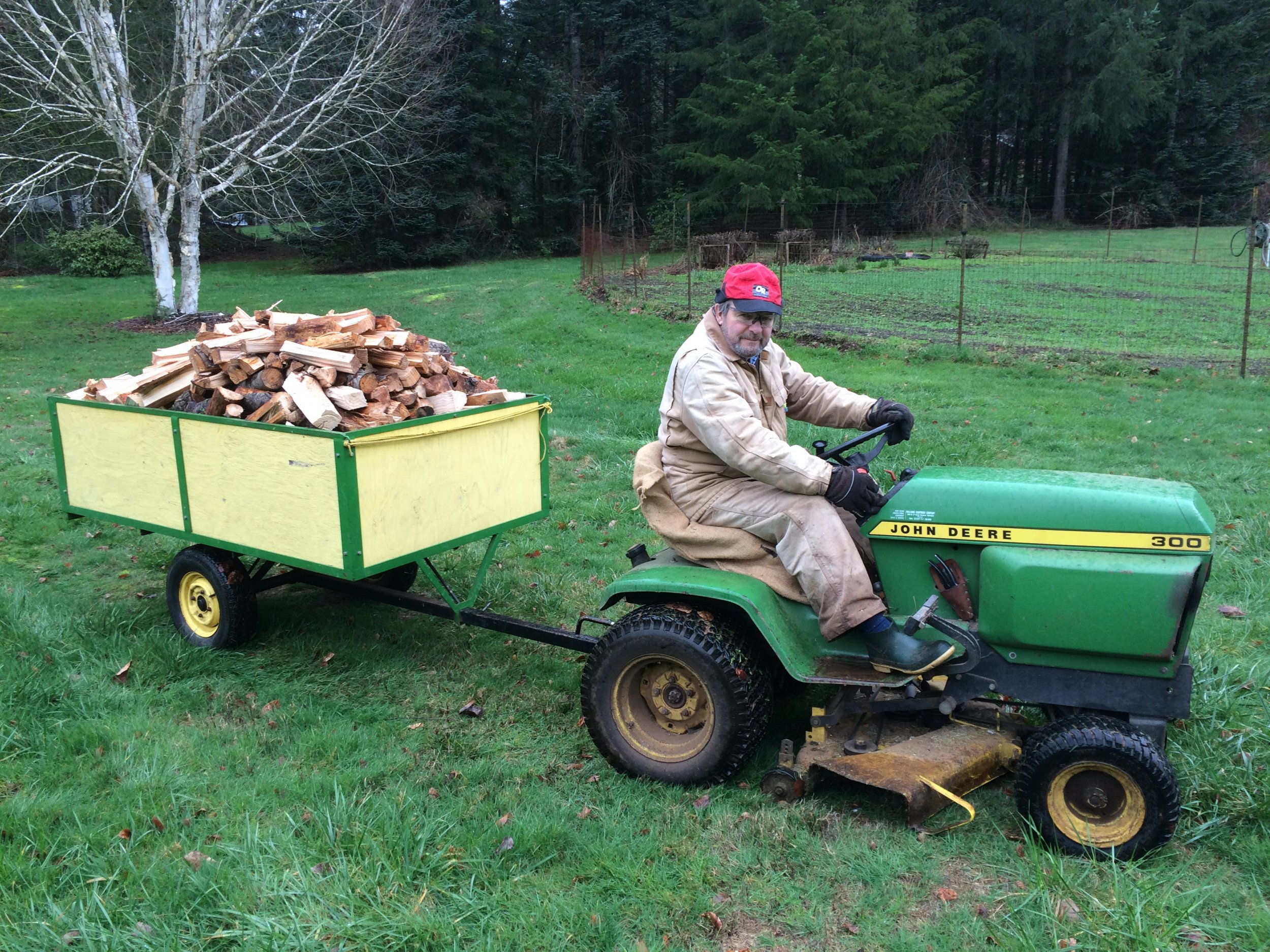

I built my own long time ago and it has served us well.
The box is 5' 6" long as I recall and the same width as the tractor rear wheels.
I used a salvage yard Honda 600 shortened rear axle and wheels (It was a tiny 2 cylinder engine car from 70's).
145R-10 Tires:
It was not the cheapest solution by far, but the best for us in the long run, and it also works very well with our ATV!
