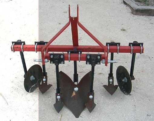

Hey,
attached is a photo of a king kutter cultivator I have been thinking about buying to weed my garden in the spring, will this work well? You can remove the center tines, and leave the outside ones to till in between the rows, and can I add some wheatland sweeps to rip even better? /forums/images/graemlins/confused.gif

I believe you'll find there is a space in the middle for straddling the row. There should also be as many a 3 holes in the vicinity of each of the sweeps in that photo, allowing you some adjustment. You may of course replace the sweeps on the tines with anything that will bolt onto them. /forums/images/graemlins/wink.gif
   / Garden weed control #3
I used what appears to be the same cultivator from Tractor Supply Co., but mine was red. /forums/images/graemlins/wink.gif I replaced the points with 6" sweeps, using the "half sweep" on the two in the middle and then straddled the rows.
