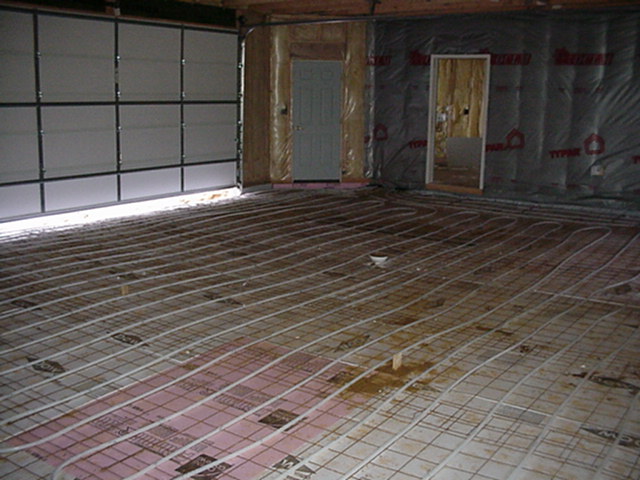

I would go with a Reznor type unit heater. You can get them from 25,000 btu's and on up. Another system if you have not poured your floor yet is radiant. I realise you want to blow the air around to heat the whole room but if you put the tubes in the floor you won't need to blow any air around. My garage has it and I can keep my garage at 50 deg and still work out there in a T shirt due to the warm air rising over you.
As far as using anything without a vent I would not recomend it. I don't care if the manufacture says you can use it. They still give off carbon monoxide. Many times the brochure says no need for venting but when you open up the instructions it says to use in a well vented area. Don't take your chances in it.
