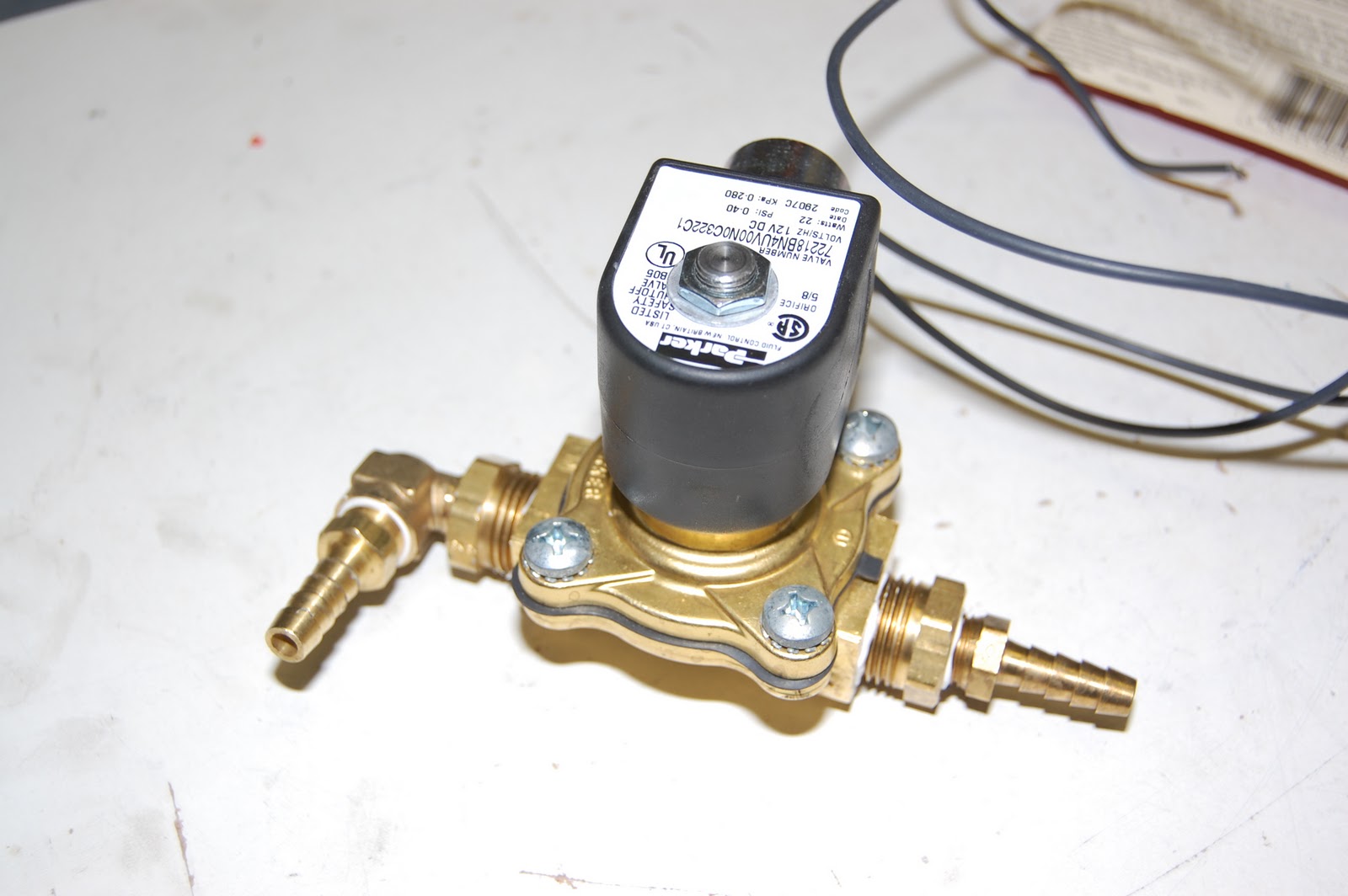

You could install a fuel cut off solenoid before the carb to insure no fuel flows past the solenoid.

Previous discussions that covered this included the info that the Robin user manual requires an inline valve on the fuel supply to prevent the flooding scenario when the engine is not in use. The solenoid valve on the fuel line does not shut off all fuel flow, and if the float sticks, the fuel will flood out the bowl and easily fill the crankcase through the rebreather line.

Although my Kohler engine has the solenoid fuel shut off, I added a manual shut off valve also. I have had those solenoids jam and not shut off the fuel.
