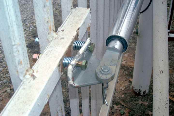

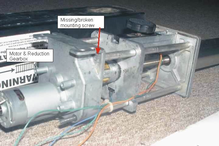

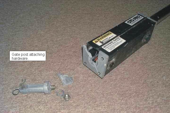

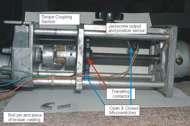

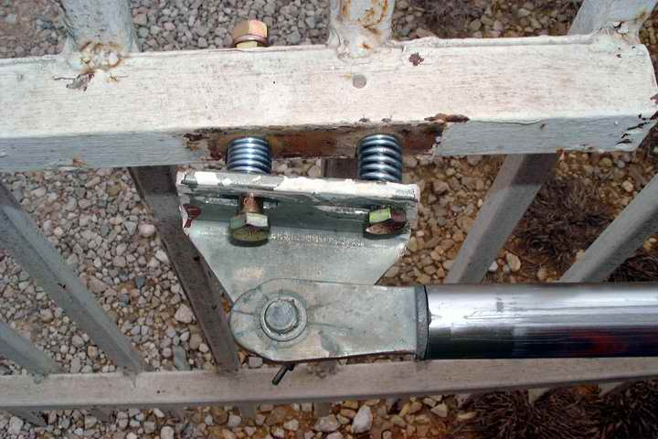

2. The gate opener is going to come with hardware for a rigid mounting hardware (no shock mounting). I suggest you do some "southern engineering" and create a shock mount that will keep the full load from being instantaneously transmitted to the opener when it starts up. With a heavy gate, that shock is significant. I'm attaching pictures of how the opener self-destructed about 4 years ago and how I built a spring-loaded damper to reduce the shock load. The repaired opener has worked perfectly for over 4 years with no signs of cracking or shock destruction.
The first picture is of the gate. The 2nd is the broken opener. The 3rd-5th are the internal parts and some of the shock damage. The rest of the pictures are the details of the damper I put on the gate end of the opener. I first use grade 2 bolts and they just bent easily. I redid the damper using grade 8 and they have stood up fine to the stress.
