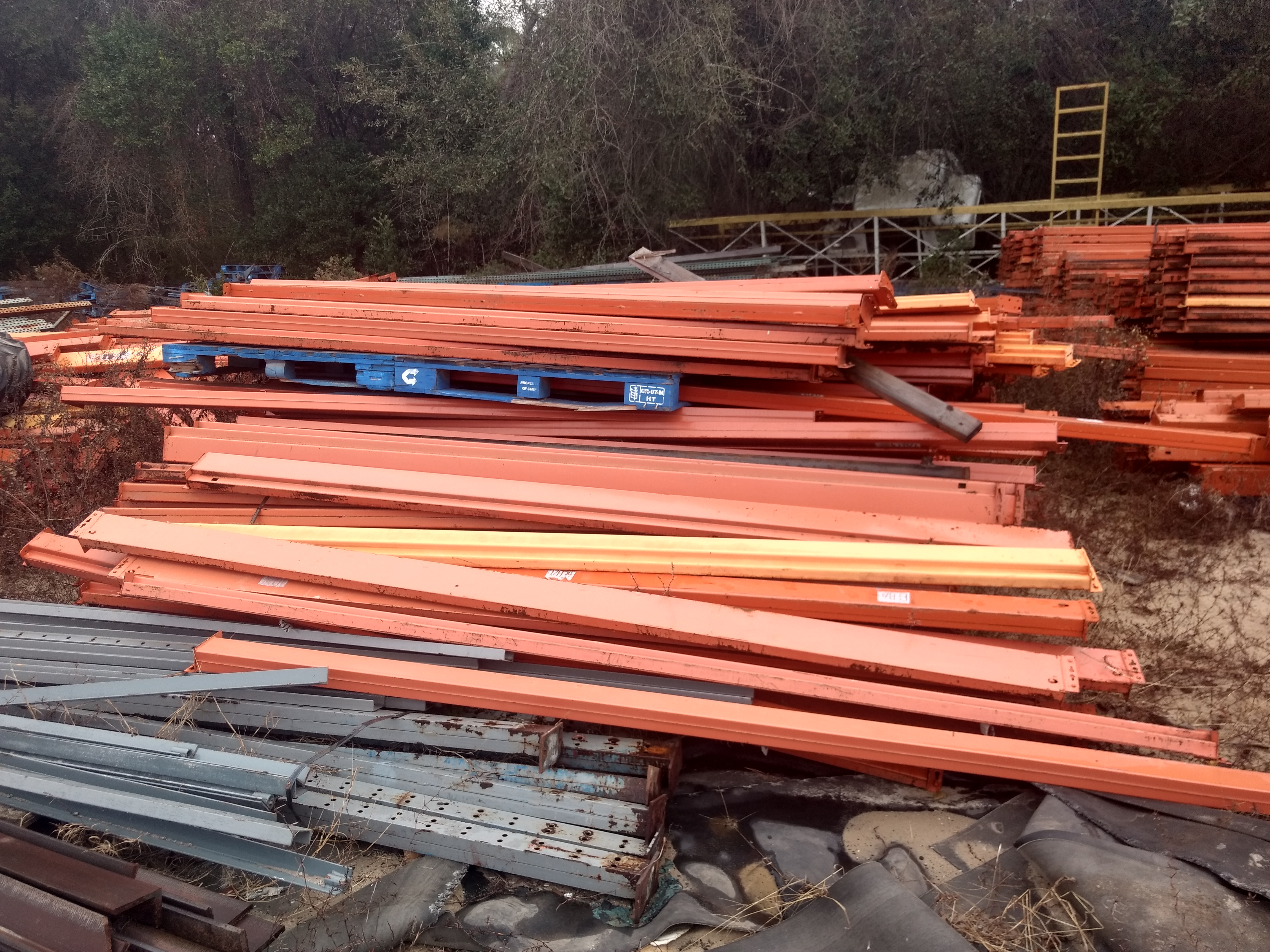

Went to pick up some steel from a scrap yard for a cheap project and found two big steel post. So it got me to thinking about putting up a gate on a piece of our property. He had a large stack of the rectangular tubing that's used for shelf stands in Warehouse's and figured I could use this to make my gate. The pieces are 12 feet, I would cut to 10' and make two gate for a 20' entrance. My question, this stuff is 1/16" or 16 gauge. Is that thick enough to support it's weight 10' out from the hinge?

Those orange pallet racking LOAD BEAMS would not be the best choice for your gate. They are designed for HEAVY vertical loads and because of their formed and folded construction will rust out quickly outdoors.
I'd look around his yard for something else. IMHO of course....

Thank ya sir, that's what I was looking for. I'll abandon this idea.

Agree that those aren't the ideal material for a gate due to the irregular shape. If you don't mind scabbing material together, one could make some pretty stout barrier arm style gates with three of them though.

The pallet rack beams are tack welded in spots along it's folded seam. It will lose its shape (slightly) where you cut it to length unless you cut next to a tack.

You know what they are for sure. I was going to run a few more tacks down it when I noticed that. Think I'm going to just find something else to use now though since you said they will rust away fast outdoors.

I used some of those exact same pieces when building a shed a couple years ago. I wouldn't hesitate to use them for a gate, just put the seam at the bottom and drill a small hole in the bottom side of them to let out any moisture that may get in.
As far as sag, if you put an angle brace from the top of the outside to the bottom of the inside of the gate you won't have a problem. If you do get sag it will more than likely be the posts settling in.

I did ditch the idea using the thin wall pallet racks. He had a big stack of 2x2" 3/16" angle iron 10' long I snagged up about 500lbs of. Figured I could use it for various projects and going to build the gates out of it. Going to have twin 10' gates and adding galvanized horse panel inside the gates. Also snagged some 6" metal pipe for post with 3/8" a
Walls.
Appreciate the advice guys.
