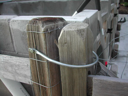

   / Gates for split rail fences #6
Here is a shot of the Hinge.

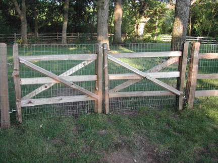

   / Gates for split rail fences #7
This double gate is 10' wide. Only issue is when my wife has puppies from her dog breeding hobby the little one can slip through.

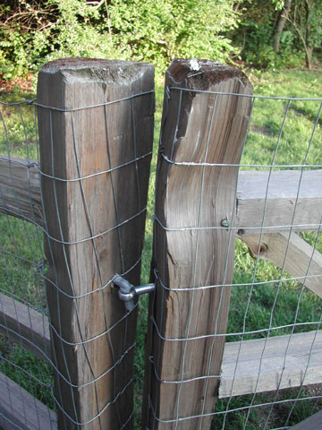

   / Gates for split rail fences #8
Here is the last pic. This is how they did the latch. All in all these gates have held up well, but it has only been a few years. The cross members are just screwed with some long decking screws.

Maxfli,
Thanks for the great pics, very useful. I set a couple of gate posts last weekend, plan to try to finish the rest this weekend. A couple of questions. Is there something to support the weight of the latch ends of the double gates when they're closed, or do they hang completely off the gate posts? I would think that even if set in concrete, cedar gate posts are relatively short and that heavy gate would end up slowly tipping it in the hole. Although maybe that wire backing adds a lot of strength to keep the gate post upright. We also plan to put up wire although it's to keep the coyotes out, not keep the dog in.
   / Gates for split rail fences #10
Mark,
No additional Supports on the latch end of the gates. They have been in there a few years, and they still seem as solid as the day they were installed. For the most part the installers were pretty informal. They dropped the posts in the holes, filled around with dry cement, and said it would set on its own. The Cedar is pretty light. I was thinking there must be glue in some of the joints, but I don't see any.
