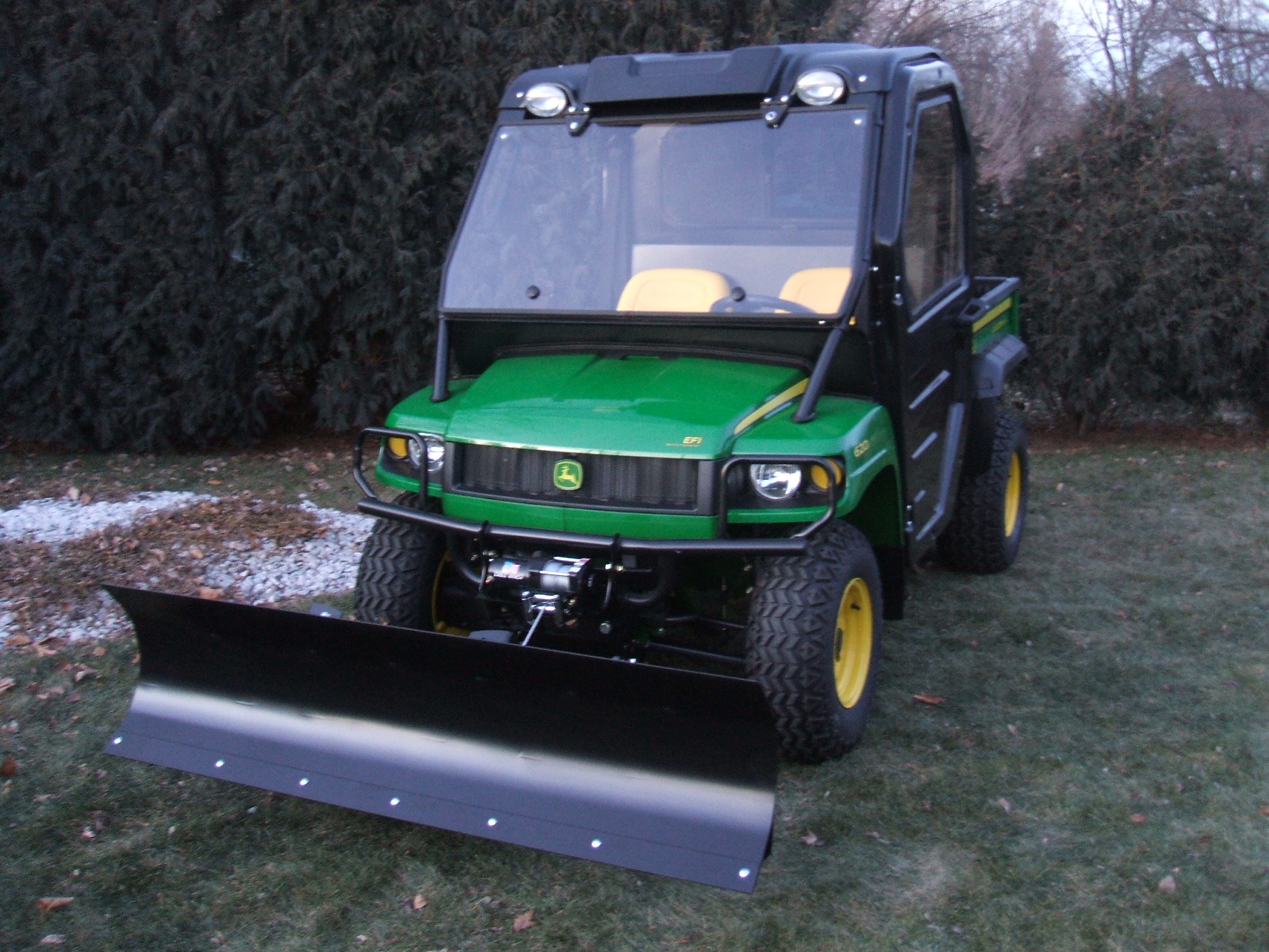

I recently purchased a 620i and have been looking at snow plows and winch mounts. I've got the plow narrowed down to two but don't know what to do about a winch mount (already have a winch). The only info I can find talks about using the front receiver and a drawbar-type mount. I don't have a problem with this but it seems to me this could be to low to lift the blade high enough. Does anyone know of any mounts that are made for the front receiver or fit in the front bumper? I could make something for the front receiver to get the winch higher if I have to but I'd rather just buy something.
If anyone has any pics of their xuv with a winch and blade it would be greatly appreciated. BTW, I'm getting either the Eagle straight or v-blade, whichever funds allow when I decide to purchase it.

C'mon, man! It's July!;)
Actually, depending on your Gator's front brush guard, Eagle plow has a winch mount that may do the trick.

Thanks for the pics. Looks like that will do it. I knew Eagle made one but the only picture I could find didn't show it well at all. It was use in conjunction with a larger brush guard/bumper and I couldn't tell how it mounted or if it could be used without the brush guard. This is what I was looking for.

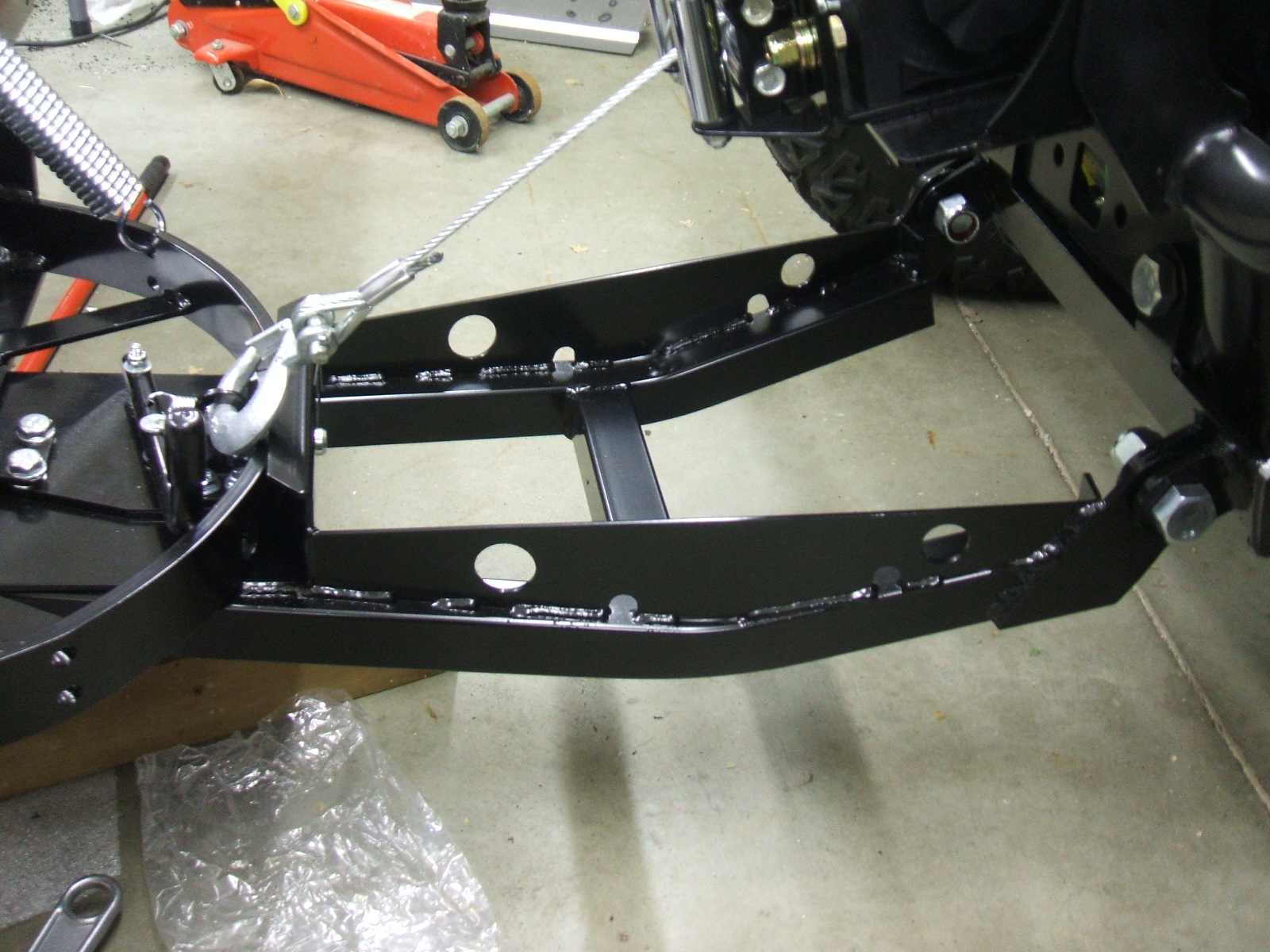

What about mounting the winch to push tubes? I won't be using it for anything else so there is no need to have it mounted to the gator when I'm not plowing. It looks like it would be really easy to make a plate for the eagle push tubes to mount the winch on.
   / Gator XUV and winch mount for snow plow #8
I'm sure it could be done if that is your preference, there is room. Some extra work to set up a mount plate, attachment point for the hook, and how you're going to hook up and disconnect wires seasonally.
