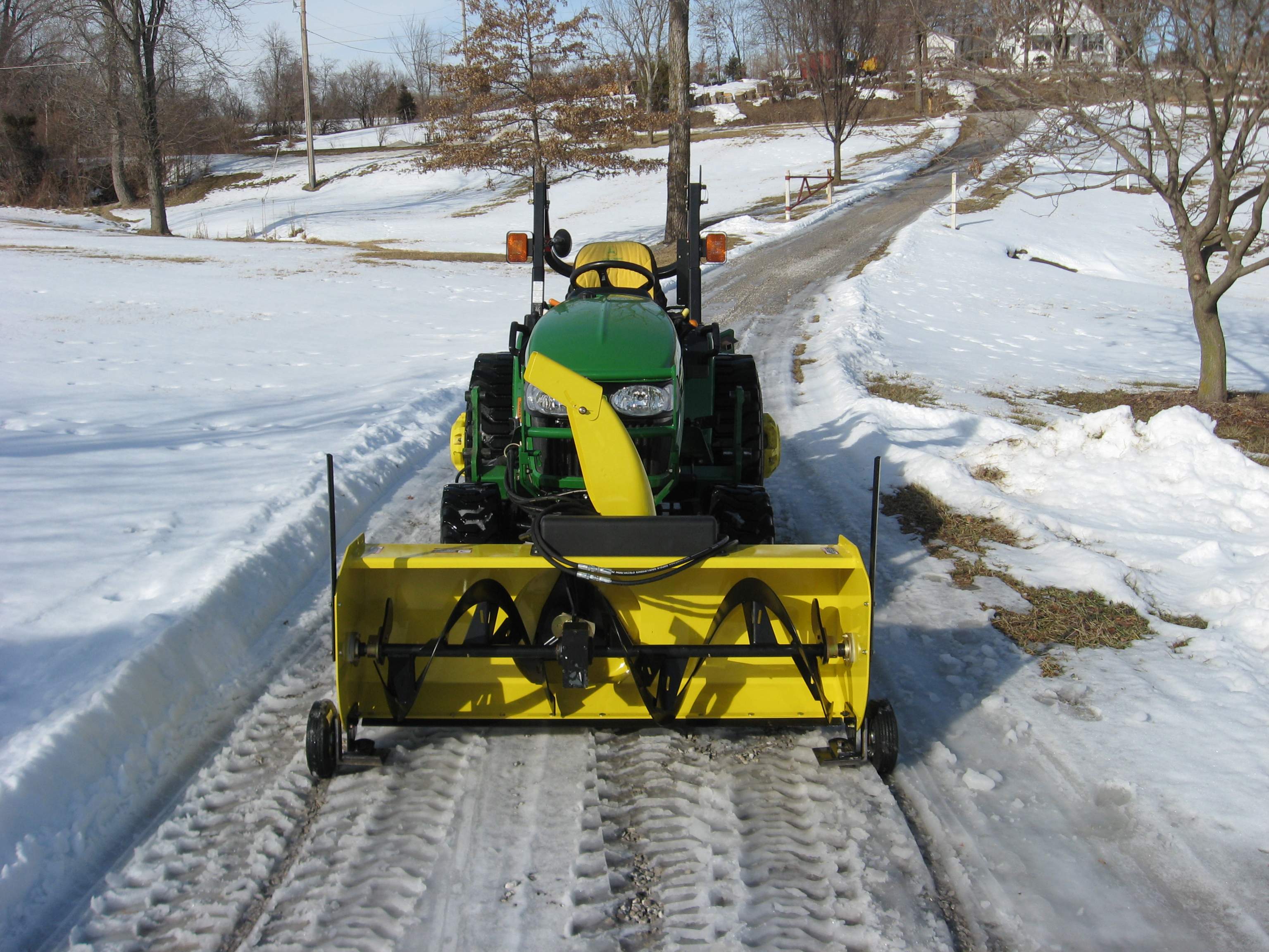

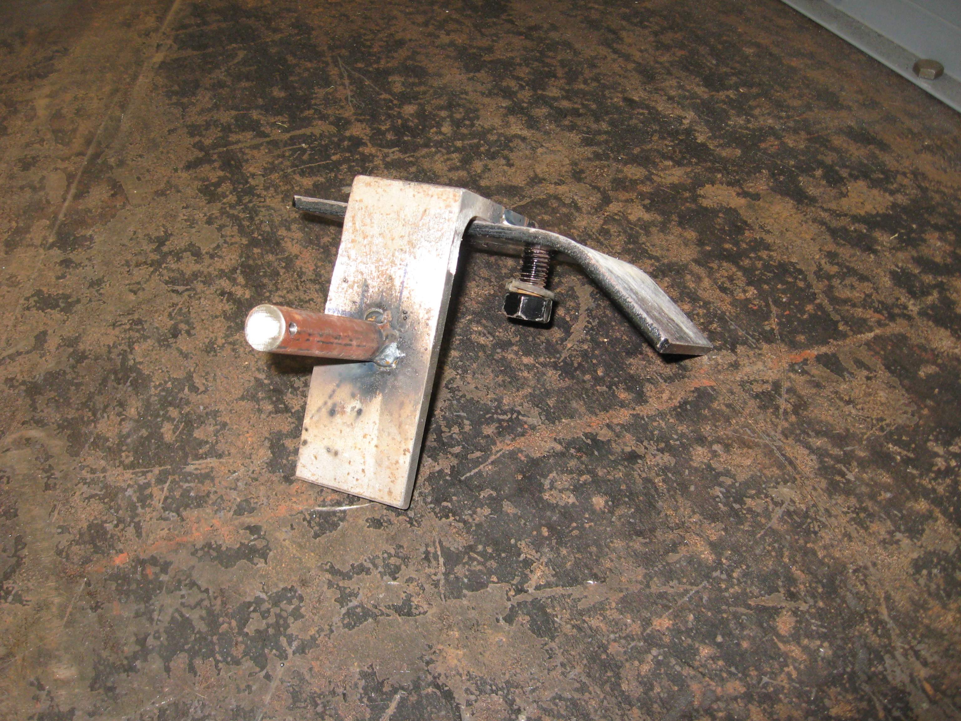

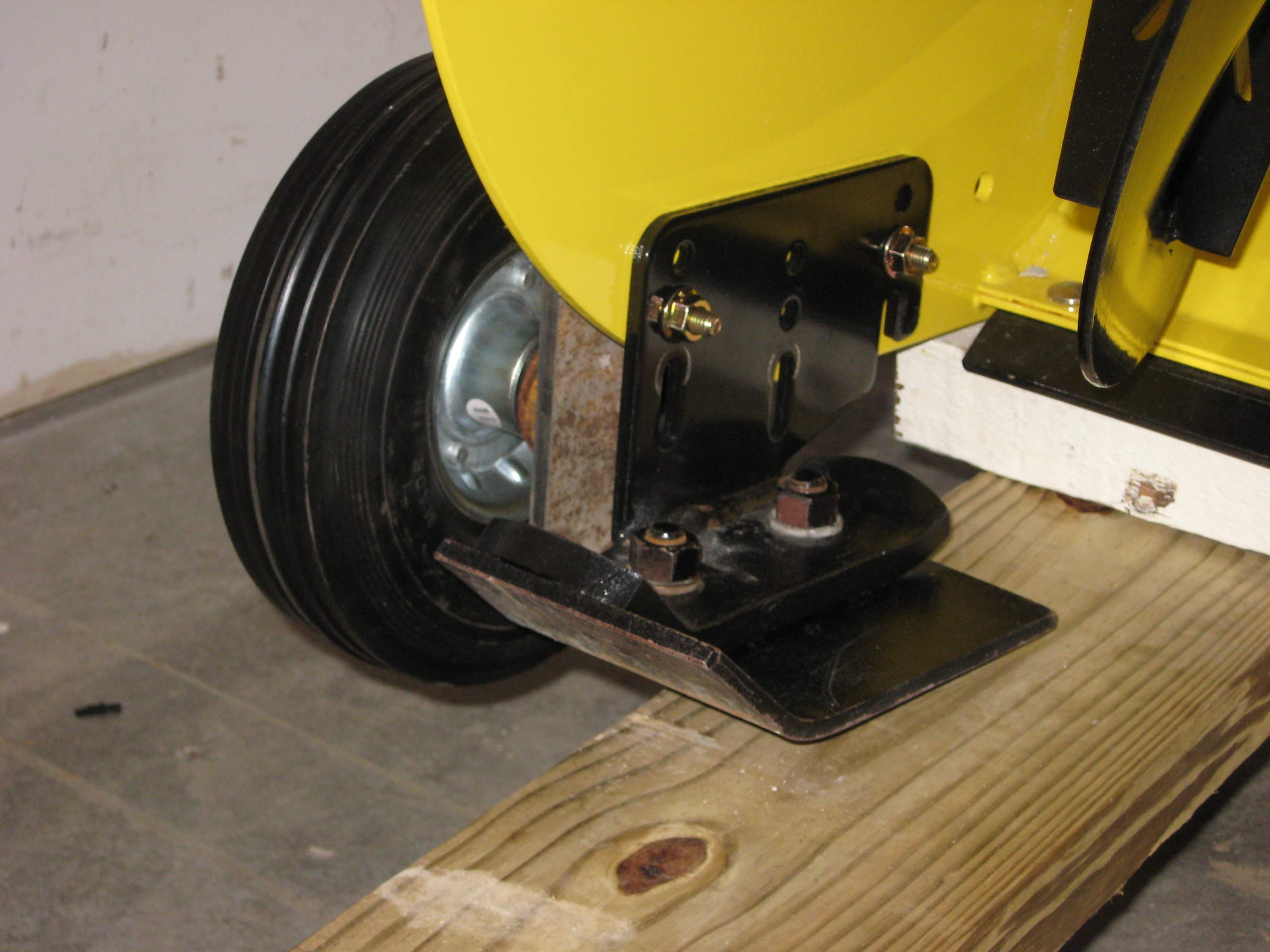

As everyone knows, snowblowers tend to dig into gravel drives. So, I tried enlarging the skids on my 54 blower, but it didn't help. Then, I decided to add wheels to the skid plates.
To do this, I cut some pieces of 3x5 angle and 5/8 round stock. Welded onto the skid shoes as shown and added some 8 inch wheels from HF. Did a test run on the drive today and it looks like they're going to do the job. Now, we probably won't get any more snow this year....

Nice job. I guess they are narrow enougth to not get you caught up in snow on the sides.
You'd think they'd make such a thing as an OEM option. Maybe a roller on the backside, like the lawn striper things.
Also wonder about a piece of pipe (rolling or fixed) from skid shoe to skid shoe. Like is done with blades for stone.
   / Gauge Wheels for JD 54 Inch Snowblower
I'm sure they're going to push a little snow. Hoping that won't be too big of an issue. If so, then, back to the drawing board.
Someone recently posted a full-width roller setup for a rear blower on here. I believe they used some wide boat trailer rollers and it looked great.
I wish there was a way to set the loader to act like the three-point hitch for snow operations, i.e., be able to maintain a certain amount of lift to hold blades and blowers off the surface, but still have no down force.
As it is, your choice is either "float" which forces the blade/blower to ride on the surface or "non-float" which locks it in place. In my opinion, neither one works best for snow clearing. I guess mabye I'm making the case for a rear blower, but I don't want to admit it.... It would still need gauge wheels to work on gravel though...

I like the idea of the guage wheels, my input is to wish they'd pivot rather than be rigid.
