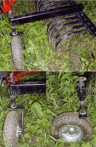

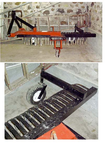

Here is a photo of the set I made for about $20.00. Also made a set for a buddy of mine for about the same $$. Used scrap steel and only had to buy the wheels and tires.

Hi, I dont want to be a pest but can you describe the way you made the gage wheels? I'm going to give it a shot. Just got a welder. thanks, brett
   / gauge wheels for my rake #9
Brett, They say a photo is worth a thousand words, so here are 3K worth of words! Boy sure saves alot of typing! /forums/images/graemlins/grin.gif Just copy these if you have any questions just ask. The castors are 1" rods inside of pipes and the spacers are just pieces of the same pipe cut off. The rest is just 1/4" steel.
   / gauge wheels for my rake #10
thanks, I printed the pics and took some notes. Just got a welder and looks like a good little project, brett
