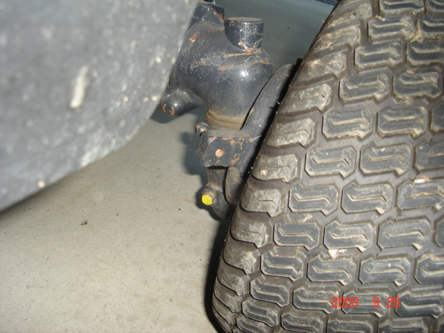

Hi , I have a 2007 MF 2310 TLB. Great Machine. I have a question about the hydraulic fluid. I had the tech come out and do a 300 hour service. Basically fluid and filters. Tech never drained the the front axel, just the transmission. He said it's all connected together. Is there any truth to this or are they 2 separate systems? Should the front end have been drained also? Please share your thoughts. Thanks.
   / GC 2310TLB Steering #2
Are you inquiring about the steering cylinder or the front axle?
Steering is all the same system.
Front axle is totally separate fluid from hydraulics.
   / GC 2310TLB Steering #3

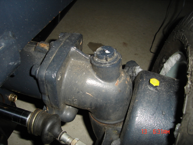

Wow, a 15 year old machine with 300 hours. You might want to get the front axle fluid changed out. Lift up the front end so the front axle swings free. Easiest way to get all the old fluid out. The fill plug is plastic, take it easy tightening it.
   / GC 2310TLB Steering #4
What oldnslo said. Axle requires draining/re-filling separately, but steering is part of the main hydraulic system. There are two axle drains, at the bottom on the rear, but only one fill plug on the top of the left side.
