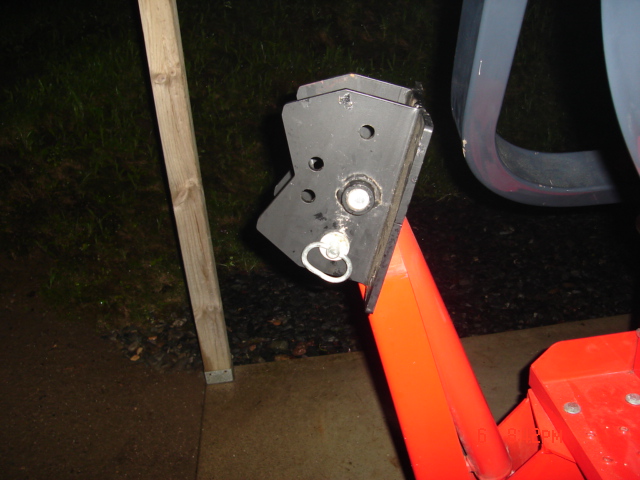

Has anyone flipped their stabilizer feet over so the pointy end goes into the ground? The BH on the GC is very strong and has no problem yanking the tractor around. The flat side of the feet are smooth and seem to slide on the ground. I'm wondering if flipping the feet over would give the stabilizers a little bit of bite on the ground and keep the machine in place a little better. They seem to be designed to be flipped over, but I don't remember the manual making any mention of this. I'm a little concerned about the hydraulic cylinder fitting at the end of the stabilizer are getting damaged if I flip the foot over. I'm also thinking I could bolt a couple pieces of channel steel to the feet to have a edge to bite into the ground. Then the fitting would remain protected with the feet in their normal position.

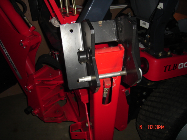

I had a 2310 and yes, absolutely flip the over for ground use. Actually the stabilizers on these units are very well designed IMO and you will be surprised at the difference. When you pull the pins to flip them you will see how the position holes line up to reinsert the pin in a different position to prevent your concern.
The flat side is ideally for the optional bolt on rubber street pads for hard surfaces like concrete or a surface you did not want to damage.

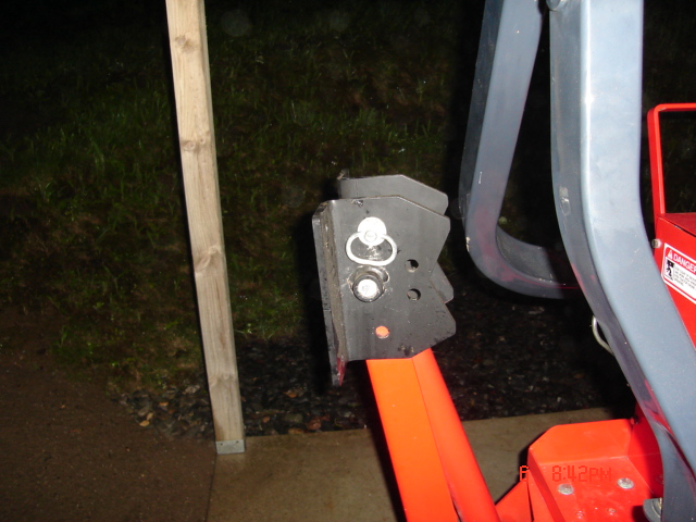

Yep- pull the pin, flip over, re-insert pin. Here's some pics of how I did mine.
  • b-h arm:foot.JPG
    b-h arm:foot.JPG

i found that the 'pins' in the stabilizer feet are basically useless, and once you really put the machine to the test they will just fall out and dissapear.
i run without them now. its quite easy to just raise the outrigger and flip the base one way or the other from the operators seat, depending on what you want.
one thing i did notice is that, when flipped (pin or no pin) there is a piece of flat bar running crossways that hits against the outrigger cylinder rod. there is just no way around it and no adjustment of the pin makes any difference.
