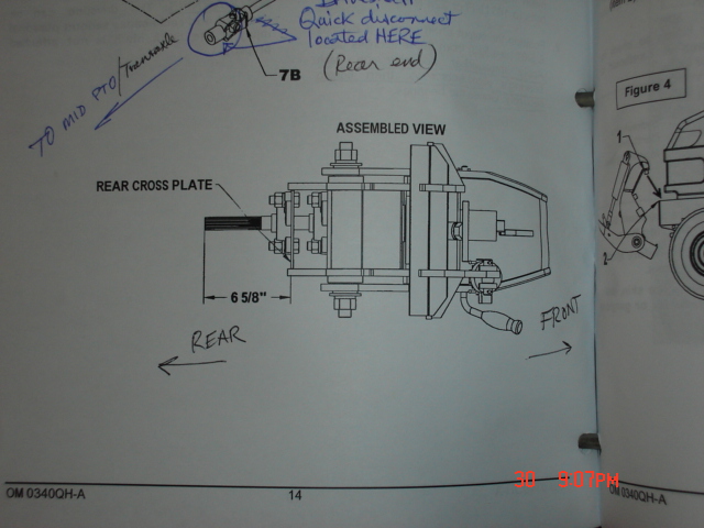

I'm wondering if anyone has a scan or a PDF of the installation manual for the front blower/blade and quick hitch that I could have a look at. Thanks

Installation manual for a 2360 snowblower for a 2005 GC2310TLB. Thank you
   / GC front blower/blade #4

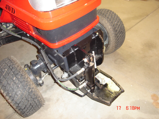

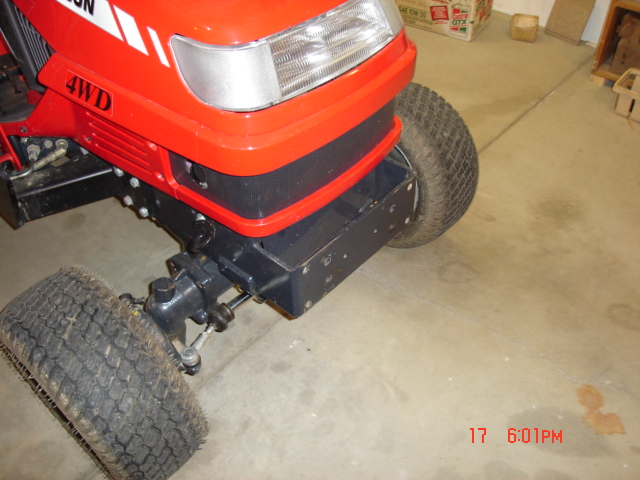

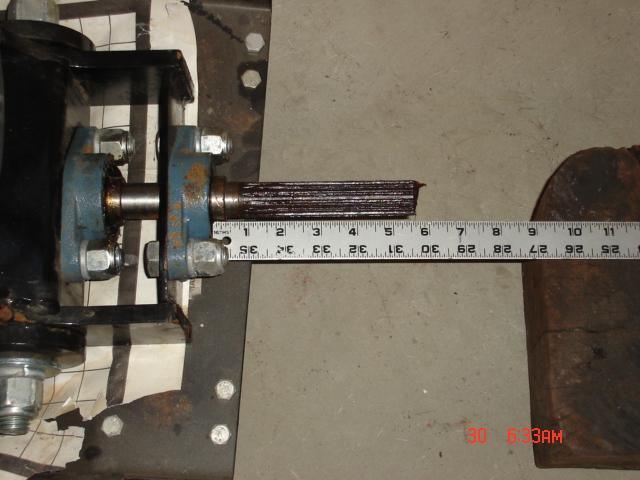

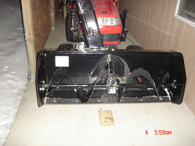

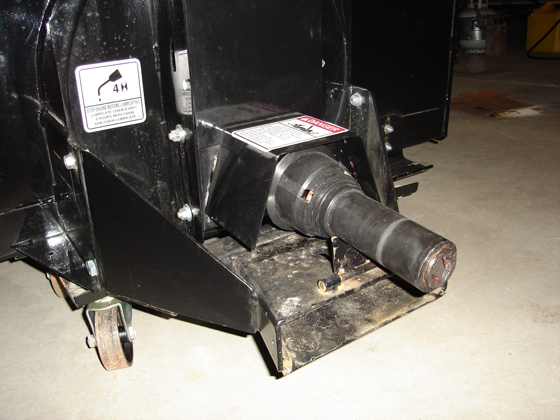

Here are some shots of the MF set-up.

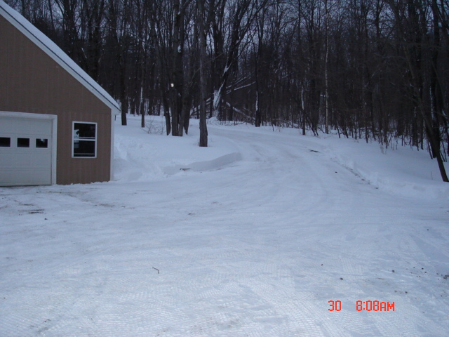

Simple:
Expensive, but worth every penny if you get a fair amount of snow every year.
Throwing dry snow 40-60 feet is not unusual; wet snow 20-35 feet. Just imagine... no high piles on the edges of driveway; even main road snowplow "leftovers" are not a problem.:D

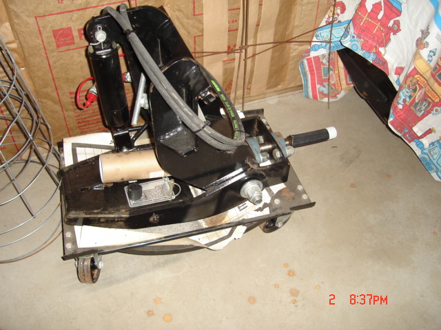

IJ, how hard is it to install and take off the Quick Tach? I see you have the pieces on dolly's is it difficult to install the blower after Quick Tach is installed?

Of the four attachments/implements I own, the blower is by far the easiest to attach & remove.
With FEL off, I dolly the quick-attach assembly over to the tractor (after grille guard is removed), lift it up and "hang" it on the front frame cross-member, tighten up the large T-handled bolt, then attach the two hydraulic hoses. Last thing to do is add the mid-PTO driveshaft. It goes from the front of the HST to the rear of the quick-attach. This operation takes me about 8 minutes, and I'm pretty slow (careful). It takes longer to remove the grille guard than to put the quick-attach on.
Putting the blower on & off is very easy. You saw the dolly; the front edge of the blower rests a 2x4, to get the right angle. I just slide it up to & onto the shoe, ensuring that the driveshaft stub on the front engages the blower's shaft as I do this. When it's shoved on all the way, pull up on the locking pin lever (on the shoe), secure with a lynch pin, then hook up the flat-four electric connection --that I added-- for the chute. Done.
Since the quick-attach assembly can be left on for FEL use (though it hangs low-- be careful!), removing the blower is only a matter of easing it down onto the dolly/2x4, releasing lynch pin & locking lever, and sliding off, after electric is disconnected. Takes maybe 2 minutes- really! If I'm going to use the FEL, of course, the two blower hydraulic lines are disconnected and tied up out of the way (velcro strap).
