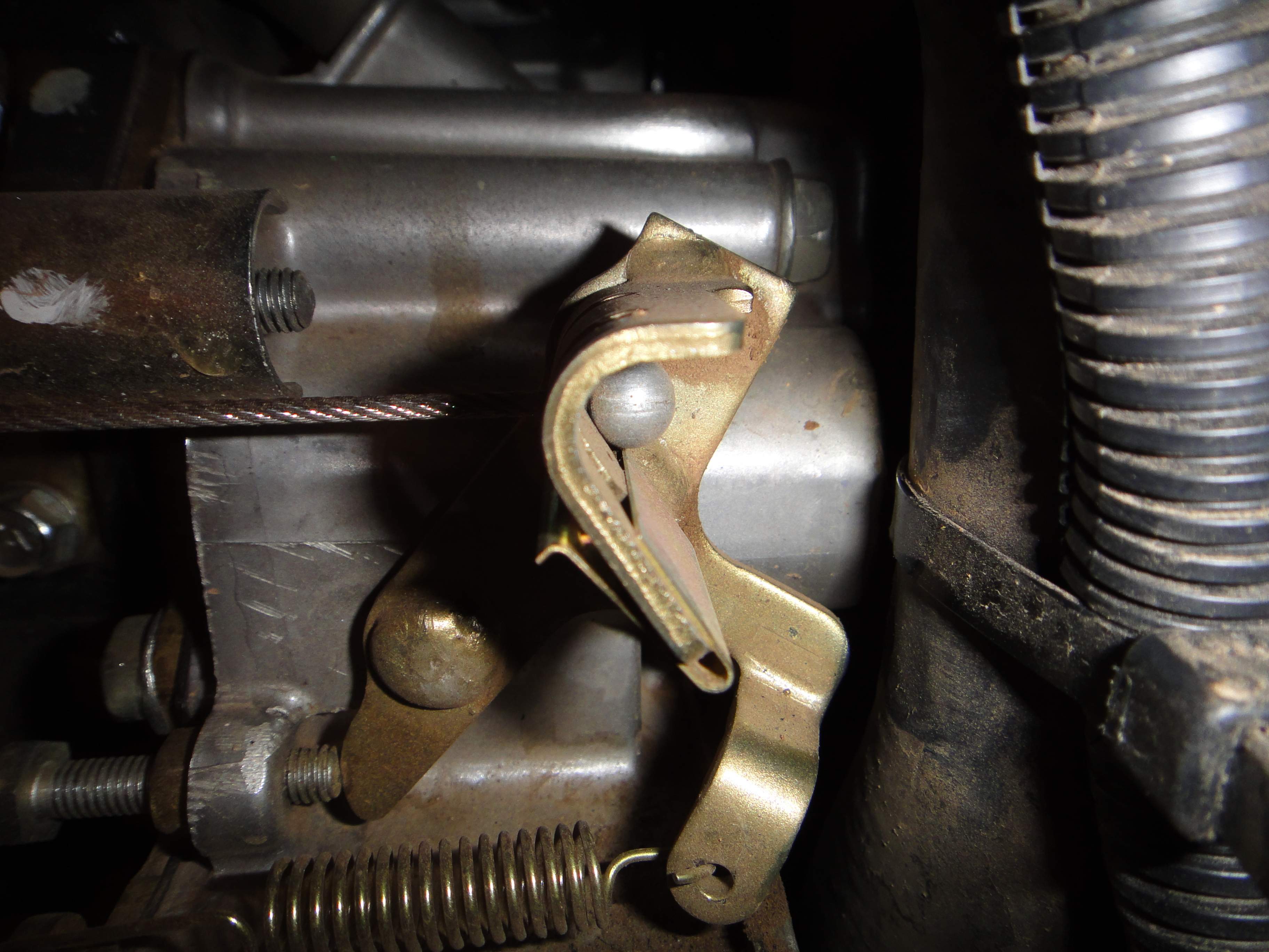

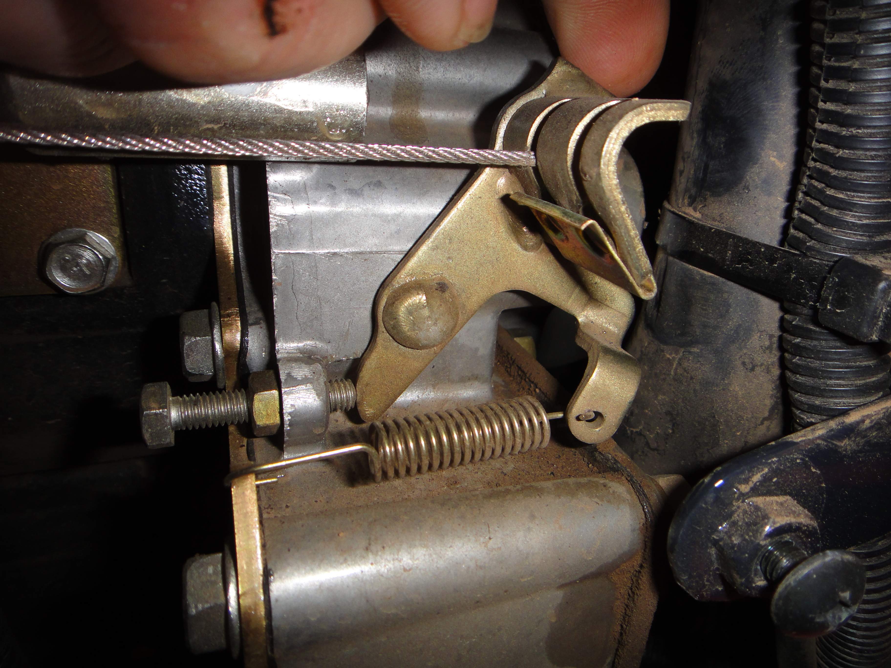

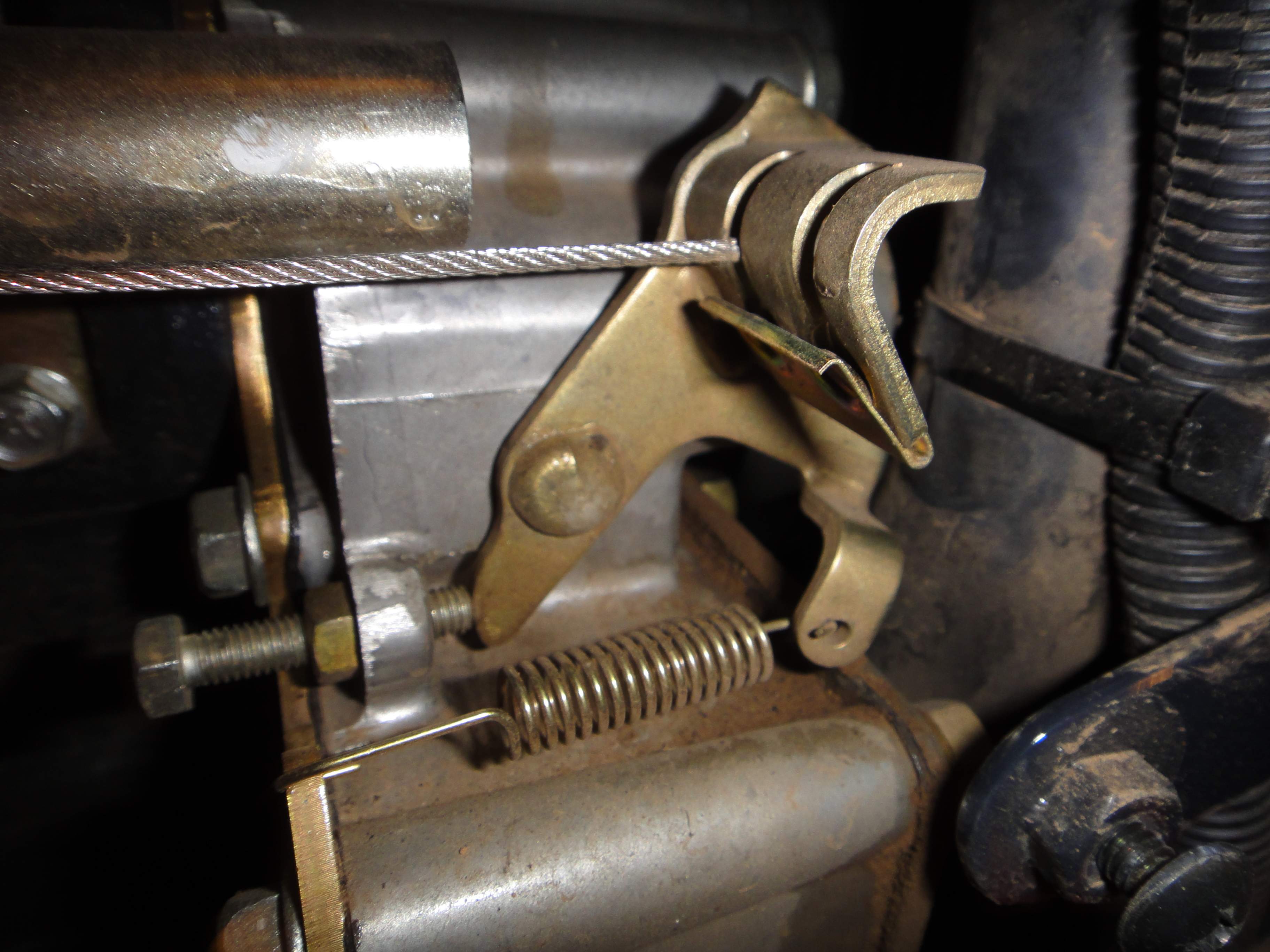

Here are some pics:

   / GC owners check your lower coolant hoses! #7
Wacky, I have JUC04114, and just checked it. The throttle linkage has been rubbing the lower radiator hose. After 86 hrs, there's some wear on the hose, so I added another tie wrap to keep the hose away. I think all GC owners may want to check this one. Thanks for passing this info. along to us.
Dave K.

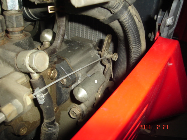

   / GC owners check your lower coolant hoses! #8
It sounded as though this fix only applied to 2400 and 2600-series tractors, but I just took a look at my 2310 to be sure....
They did use a different set-up on 2300-series models, so we don't have anything to worry about...:)
Good to know, in any case.

I have a 2410 JTCxxxxx with 114 hrs and my hose has a wear issue from that lever. Going to tie back & protect .
Thank you for the post , may never of found that until it was to late !!!!
