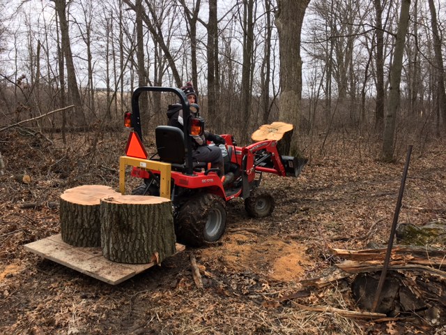

I built a combination trailer mover and weight holder for the 3pt on my gc1715 so I can quickly change weight amounts.
I have my rears filled with w. W. Fluid and my 3pt can carry anywhere from 90 pounds (just the unit) and increase by 35 pounds per Steel cube up to 5 cubes. . . . All Steel - dense 5 inch cubes. I've never needed anything more even lifting Max loads with the fel or plowing big or small Wisconsin snows. Personally I don't like using concrete because I want the weight low (very low) and I don't want it movable in any direction. By doing it this way not only do I have excellent counterweight to either heavy or light fel loads, but it really helps on side hill issues which I certainly have. And by having it on the 3 pt. It's very adjustable if desired and behind the rear axle nicely but not hanging far out in the back . By the way, all my Steel cube weights I sprayed with rubber so sitting outside is a no rust situation.

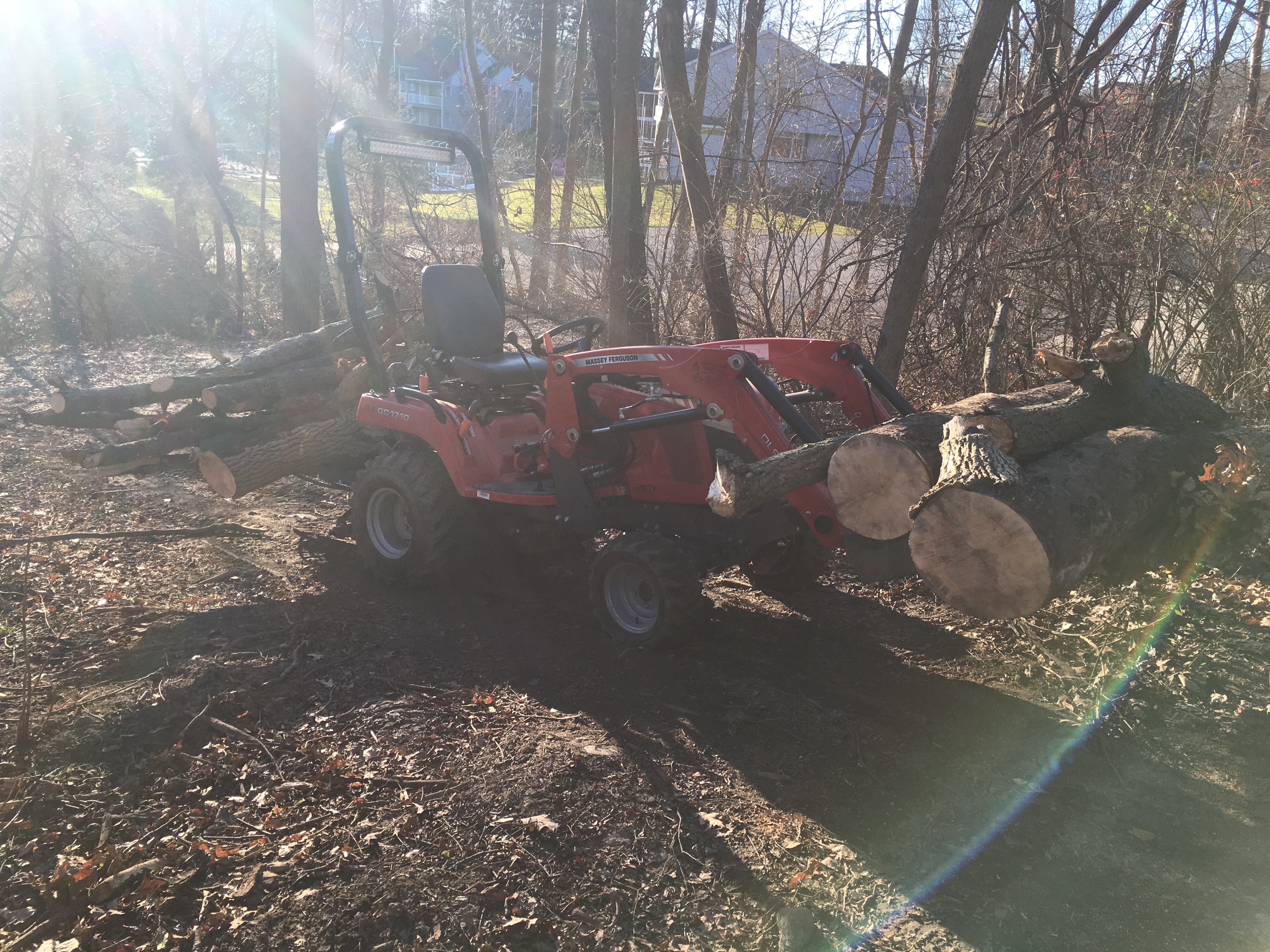

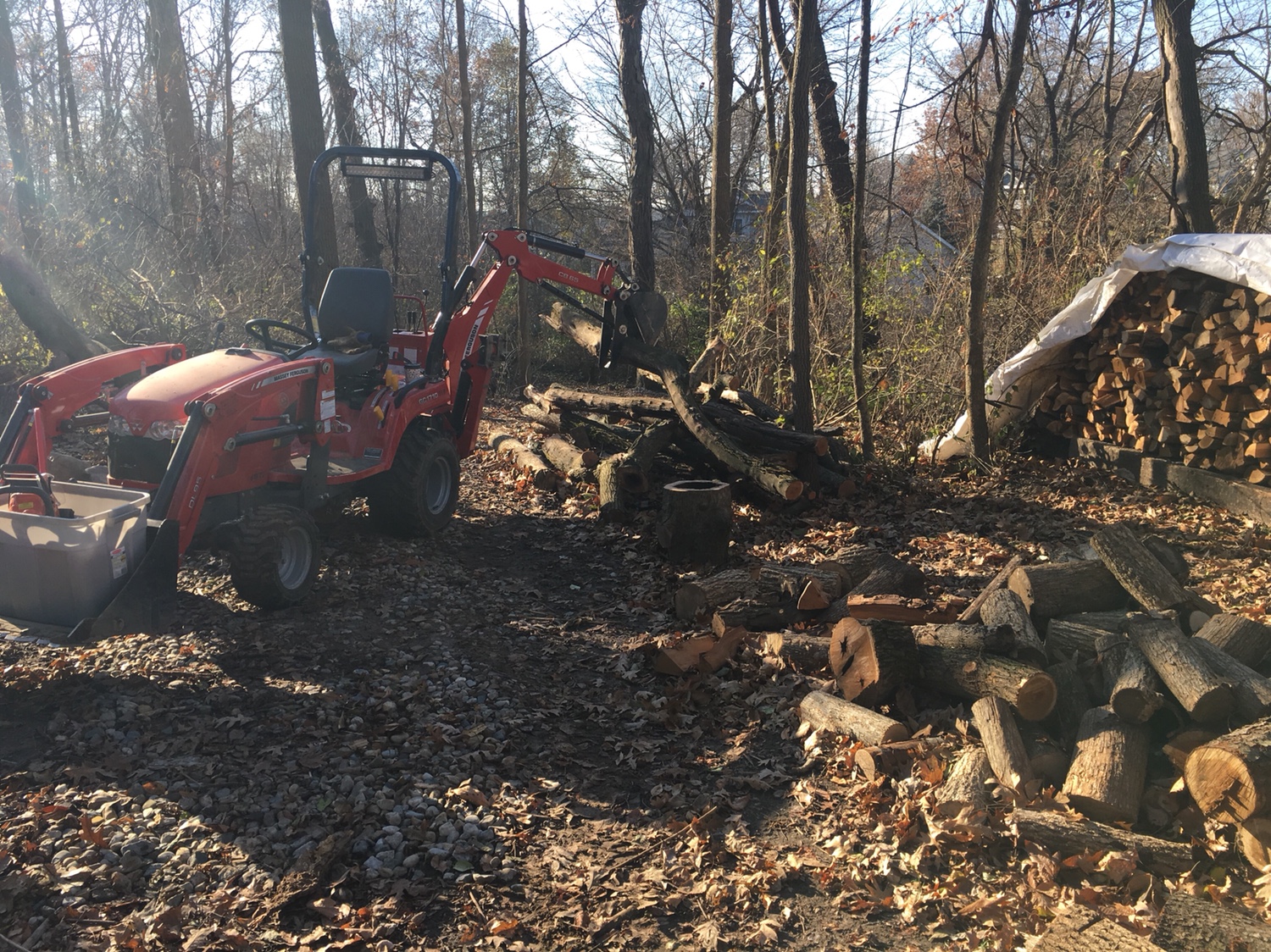

This was over doing it a bit a few days ago. A tree fell in the neighborhood and I fit just about all of it on one load......when you do this make sure you are never in 4x4 with that much weight on you front axle on pavement (or even on soft ground for that matter)...I use the shortest Titan forks and they are over a Piranaha Bar which actually adds some strength to the bucket as well...
The branches on the back are just resting on the log splitter.
When the hoe is on it's easy to max out the FEL.....when it's off I really try and watch what I pick-up or add ballast in the back like this picture....I run a little low on front pressure and use the sidewall flex as a way to measure FEL load....works fairly well...if you are squatting and the FEL hydraulics still have power to lift then you need more rear ballast.
