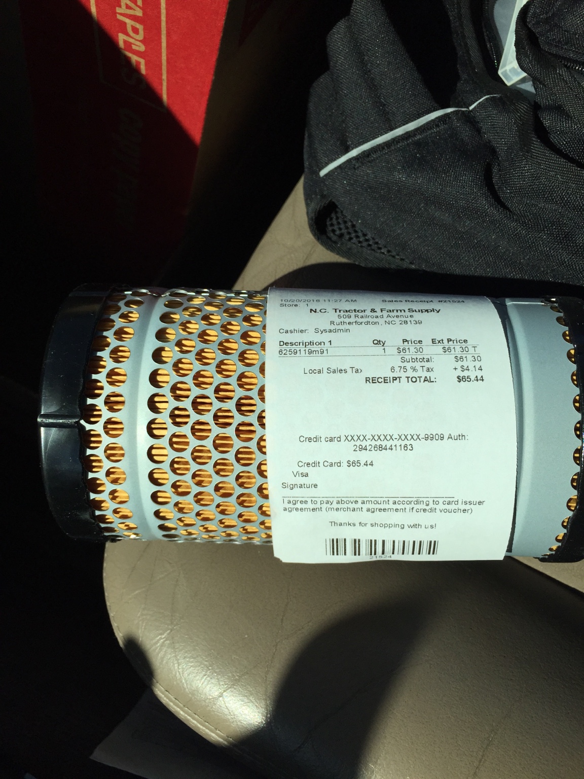

yea that crap is expensive when i purchased mine i had them throw all the filters in on the deal.
