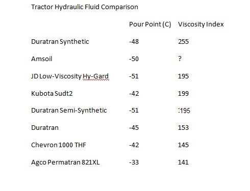

I always look at the Pour Point and Viscosity Index of my fluids. The lower the pour point, the easier it flows at low temperature. The higher the VI, the less change in the fluid, so it does not thin out as much when at high temperatures. You get what you pay for, from the base stock to the additive package (which can provide up to half of the lubricant's qualities)
A little bit of my history. The hydro filter ruptured on my GC2300 on a cold morning startup with the factory fill fluid. It was too thick (too high a PP) for the cold temps. it happens. That was at 35 hours.
Taken by the Dealer for an early 50hour service, who used what I assume was a Permatran spec'd bulk oil. By 110 hours, the oil looked like chocolate milk due to water contamination. Changed it out again. I looked for the best oil I could find. Amsoil wasn't readily available, but was able to get the Duratran full Synthetic. I've used it for 2 changes in the last 12 years, never an issue with it. Tractor currently has c. 800 hours, and due for another change.
SCUTs run hotter than larger equipment, a quality oil benefits them greatly. There are no actual specs for these oils, "meets spec" can be very deceiving. If you are running in extreme cold, and hot summer temps, a quality hydro oil is necessary. Before determining on price alone, determine the hours/years that the fluid will be in the tractor. Do you really save that much?
Added a little chart that compares some of the oils. I rated them as I think they rank, so take it with a grain of salt. Due to the combination of price/availability my next change is going to be Kubota SUDT2.
