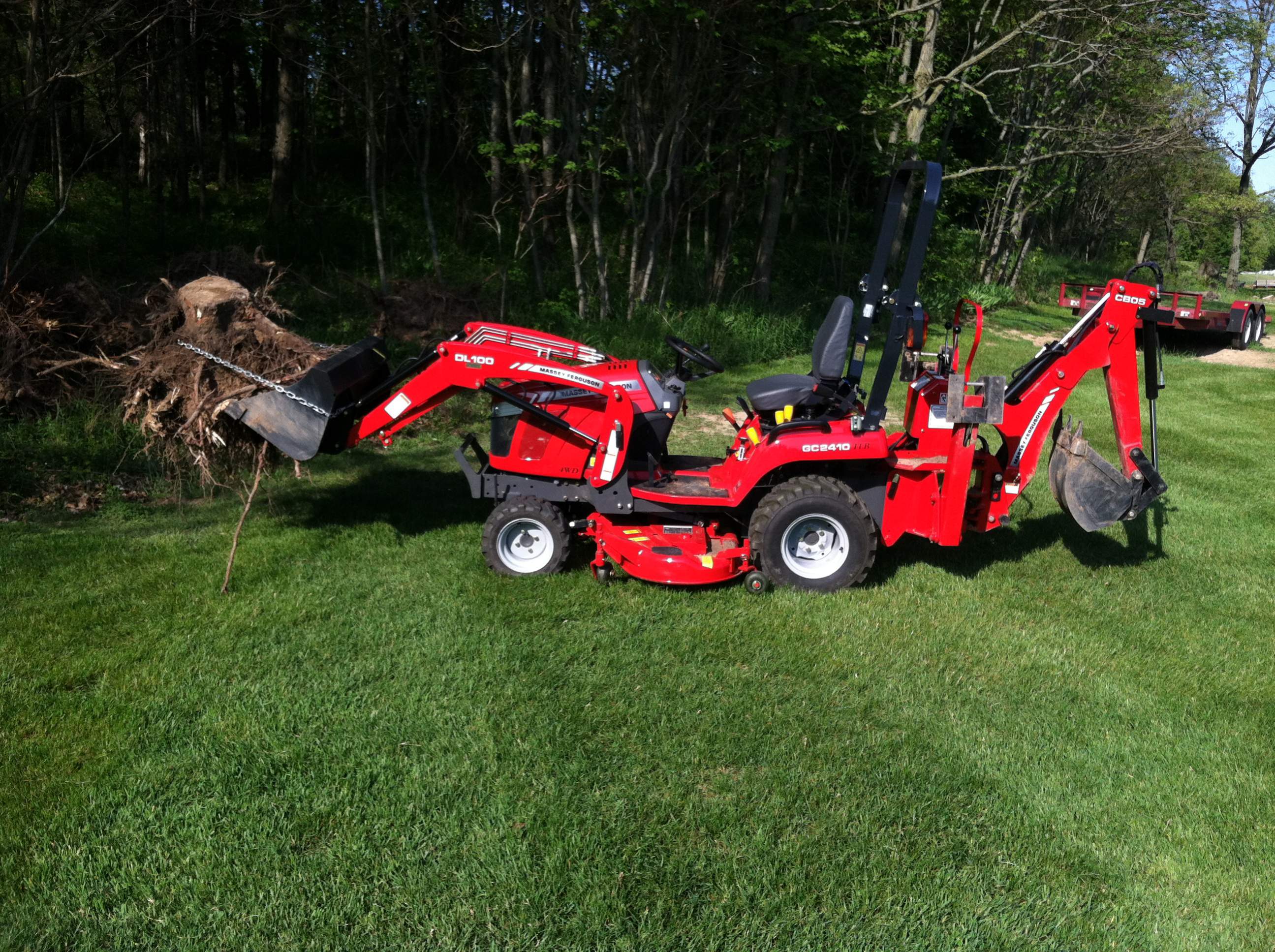

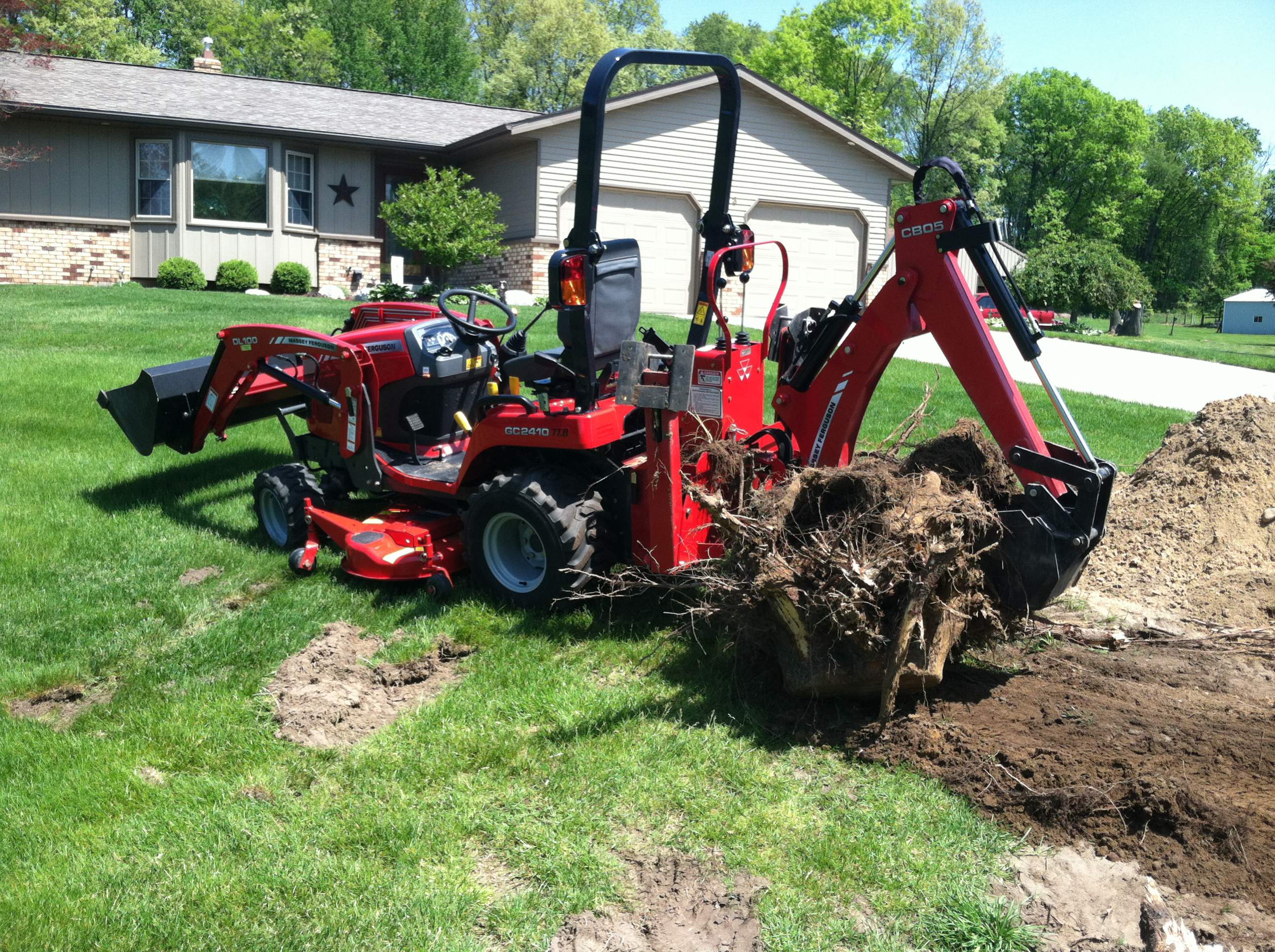

I've had my GC2410 for two years now. I have removed somewhere in excess of 16 stumps. Granted, some I had to cradle with the backhoe to move because it was too heavy to lift with the loader, but most I moved with help of a chain and the FEL.
Man that is some pretty green grass to be tearing up with that BH! Nice report and thanks for the feedback.....need all the Massey GC traffic we can get here..this forum is all BX!
