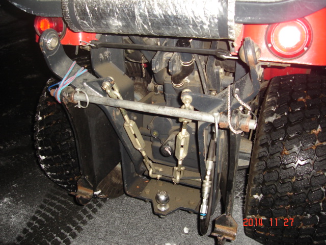

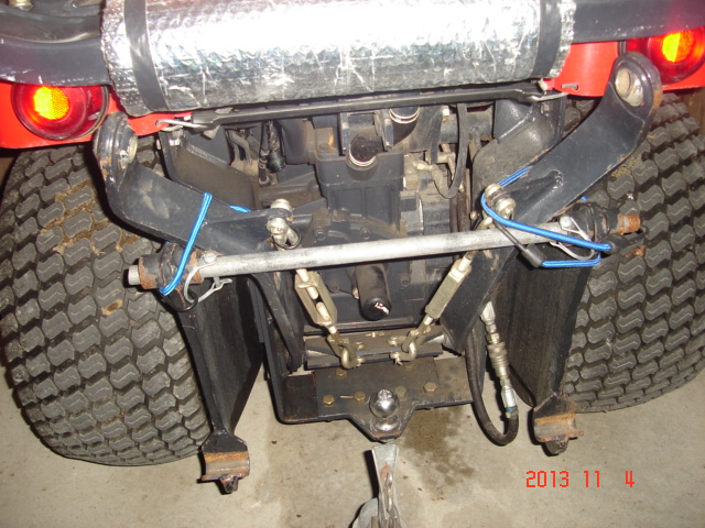

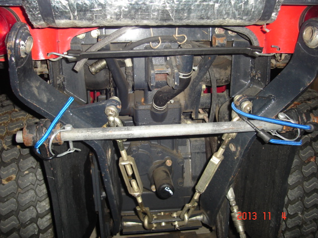

When raising and lowering the MMM, the 3PH arms will also go up & down, and there's no way to stop that. When I first used the tractor for mowing, I discovered that the lowered 3PH arms would dig into the turf when I started up a steep incline, leaving two pretty deep grooves. (Took me a bit to figure out where that was coming from.)

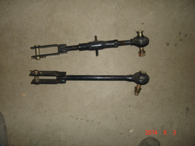

What I did to remedy the situation was to remove (pins & clips on one end, 7/8" --wrench size-- bolts on the other end, second pic) the two links from the 3PH arms at the top of the transmission and "store" the lower arms behind a piece of EMT tube that I slipped through the BH mounting holes. Making sure the hydraulic hoses were held out of the way (used a piece of #10 copper wire), the 3PH transmission arms could then go up & down all they wanted to (verify clearances!) with no issues. I also use two small bungees to hold the lower 3PH arms spread out so the transmission arms won't touch them when they go up & down.
Most of the time I don't use the 3PH anyway, and when I need the BH I just push the lower arms up & under the rubber bungee cord that came with the tractor and pul out my EMT tube. When I do need the 3PH (like now, for a tiller), I just re-attach those two links. Sorry I'm probably not using the correct names for these pieces, but hope you get the gist of it.
I'll attach some pics that hopefully show what I'm talking about.

Amazing, thank you so much! That's a great idea and a the pics are a huge help. It would have taken me weeks to get my pea brain around the concept otherwise. :) It's very much appreciated! Now if the 3pt hitch will actually function on the new unit I'll be needing to rig something up soon. :)

You are most welcome. On that EMT tube, if you look closely, you can see where I drilled holes all the way through it and used a pair of those clevis pin/clip things to keep it from sliding out of the BH mounting pin holes.
