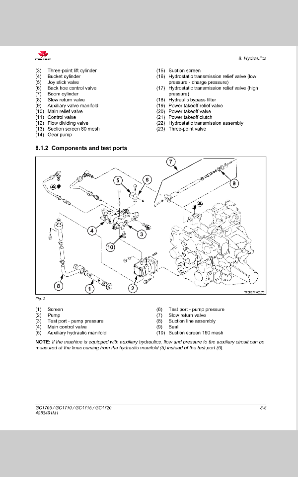

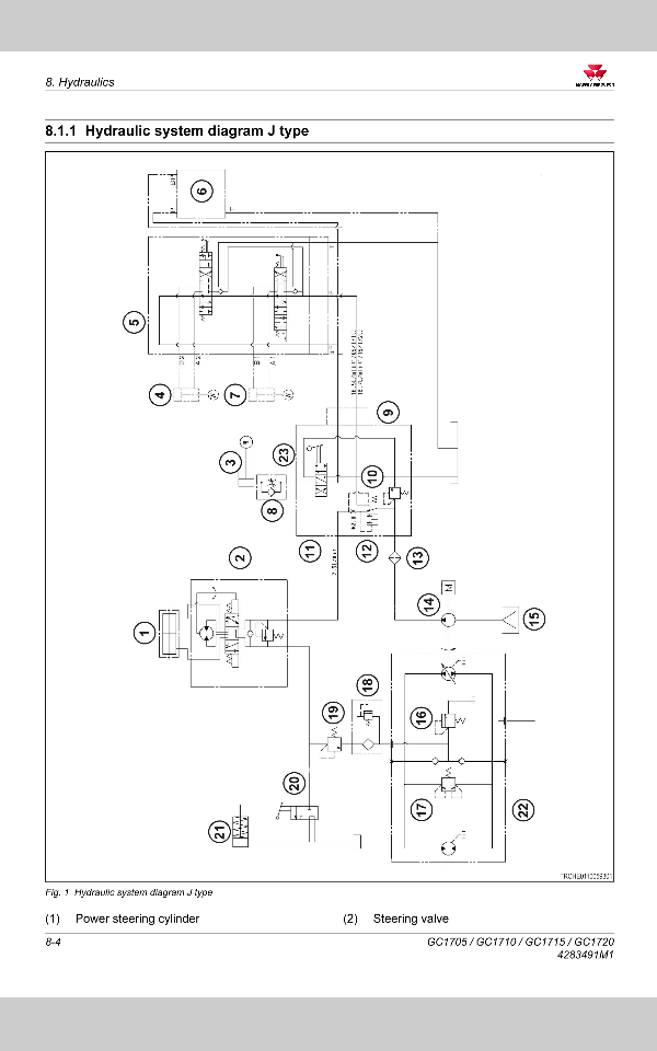

It has very little fluid to begin with. It only takes a short time to loose enough to impact system operation. I would start with repairing the hose and checking the fluid level. If I am right, that line is before your transmission. If it is leaking nothing else works. It's hydraulic pump runs every thing. I will check my hydraulic schematics when I get home.

I don't think you have hurt anything. Most likely the fluid is low and has sucked air loosing prime. I would repair the hose and add fluid slowly. Start the tractor and idle for a few minutes to allow prime to be gained. Get it back to the shop and top off fluid on level surface. Screenshot_2016-08-28-06-15-43.pngScreenshot_2016-08-28-06-16-13.png
