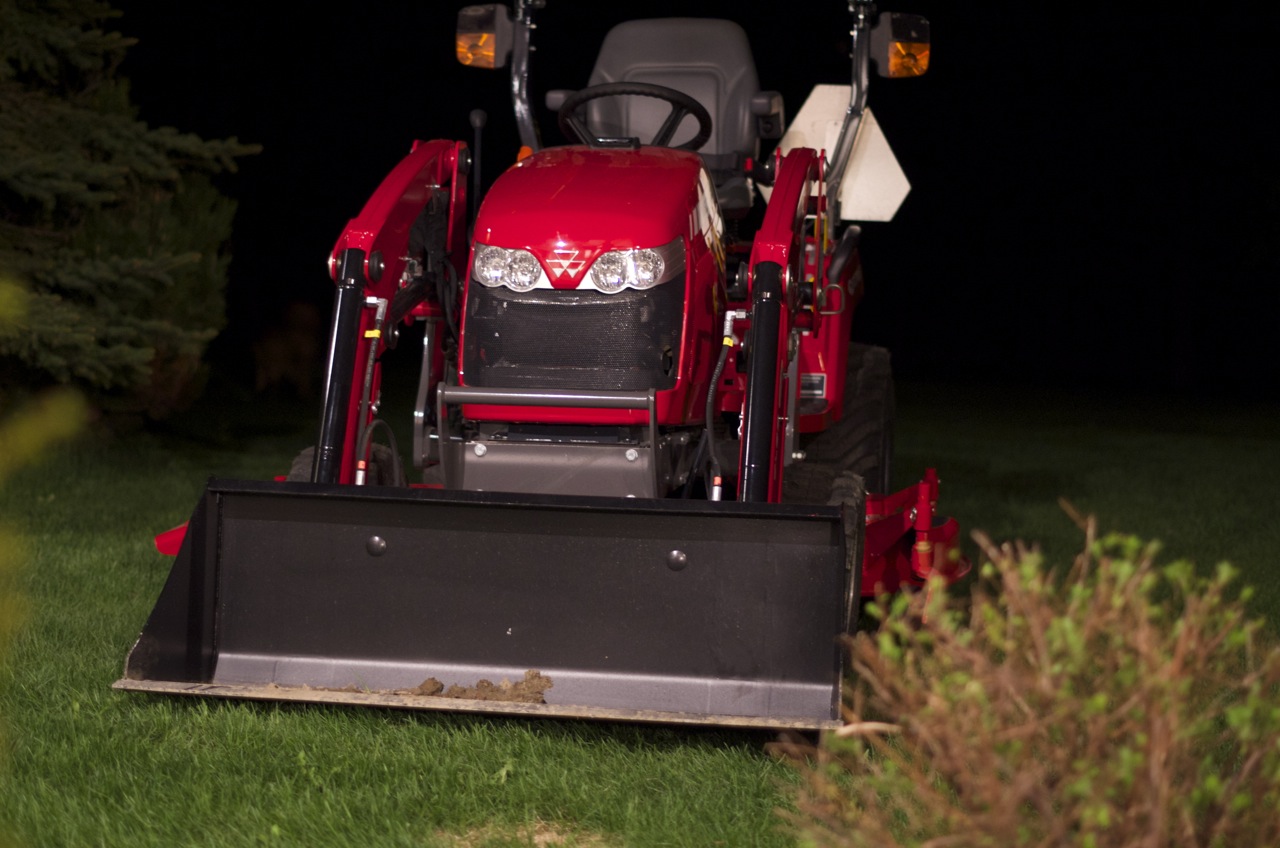

I hope I'm in the same boat. We took delivery of our new GC1710 this afternoon and, to be honest I'm feeling pretty deflated and like I've made a mistake. The dealer had a real tough time getting the drive over deck to connect. We had to keep taking the 3 mounting points off and try hooking different combinations over and over. Lots of wedging, heaving and cursing. The deck is on now, but sitting might crooked. 3 pt hitch/mower deck height is inoperative. After 2 hours the dealer basically cried uncle and said they'd be back to fix it. I've tried hooking up the hydraulics the two possible ways. One was let it down once and not enough to hook up the mower deck easily. The other way raised it. Once. Something is clearly amiss.
It drove over the deck easy though ;) I have 5 acres that have exploded and are crying out to be cut and mountains of earth that are supposed to be moved with a box blade this weekend. It doesn't look like either of those things are going to happen. My sense is that there was no pre delivery set up/check done on the machine and my confidence in the decision is shaken to the core. Forking out this kind of money was supposed to free us from the hours lost to the constant breakdown and repairs we'd dealt with buying used, lesser machines. I'd looked closely at Kubota BX and JD 1 series before deciding on the Massey. The Massey appeared the most robust to me. I really hope I wasn't wrong, but if I could jump into the way-back machine right now I'd have a tough time not going green or orange. If the weekend doesn't bring a complete reversal I'll likely demand the dealer take it back, refund our deposit and cancel the deal.
Now that I've gotten being whiney ***** out of my system, I have to say that it sure is a pretty thing to look at!

Sorry you're having such trouble! But hang in there, I doubt you made a mistake. These are really tough little workhorses; I'm sure the dealer will get it working.
   / GC1720 Three Point arms do not go up. #9
Thanks for the encouraging words. That's good to hear. I still can't yet shake the feeling that it was built on the Friday before a national holiday… perhaps one where the Saki flowed freely at lunchtime ;) Said in jest as I'm sure that a good bit of the assembly happens this side of the ocean and my issues (apart from the possible rear plumbing mix ups) may be set up goofs. I noticed tonight a bolt going through the floor pan, mating the rear section to the front section was missing it's associated nut. A bunch of little things. A few things not optioned out correctly upon delivery and some things agreed upon missing, and dealer questioning that they were to be included (thankfully I made sure there was an email trail of what was agreed upon). I am a believer in a positive outlook leading to positive outcomes, so trying not to let this sour me. On that note, again I thank you for the encouraging words! I'll let you know how things go :)
