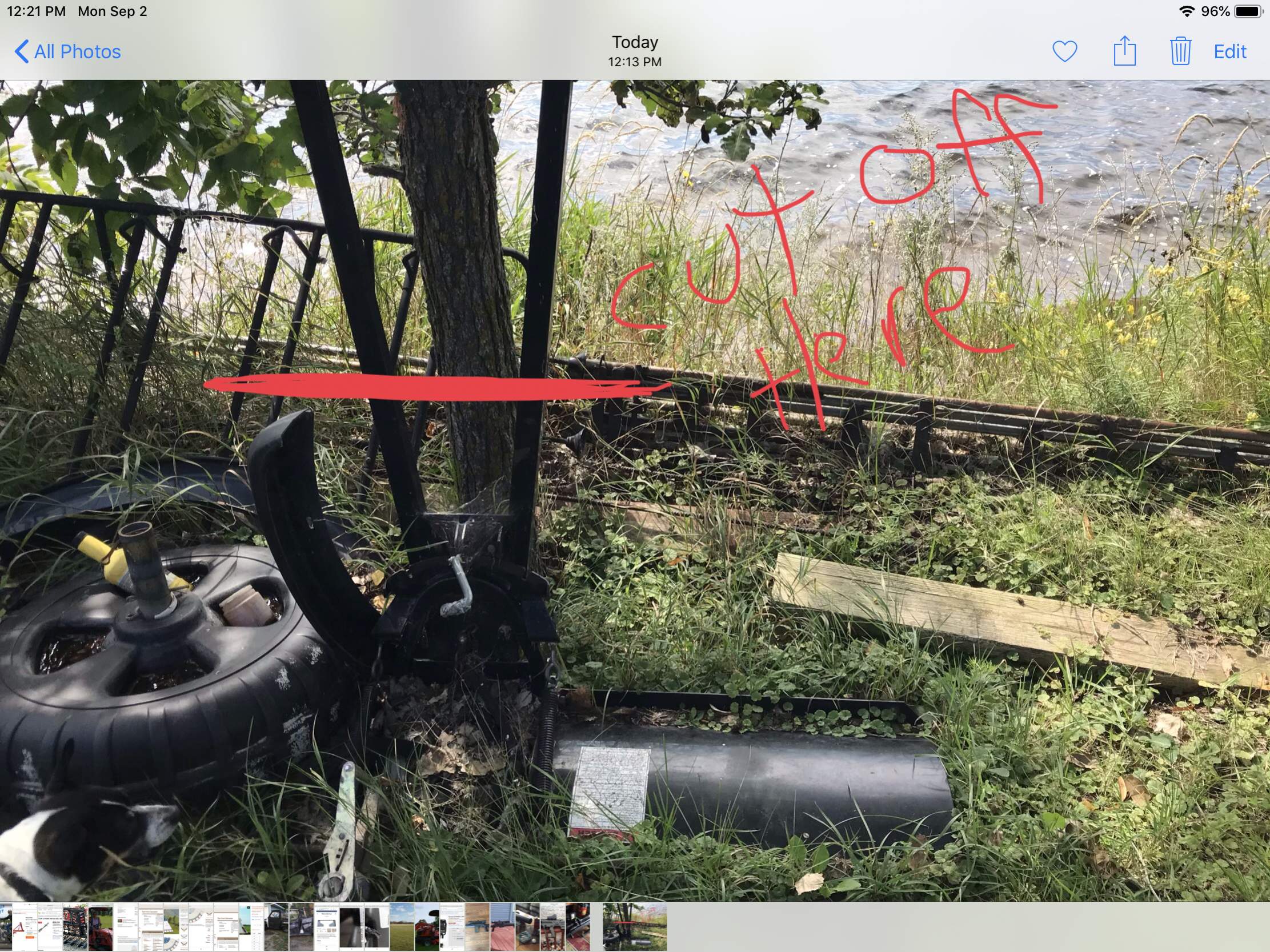

I have a 60 inch complete snow blade setup from a older Polaris ATV I do not use anymore so I am going to convert that to attach to my bucket on my GC1705.
Jim.
My neighbor did the same, it works but don't try to push frozen banks back, he bent it almost in half doing that..

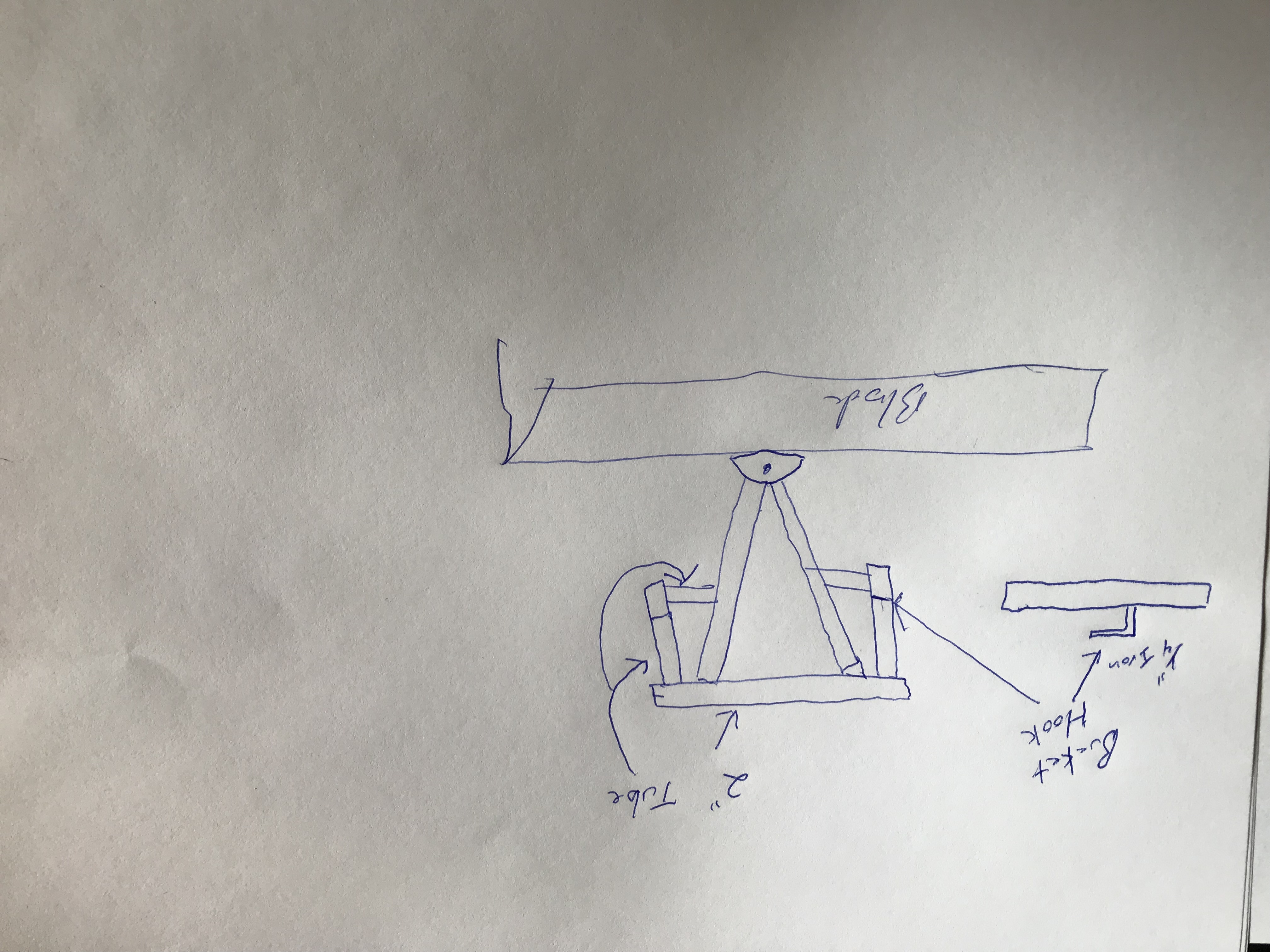

   / GC17xx tractors, clearing snow with the bucket. #9
This is my plan to build the bucket attachment for blade, my basic plan of attack. I will use tie downs or chain with binders to hold it on to the bucket, just a quick basic drawing.

You know what, I've seen somebody do that on youtube. But another real nice option there, if you got quick attach mounts on your loader, I saw this fella on youtube, he took a craftsman snow/dozer blade like I use on my gt, hacked off the mounts and raise mechanism, and then welded the rest of it onto a ssqa backplate.
It was pretty sweet, but I could see improving on the design, even. He took off the cable that pulls back the pin to change the blade angle, so you gotta get off the tractor to change the angle. Me, I woulda left that cable on, route it up one of the loader arms, and mount the handle somewhere comfy. That way, to change the blade angle, just pull back on the handle and ram the blade into some snow at an angle to angle it left or right. Yeh, I may just fab that up myself sometime, we'll see.
