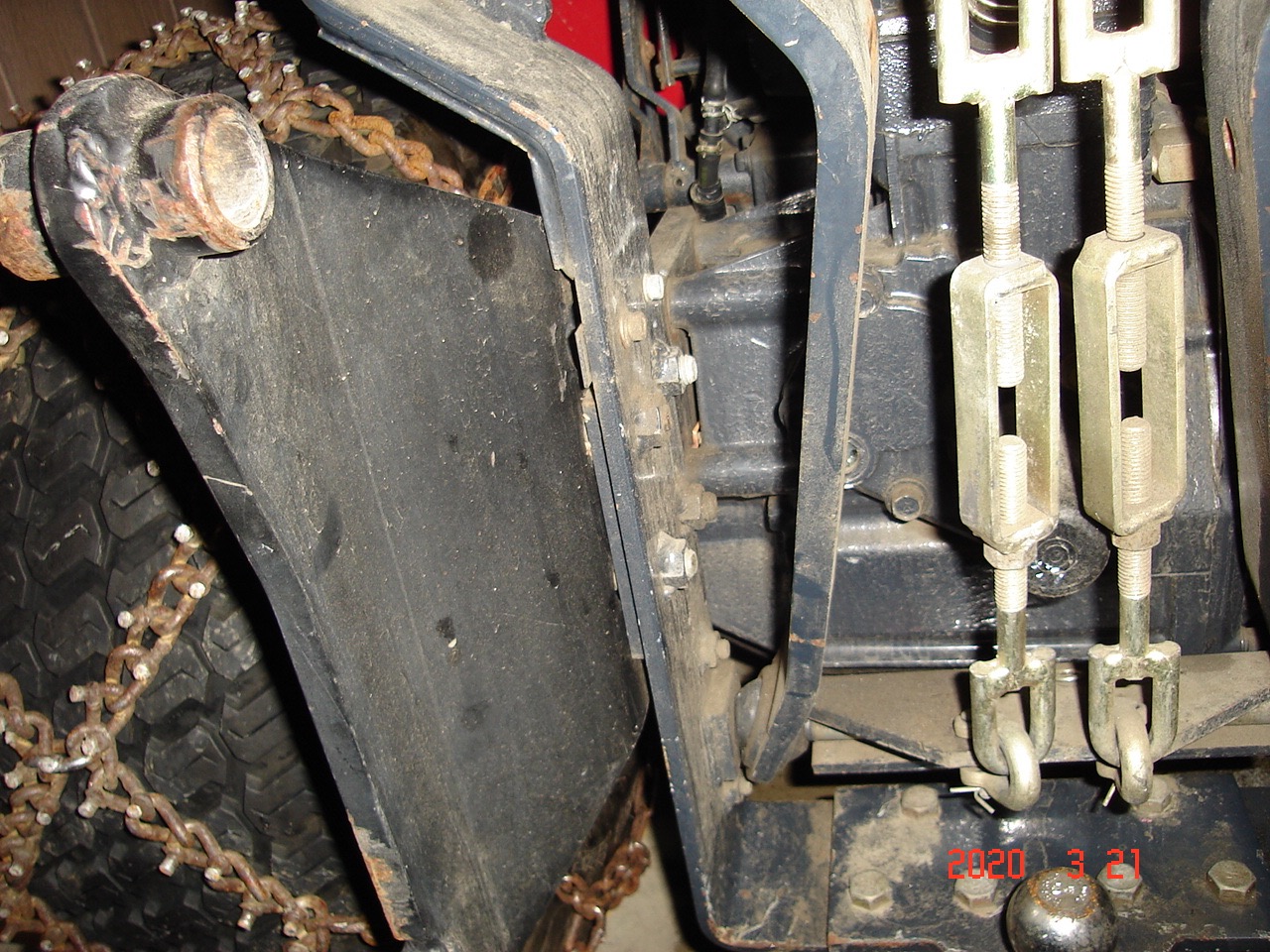

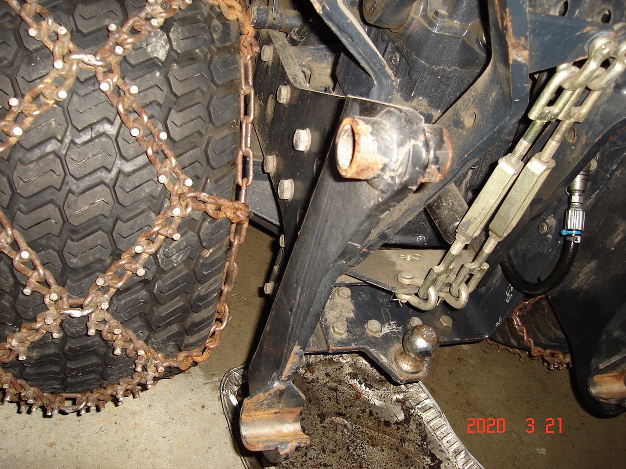

For those of you with a GC2310, what does your frame/linkages look like alongside the frame and up to the FEL posts? I'm in the process of building a backhoe and would like to see what differences there are to make it as close to "stock" as possible. Any kind of info (pictures/measurements) would be helpful! I'm not about to spend $1,400 to Wallenstein for their subframe... I have sufficient steel available and a welder to make it happen!
Regards,..
   / GC2300 4 pt. backhoe subframe #2
Well, that sounds like a heck of a project!

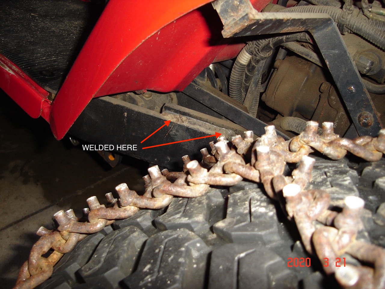

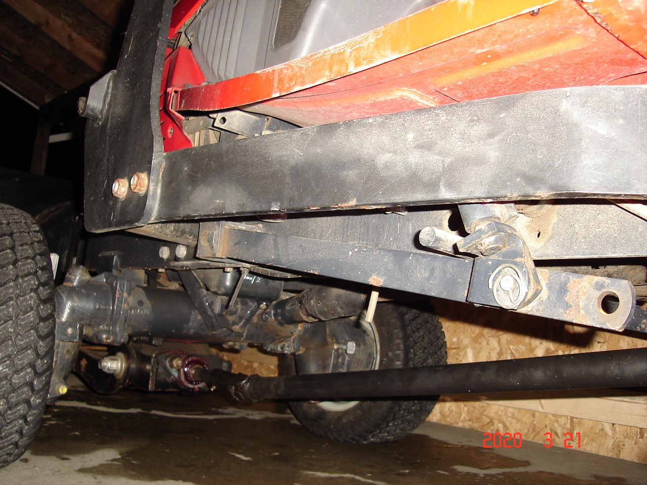

Just went out & looked at mine -- It appears to be 1/2" plate steel, bolted at the rear to the existing frame --but with some holes for existing frame bolts-- then extends forward, with a welded joint to a 3" wide beam that passes forward under the floor and eventually bolts to the FEL post. The rearmost section contains the "pocket" at the bottom and the holes for the BH mounting pins at the top. Lots of bends in the plate(s) to clear things under the tractor on the 2300 frame.
Note I didn't actually take a ruler out there and measure stuff, these are approximate dimensions. It's still dark out....
Here's a few pics.

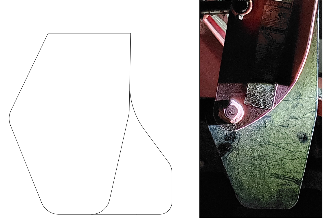

Thanks Irvingj! It looks like it is pretty similar with the exception of what looks to be the brake lever (adjustment) system. Of course, the FEL post does not have the excess steel to bolt the subframe to, but it will!

I haven't started a thread yet, but I will. It is quite a project and I'm anxious to get it all fabricated and put together! I may draft a CAD drawing of it for you guys to see before it's all finished.
