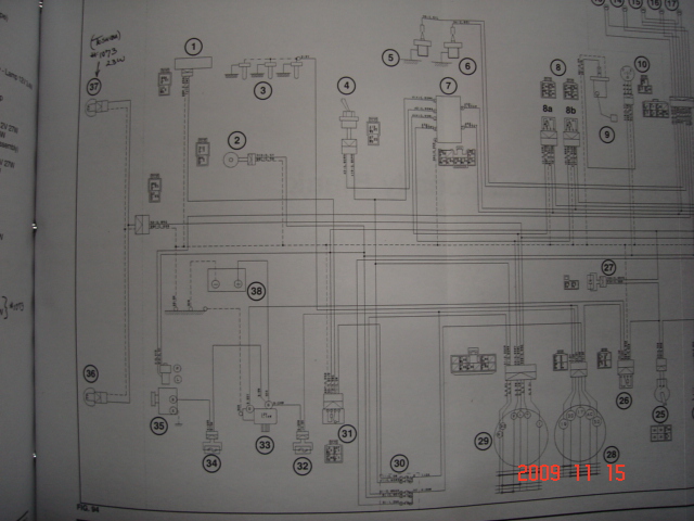

Anyone have any suggestions... When I turn the headlights on while the engine is running, engine immediately cuts off. I can turn the hazards and turn signals on with no problem. If the engine is off and I turn the power only on, the headlights and taillights work fine. I checked as many connections as I could locate and everything seems fine. Thanks for any help.

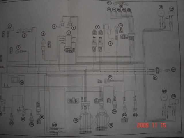

Do you have an electrical schematic of your tractor?
   / GC2300 engine stops when I turn lights on
I don't have a schematic of the tractor. Any idea how I can get one?
Thanks Labrat, I'll give that a try.
   / GC2300 engine stops when I turn lights on #9
Not real clear, but maybe this will help--
