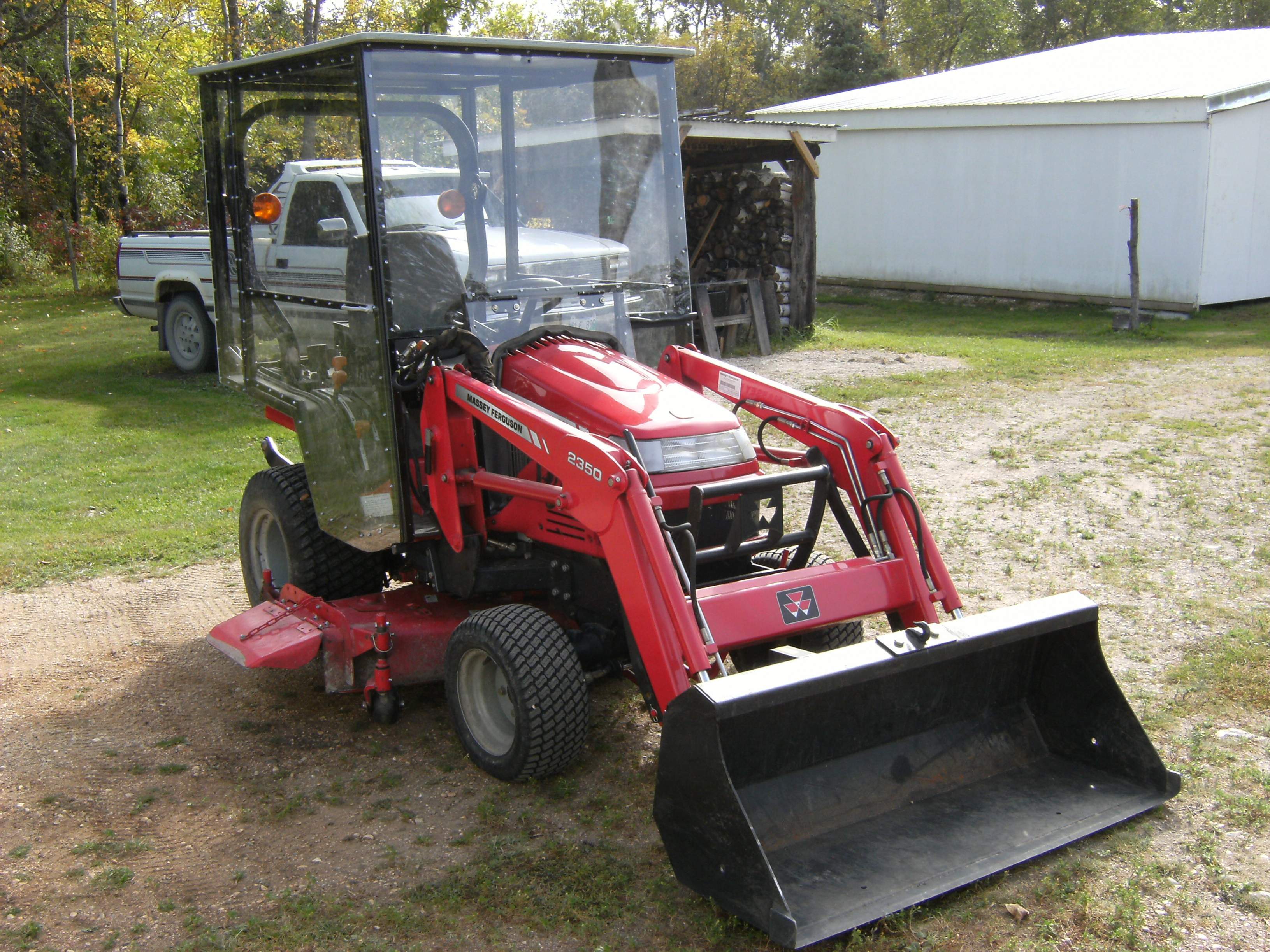

thanks for the replies,I'd like to post photo of my cab however where I'am located I'am on dial up and it takes forever to post pictures plus not sure how to do that in these threads. I'll try to give it a try my son gave me some advice and hopefully this will work with putting a picture or attachment of it here.used lexan for the all glass etc: have since put in a wiper and the heater since the picture was taken.the homemade quick hitch is also almost completed as well have to pick up the splined shaft and two snap on u-joints tommoro so hopefully it'll get done this weekend. as always Larry.
