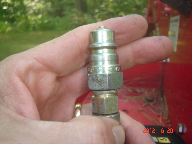

On my 07 2310, the connectors are "Safeway" brand. Local hydraulic shop had no problem cross-referencing them.
