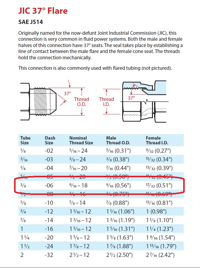

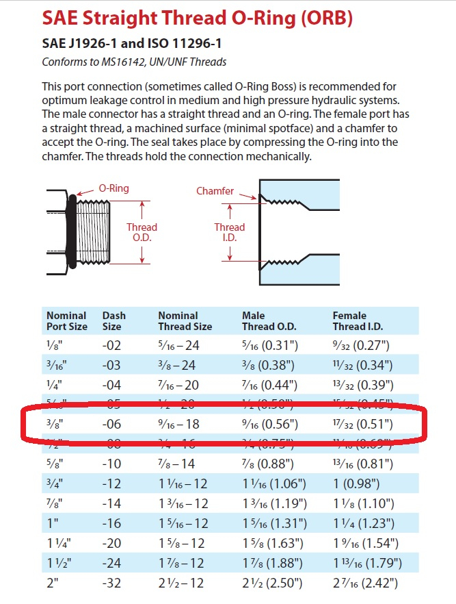

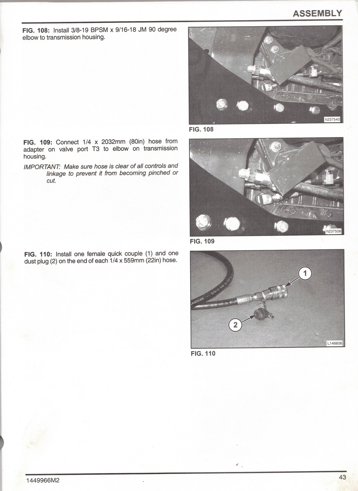

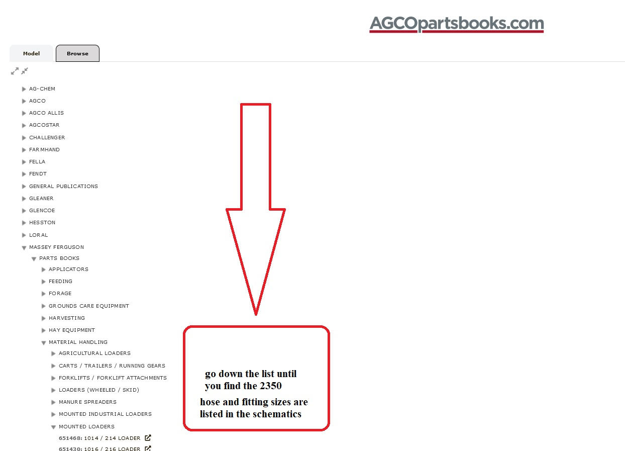

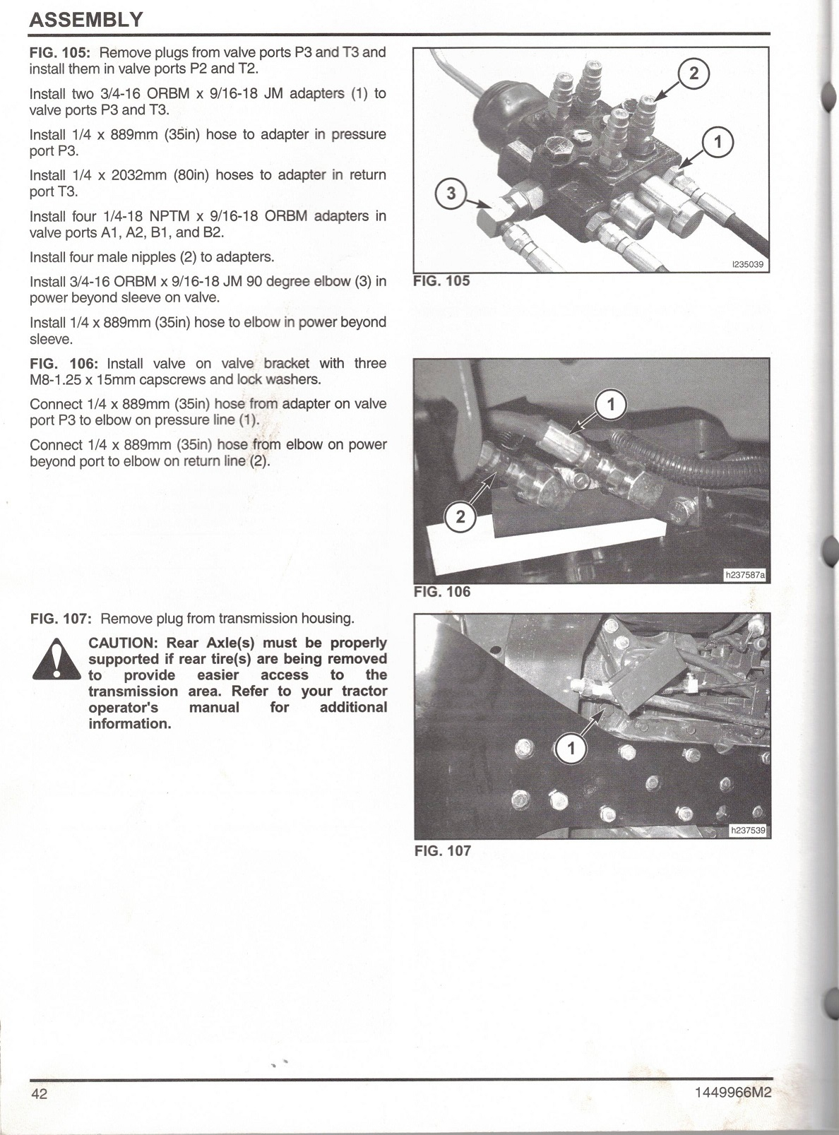

Bucket and loader arm hoses are ORB-06 and JIC-06 connectors, 1/4" hose. Hose lengths appear to include fittings. Do not use shorter, excess strain on connections. For the 13" bucket hoses I switched to JIC fittings on both ends and used a 45° adapter to reduce hose chaffing. All my tractor and loader hoses have been replaced from wear, excluding the 4 loader control valve hoses (quick connects), they are still original (900hrs).
For working on them, I have a bunch of JIC37 plugs and caps (male and female) to block lines/cylinders when disconnected. Saves a lot of mess from dripping oil.
