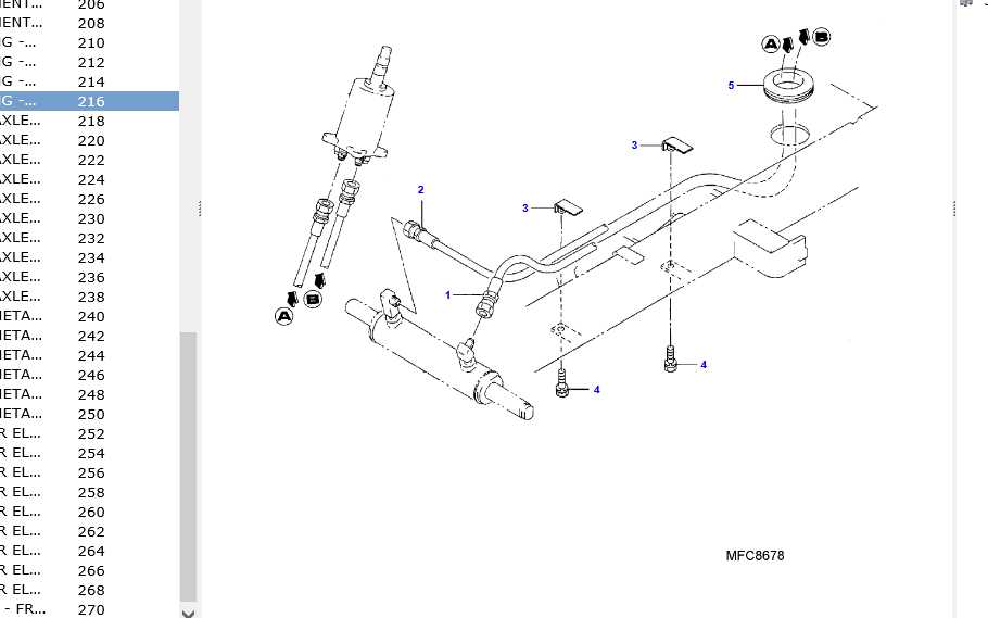

HI, I have my 2005 MF GC2300
is leaking from one side of cylinder.
I already order and received all replace parts to do the job.
my question is:
as that only have 2 tubes that connect the bottom cylinder to power steering box at top, where to add oil? as most of the oil already coming out?
and what oil to use?
I will appreciate your answer, before I start fix.
thanks
   / GC2300 Leeking steering cylinder #5
my question is:
thanks
rucaftaView attachment 557336
   / GC2300 Leeking steering cylinder #6
The steering is supplied from the same source (fluid and pump) as the main hydraulic system.

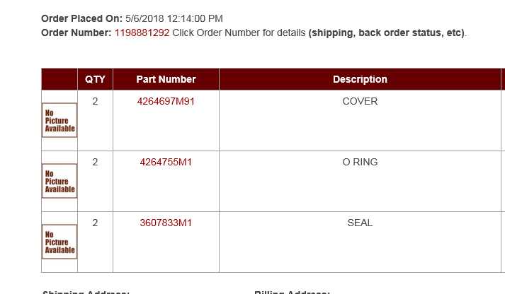

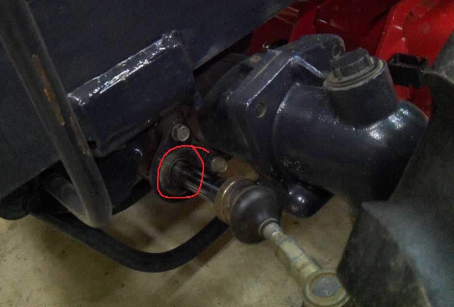

Well I finally removed the steering hydraulic cylinder from my 2004 GC2300. I disassembled the cylinder and replaced fours seals PN 3710935M1 and one one ring PN 4264755M1. There is one other seal at the center of the piston rod that I didn't replace. It that ones leaks it would not be visible since it would only leak from side of the cylinder to the other. It would cause a loss of steering force but not an external leak. Well, the dripping leak is gone. The most difficult part of the deal in the removal process from the tractor . You have to jack up the tractor and drop the from front axle from the tractor by removing the middle pivot pin to allow access to the hydraulic hose connections on the cylinder. I could actually see how badly worn of the fours seals was. The complete new cylinder from our MF dealer runs $927.00 including taxes and shipping. The four seals were $8.87 each and the o ring was $11.03.

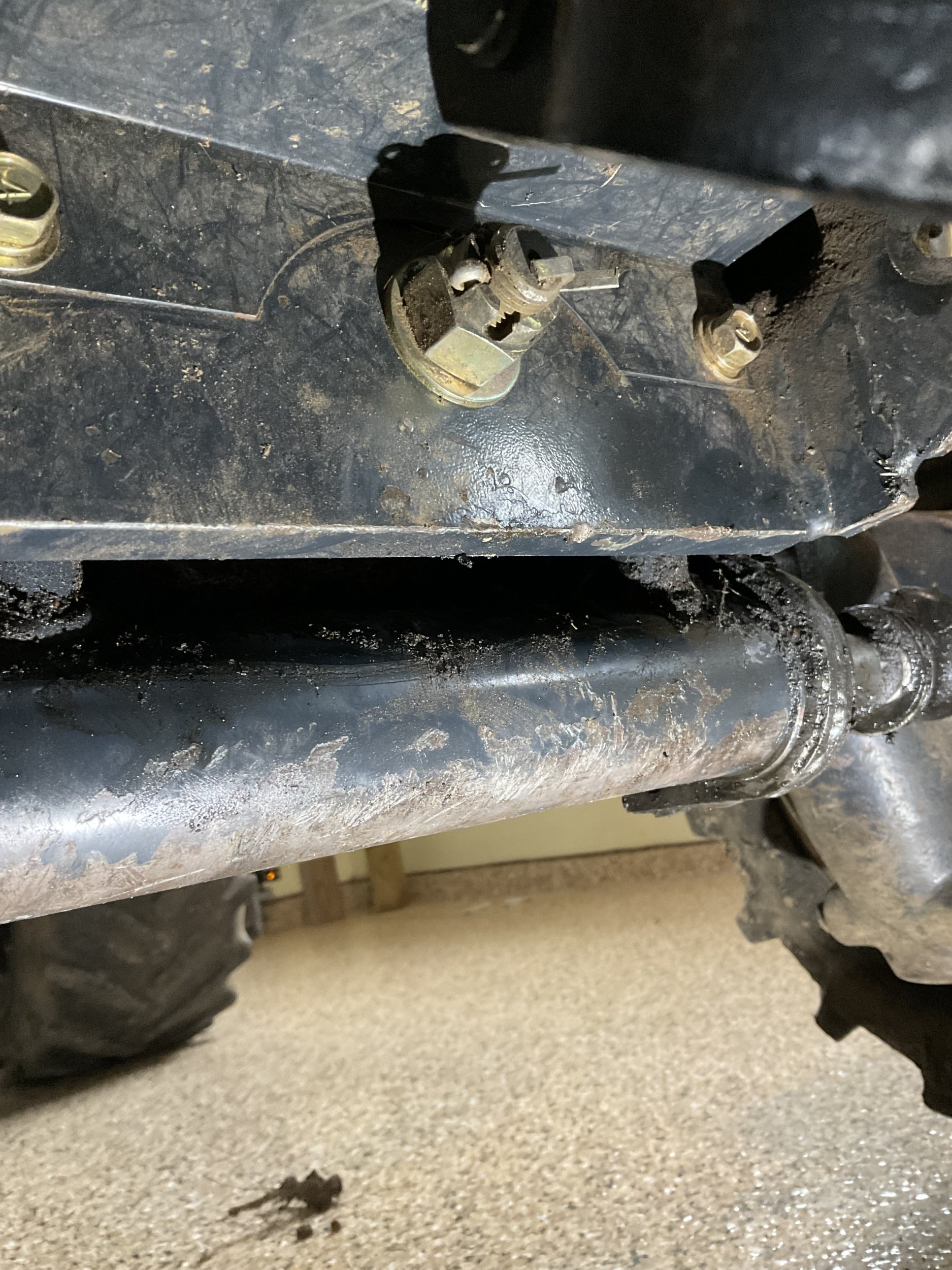

Rovera, I need to rebuild my steering cylinder as you did, is it really that hard to remove the front axle? I included a pic of what I think the middle pivot pin is.
