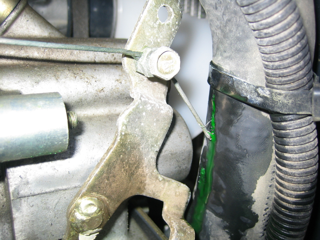

Noticed a bit of coolant leaking on the ground. Couldn't see anything so I took the side panels off. Found the end of the throttle cable had punctured the rad hose.

Looks like a bad spot to put radiator hose, I'll have to check my machine, the cable usually has a barb on the end so it isn't sharp . Manufacturer or dealer must have missed it . plowking
   / GC2300 rad hose leak #3
Checked mine and found it was almost worn through! Thanks DMW, everyone needs to check this. Bend end of cable at a 90 degree angle.

Thanks for posting DMW. Checked mine. The excess cable was already bent down at a 90 degree angle.

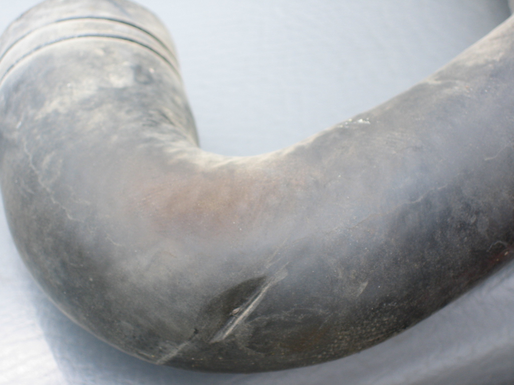

102 hrs, still under warranty (just under 2 years). Called the dealer Monday, going out tomorrow, they had to order the hose. Warranty? not sure yet. Took a closer look at the hose, wire puncture on top, AND starting to wear through from contact from throttle linkage on bottom. Bottom wear point will seep coolant, top hole has a steady stream. Also looked at top hose, could feel a groove worn in it from contact with the air cleaner :(. Looks like I will be installing protective plastic mesh on the new hoses.

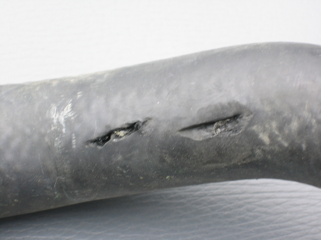

Included another poorly focused shot of hose with holes circled, please accept my apologies for the poor paint shop job ( shoulda got my kid to do it :) )

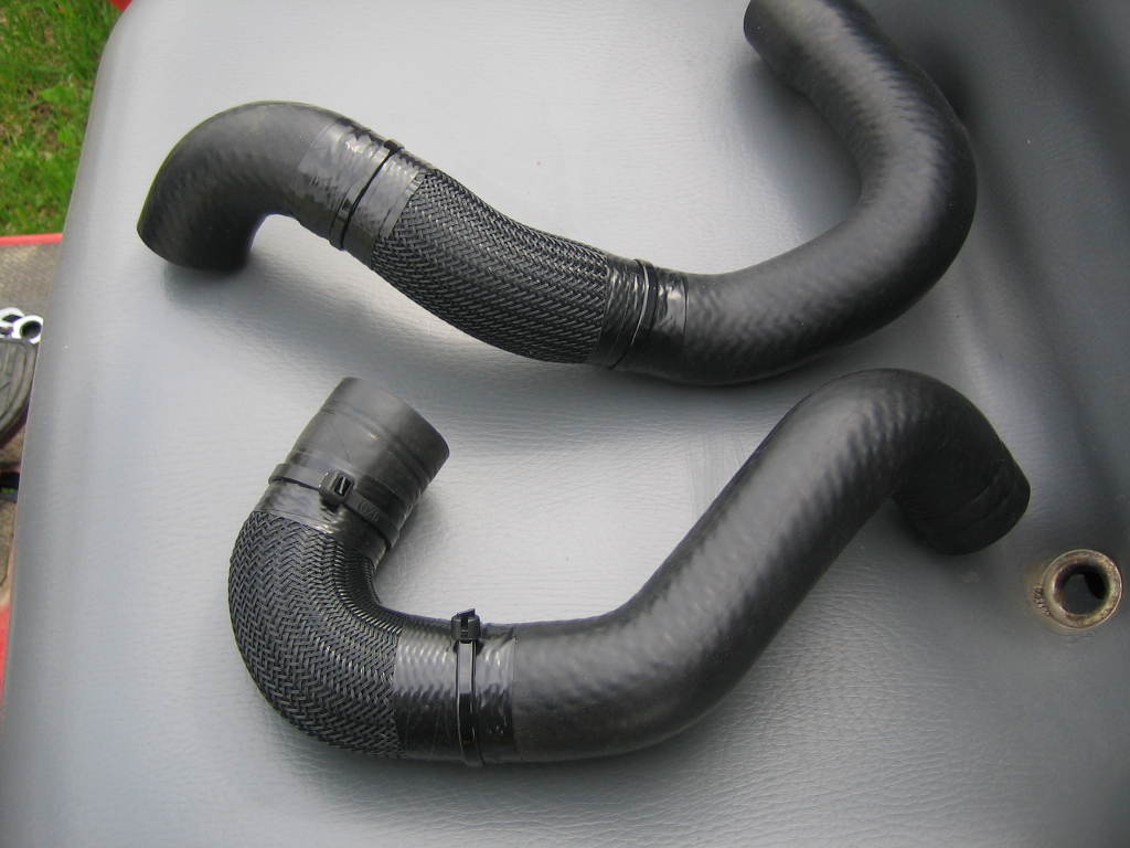

All fixed now, dealer had no problems submitting a warranty claim. Pics of holes/wear on old hoses and my new ones with plastic sleeving added for extra protection. Never want to have it happen again! The way the hoses are clamped on seems to affect the clearances.
