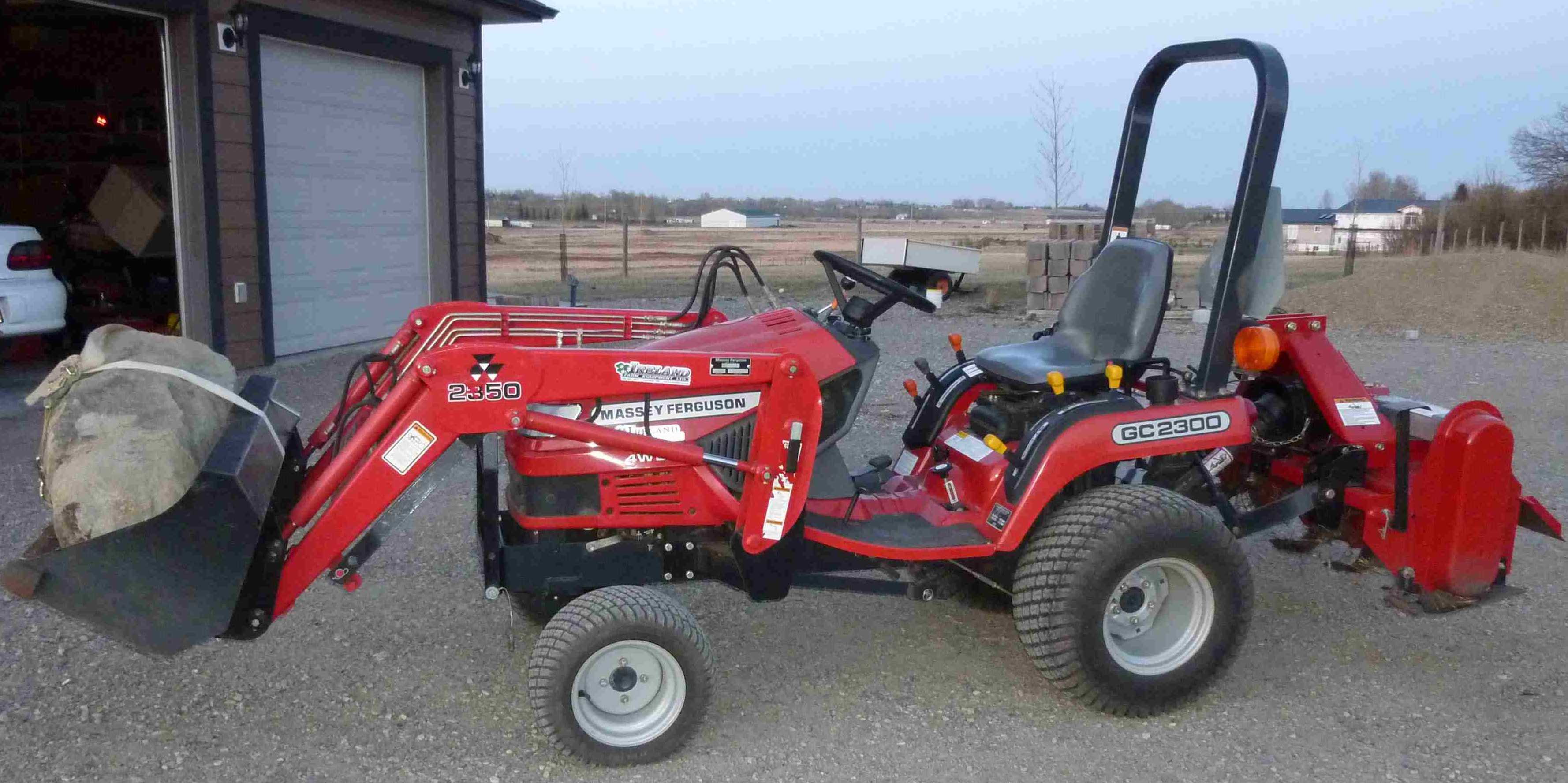

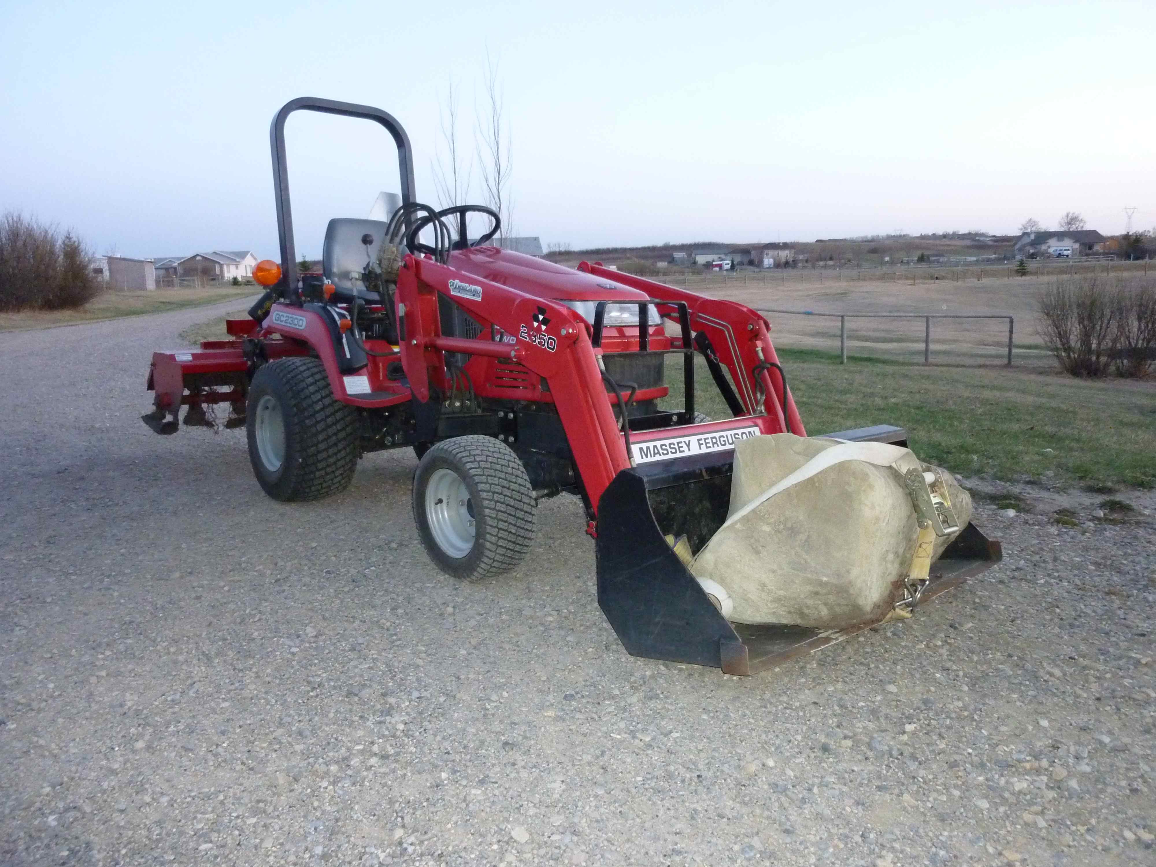

I was impressed with the size of rock the GC2300 was able to pick up. So I took a few picture just in case anyone else wonders.
The hydraulics creep quite a bit. Perhaps every minute I had to adjust the tilt on the bucket, and every 3 or 4 minutes, had to lift the arms again. Is that normal for this tractor (I'm new to it). Same for 3 pth. Or did I buy a tractor that has more than typical wear on it? Around 380 hours on it.

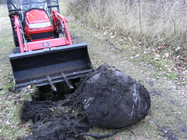

Nice Rock! Heck, she can handle a bigger one that that. This one was a bit of a struggle with all that weight out front.

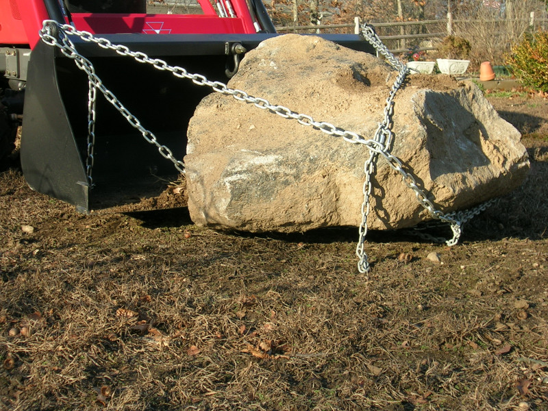

I've used mine for digging rocks started last fall digging the rocks and have most of them done now only problem's I've had so far is blew 2 hydralic lines so far,the lines aren't that good there only rated for 3000psi should have 5000psi lines on them.Larry

Yes, and it is not uncommon.
Pushing your luck doing this kind of stuff, you will likely increase the amount of leakage. :eek:

The heavier the weight and the hotter the oil the faster the creep. It's normal.
