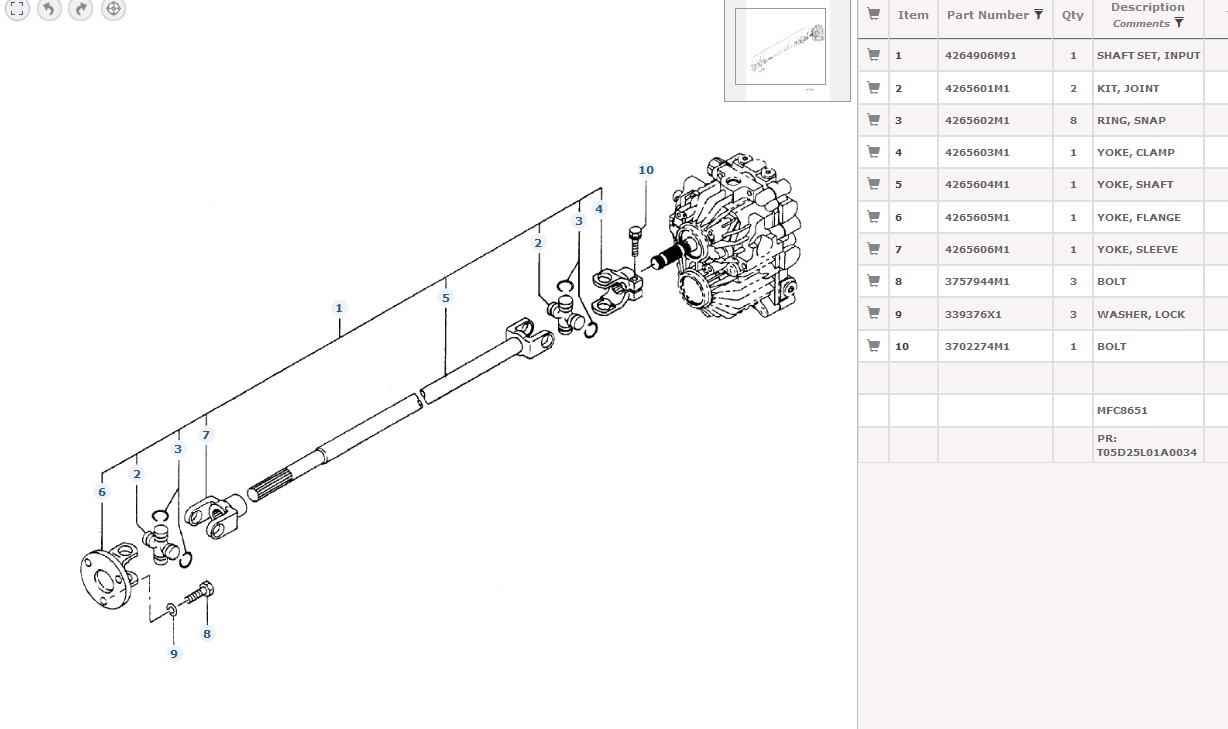

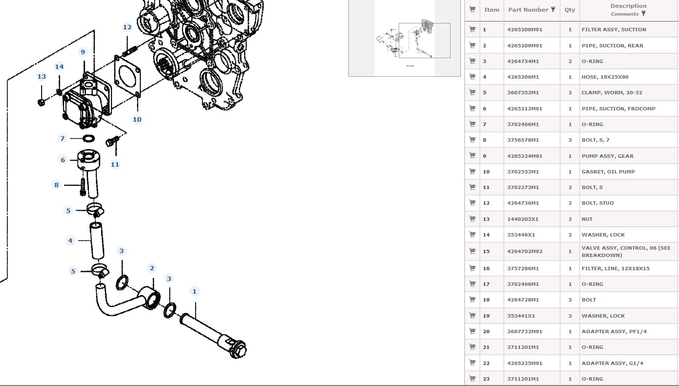

i have no hydraulics.. 6 years ago i replaced spur gear and pump.. now no hyds again i took apart and see nothing?? anything i can look for?
   / gc2300 #2
OK, a few questions.
If it is complete loss of all hydraulics, movement and FEL/3pt, check driveshaft connection to HST.

4. Condition of gear teeth inside HST (assuming spur gear and pump are ok)
5.Suction filter clean?
6.Any leaks or collapsed hoses between the suction filter and pump?
7. FEL?

hyd level ok lost hydraulics first then hydrostatic after, was using it when it went, gears look ok, suction filter good shape, no collapse hoses, when I pulled gear cover off a ball bearing fell out?? all bearings look good? pump looks ok spur gear looks ok?
   / gc2300 #4
Most likely internal failure in the pump. From what I've read, the valve assembly on top prioritizes flow to the hydro 1st, steering 2nd, then FEL/3pt last. If the pump begins to lose pressure, the FEL/3pt operation will be affected first. No idea what the ball bearing is from, but every pump failure/removal I've read mentions it falling out.

   / gc2300
found were ball goes ...on right side 4wd lever has out side access port take nut out and spring behind it were ball goes..
also found hydraulic problem ... hydraostatic shaft spline gone .. main drive shaft connects to it then on back side to transmission
spline shaft hangs out spline is wore and spur gear wore going take apart this weekend
