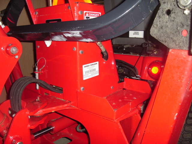

Most likely your backhoe is a model 2375. (Isn't it writ large right on the side of it?) There were some minor changes over the model's production run, but stating the year should take care of that. On mine, the model & serial number tag is on the backhoe "control tower," low and on the right side (of the tractor).
In all my books, I can't find specific parts for the backhoe, but I do show a listing in the specifications section that the swing arm's single hydraulic cyclinder is 64mm x 225mm, or 2.50" x 8.87". (Book says "425mm" for the length, but that's obviously wrong....)
Mine's a 2007 version. Hope this helps.
