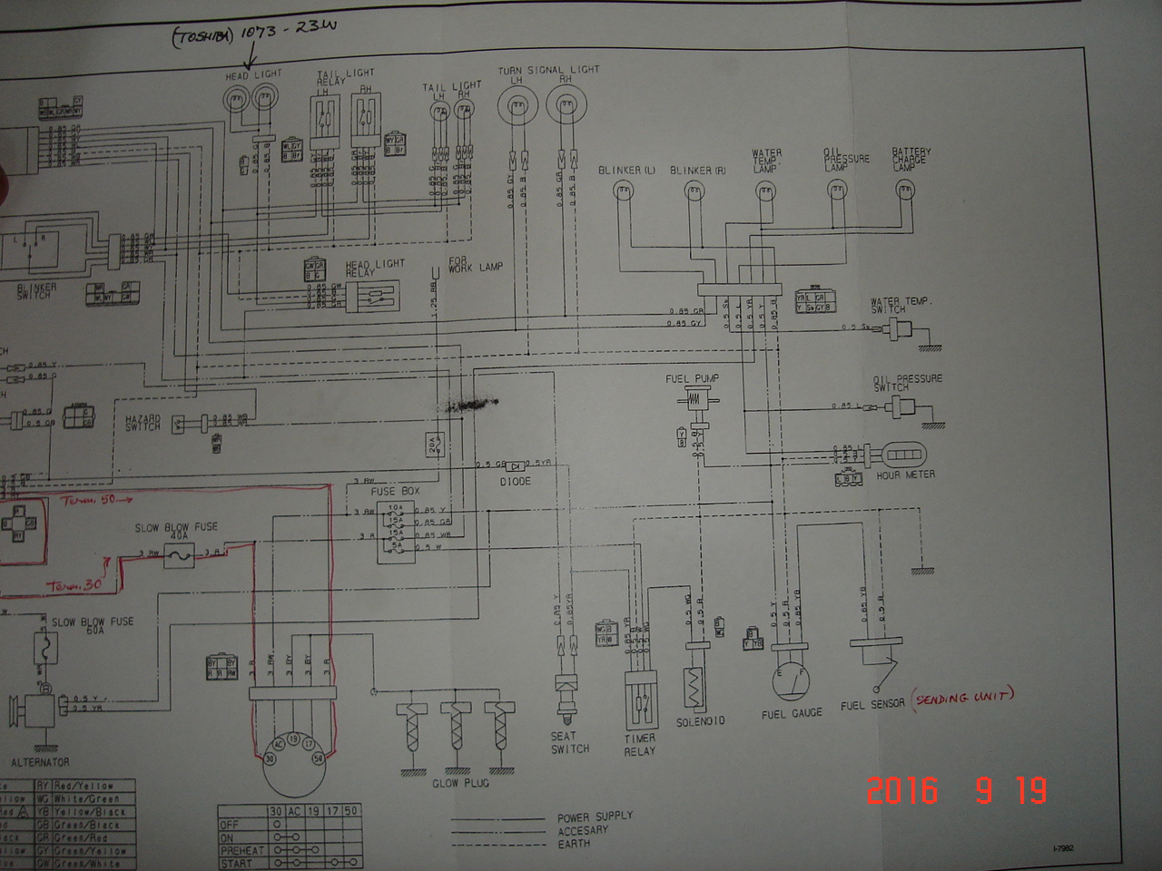

My fuel cutoff stopped working the other day. It happened after I pulled some relays, fuses, etc ... I also shorted across the 3a diode trying to start the thing, which worked, but turns out the only issue is that it was in gear (duh) which wouldn't flip the safety relay.
Anyway, I'd like to have a wiring diagram to figure this out. I see one at the link below, but it's cutoff to the right where I need it. Can someone snap a pic and post please? Thanks!

Does this help?
   / GC2310 wiring diagram?
Turned out to be a bad contact at fuse due to corrosion in the fuse box. Thanks!
