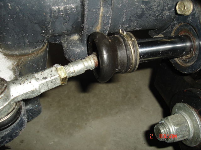

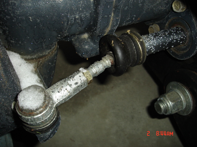

I don't know what these parts are called but I will try to describe what the problem is. Went out today and ended up hitting a tree stump on the front right hand side. OK so there is a hydraulic shaft then there is a rubber boot which covers a ball inside a cup and then this goes to the tie rods which have a bolt and then this gets bolted to where the tires are bolted on. The hydraulic steering cylinder under the front end is supported and held in place with these two metal brackets. One was all bent so I heated it up and flattened it all up. It is good now. When I first looked at it the whole hydraulic cylinder was out of the two support brackets. Then I went on to see what other damage there was and found the following. The threaded piece that comes out of both ends on the hydraulic cylinder is bent however only on the right side. No problem I thought. I took the rubber boot that covers it up and thought I would just unscrew it from the cylinder. How do I do this. If I use a pipe wrench to hold the hydraulic shaft while I turn the unit I will damage the shaft. Also the part that is covered with the rubber boot has sort of a ball inside a cup this cup is somehow attached to the cylinder, how do I get this off. I need to remove it because the threaded part that the tie rods bolt on is bent. I have tried everything to no avail. Really frustrating. The cup that holds the ball seems to have two flat crimped areas to allow a box wrench to grab onto but how do you turn the hydraulic shat out of there??

Paul, it sounds like you're talking about the tie rod end, which has a jam nut on the outside (toward the wheel), then there's that piece with the ball joint and rubber boot that screws into the end of the hydraulic ram. Others have had to make repairs on this stuff, but I've been lucky so far, so have no experience with it.
Here are some pics that may help you to describe what's "broken." I might add that it appears that ball joint may be a "sealed" unit, in which case you may have to cut away the rubber boot on that ball joint to be able to grab hold of it and unscrew it from the end of the hydraulic cylinder --while holding that with a wrench on those flat spots. (And then plan to replace it.) I could be wrong here, however.

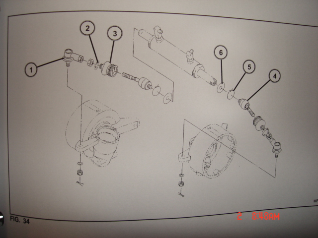

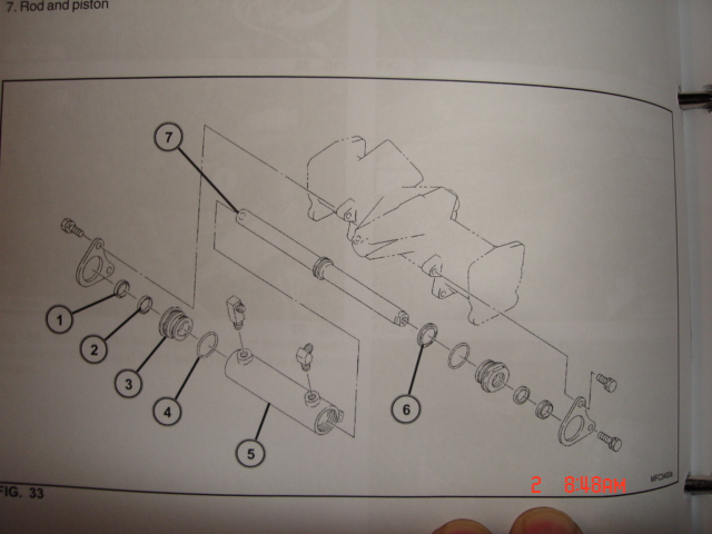

Also included below area couple of shots from the service manual covering that business. Hope this helps; you might also do a search on this forum, as I recall seeing some threads on repairs to the steering on these GCs. I know several folks have had those clamps that hold the hydraulic cylinder in place slip or get damaged.
Here are the part names from the service manual, from the pic that shows the outer section (fig. 34):
1. Rod end
2. Boot spring
3. Boot
4. Knuckle
5. Clamp
6. Washer
Walt

If you look at the other end of the cylinder shaft you'll see that it has a spot where you can put a wrench on to hold it from spinning.This is only on one side of the cylinders shaft.I believe that you have to pull the boot back in order to see the flat spots[were you put your wrench] Larry

If you look at 'irvingj"s first diagram(the one with 6 parts numbered.
Part 1 is the 'outer tie rod end'. Remove the cotter pin and nut from the underside, the hit the cast iron part that it goes thru with a big hammer several times. That should free it up so it pops out. But loosen the jam nut that is just to the left of number 2 first to make life easier. When you remove the rod end from the shaft, count the turns, and reinstall with the same amount of turns, as this is the 'toe-in' for the wheels.
Slide rubber boot 3 down the shaft and you will see the spots for your wrenches(that is the 'inner tie rod'). As Larry said.

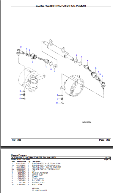

Digital pages of parts diagrams are also available here:
http://www.tractorbynet.com/forums/...g/354655-free-access-serial-number-check.html
See attached pdf I got from the website. ...oops. can't attach a file. I'll attach a screenshot of the picture, but just as a demo. You'd like it a lot better if you get your own original pdf.
I notice also that the part numbers in the parts diagram I'm posting are different than the ones previously posted. IrvinJ shows the knuckle as "4". The pdf I just downloaded shows the knuckle as "1". Not sure why. The Agco downloads also gives a map to MF part numbers to order.
4265171M91 Rod End up to S/N S1500
6253678M91 Rod End from S/N S1500
Would that be serial number JSA1500? Hmm...
I see the end of the hydraulic piston has a flat to grab. Does the outer shell of the knuckle also have a flat to grab?
~EH

Those numbers have all been superseded by 6253678M91 it come as a whole assembly now. Tie rod and Ball joint together. Try Jacks Small engine, you can put in the part numbers and it tells you what you need to use.
