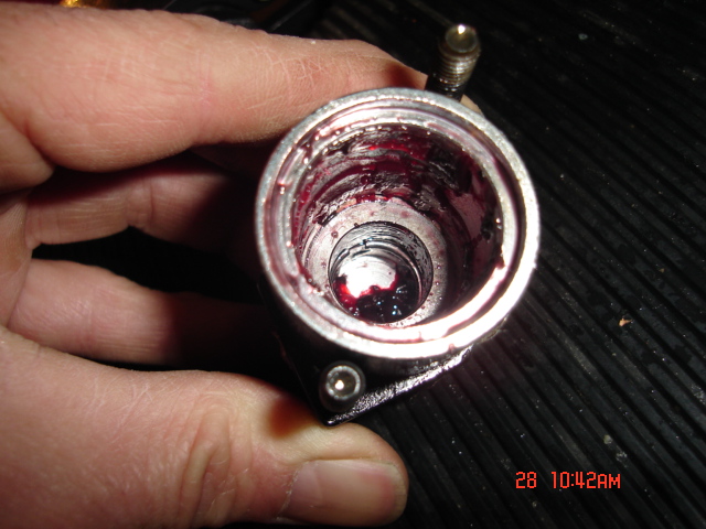

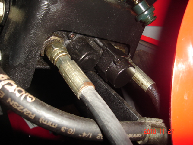

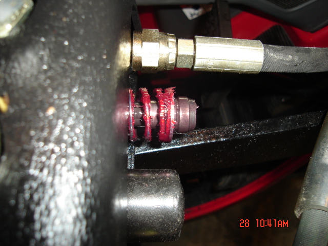

If the control valve is the same on the GC 2300 here's what you need to do_On the back side of the valve body remove the 2 screws that hold the detent end cap on.I believe its the one further away from the tractor,It'll be the longer cap.Check to see if you have any dirt rust etc: inside the cap.Once you have the cap off take it apart it comes apart fairly easy.Clean everything up thats in the cap.There's a small cir clip/spring clip what ever you want to call it.This is usually what the problem is.If you take a pair of pliers and squeze the clip together just a bit it'll solve your problem of the joystick popping out of float.Its a very simple fix.Larry

jeremyfxdwg-- here's some pics of the innards of the detent mechanism.
